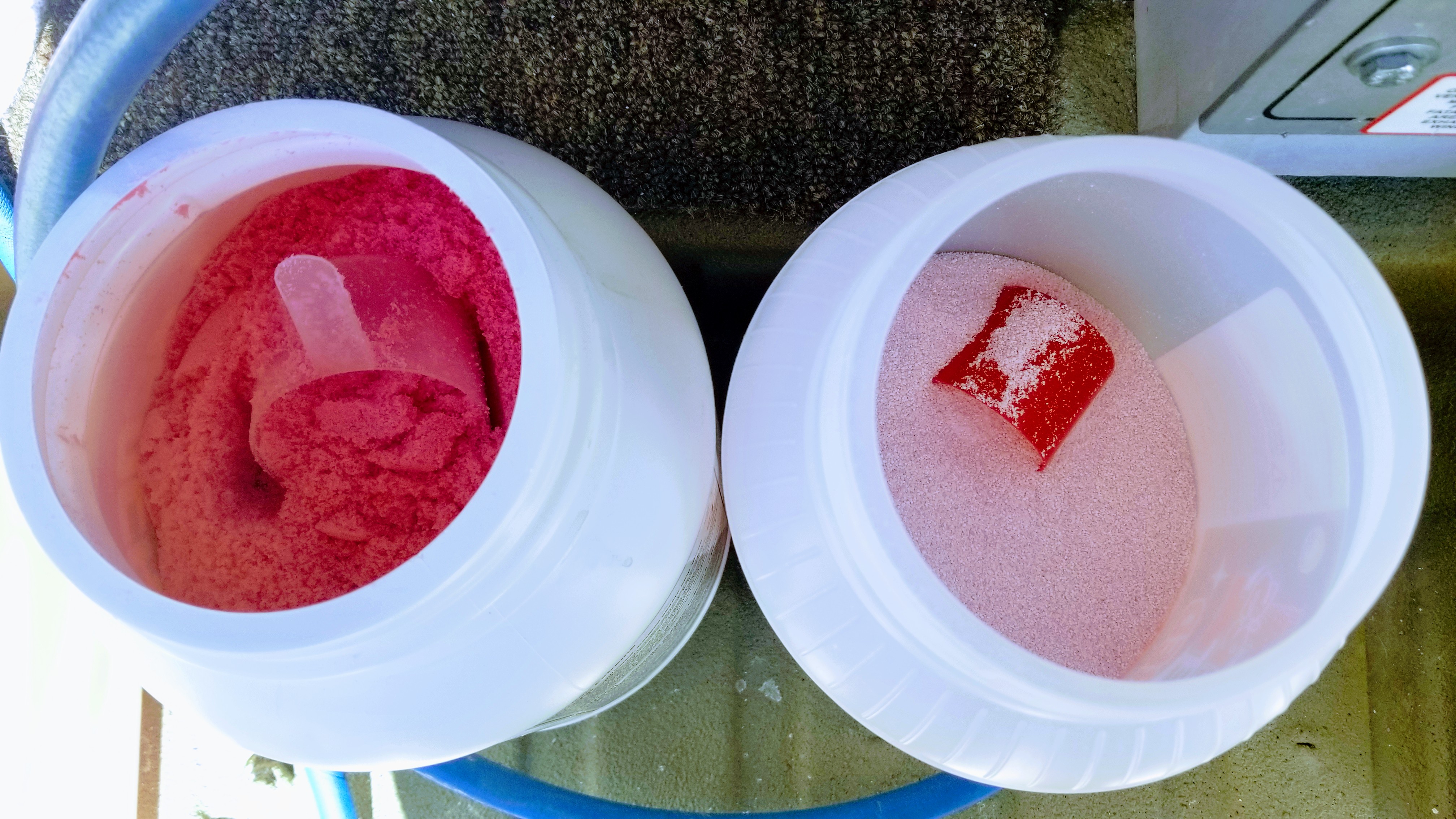

Ok. I didn’t want to go into detail on this because I’m lazy. But here is what I think happened. The day I had trouble mixing the UPE i mixed it with cold water. I thought my exchanger water was warmer than it was. There was also some water in the bucket when I added the powder. I was then distracted by a chipmunk and walked away for a min. During this time I believe the cotton candy setteled to the bottom and sort of solidified. When i added more water it really didn’t mix because it had solidified.
Now I make sure my water is hot and it has mixed fine since. There is no issue with me using a 7qt HF with an 8:1 tip. Once its mixed up it seems to stay mixed pretty good.

WTF are you talking about? The scooper is 3 oz's, my HF puts out 12 gal RTU. Prochem needs to make the instructions with ounces, not scoops. I'm not going to stand there and count 12 scoops. It's faster and more accurate to use a measuring cup. I measured the scoop to be about 3 oz's. I'm not discussing this anymore.
Don't answer me because I won't respond. It's too early to deal with this crap. I need some coffee!
5 Quarts container uses 8 scoops.
8 scoops/5 quarts= 1.6scoop per quart
7quarts x1.6 scoop per quart =11.2 scoops
11.2scoops x 3 oz per scoop = 33.6oz per 7 quarts
on 8:1 on 7quart container is about 14 gallons rtu which
Since ya measuring in rtu, its 2.4 oz per gallons.
In your case it should be 14 gallon rtu which makes 33.6 oz or 11.2 scoops..
If ya really setting it up to make 12gallon of rtu, you're losing money. As you only need 28.8 oz or about 9-10 scoops..
