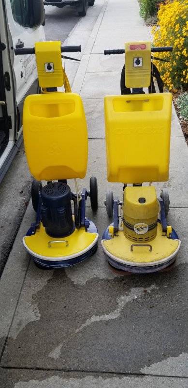

Taking turns between the two was a real eye opener..
The old unit has a very stuff on off switch, the wheels don't roll freely, the head spins loudly, it's smaller wheels make it less agile and that 10? guage tacky cord is a pita too..
But it still does the job.

The machine with the big wheels are so much easier to clean with. We have 4 of each, and the big wheels go out first. I fought them for year but after using the big wheels I can see how much harder you work pushing those machines around.

The Big Boy wheels make a world of difference! I thought everyone was running 'em by now. :confusedd:
The Big Boy upgrade replaces the zinc axle too. The OEM zinc axle will eventually corrode to the tee piece. When that happens the adjusting rod will eventually snap. The stainless axle fixes that. Plus the larger wheels (with bearings) are oh so much nicer to roll around. Turns that bulldozer into a Porsche.

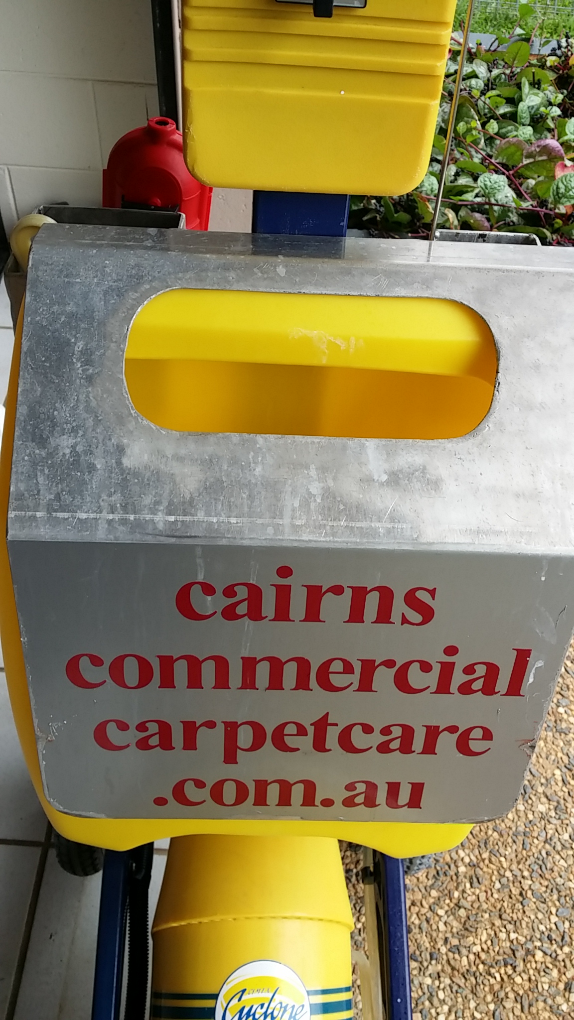

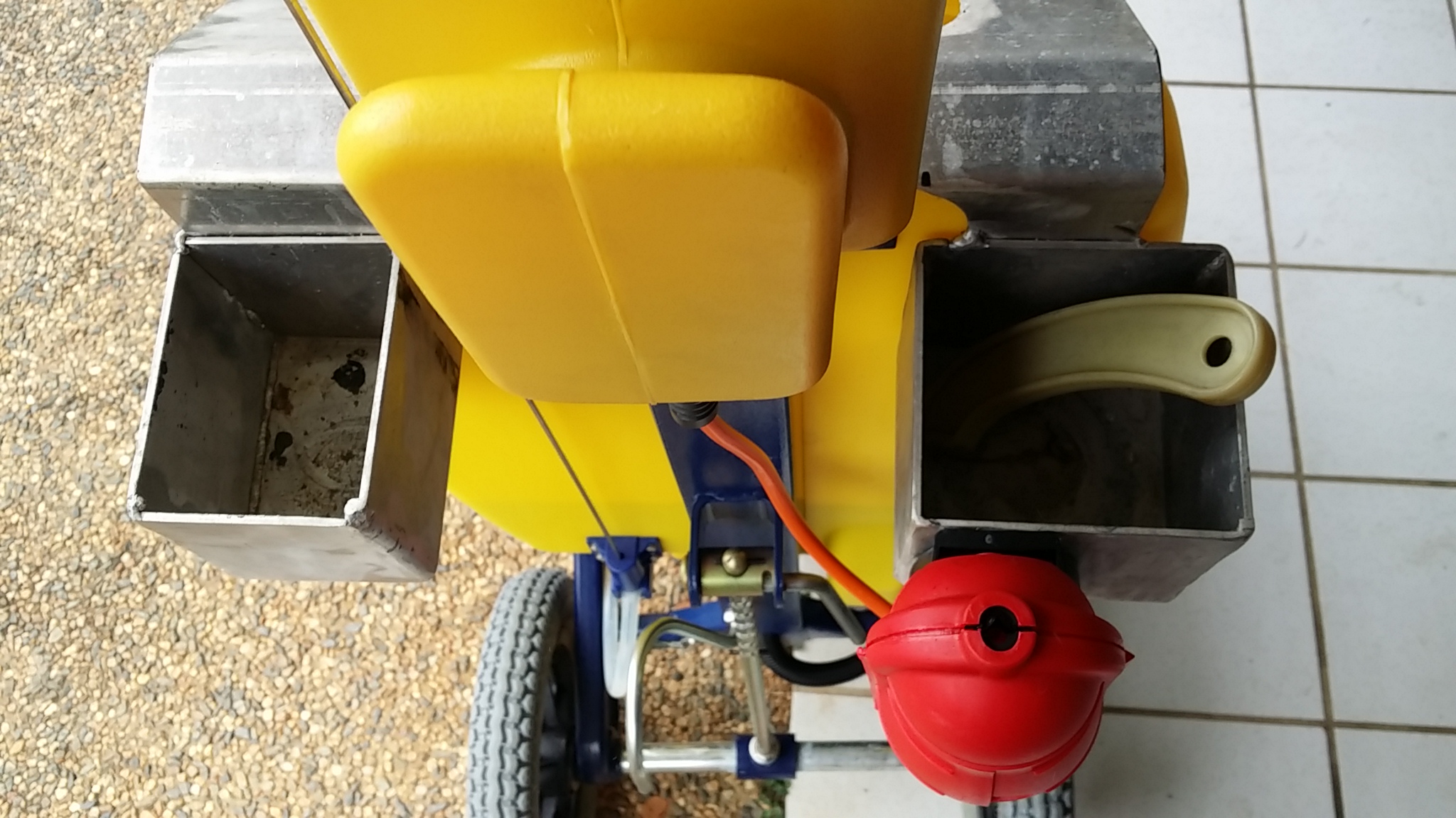

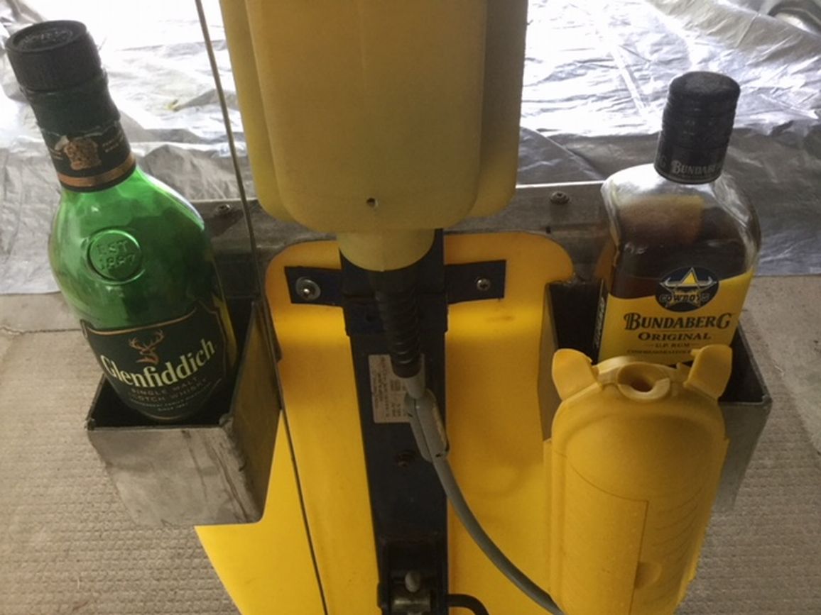

I have made a few modifications to my Cimex's.
Started with the Big Wheels, then I chopped the 50' cable and only use leads the length that I need.
Like, working on lift lobbies when a 15' lead is sufficient, I don't have 50' of cable on the floor.
I then added an aluminum plate to the front, which is one piece, & goes over the back to where I have to spotting bottle holders + the joiner box for the extension leads.
Working in the tropics, one must always be aware of dehydration, this is where the spotter holders are essential. :winky:
