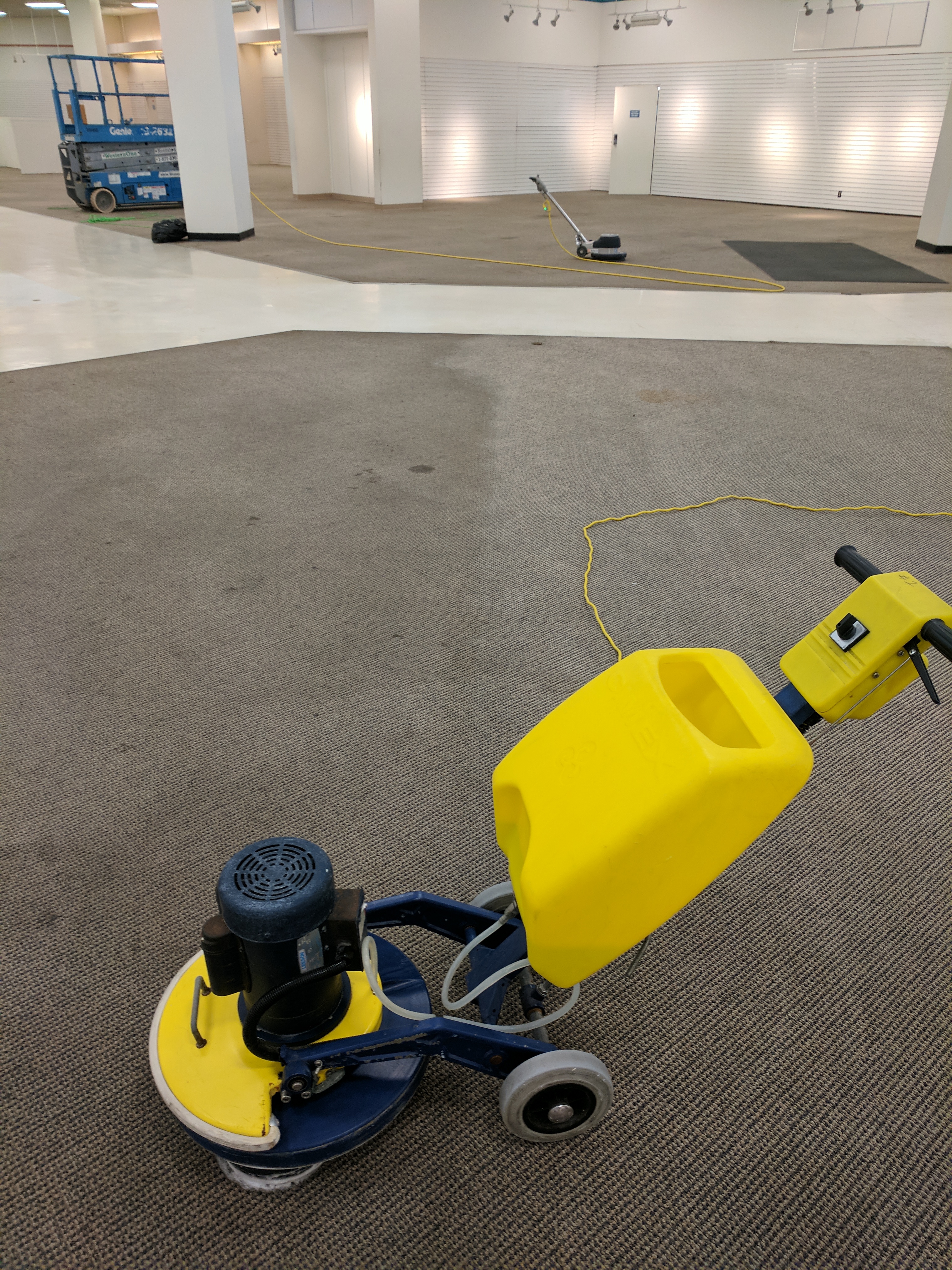

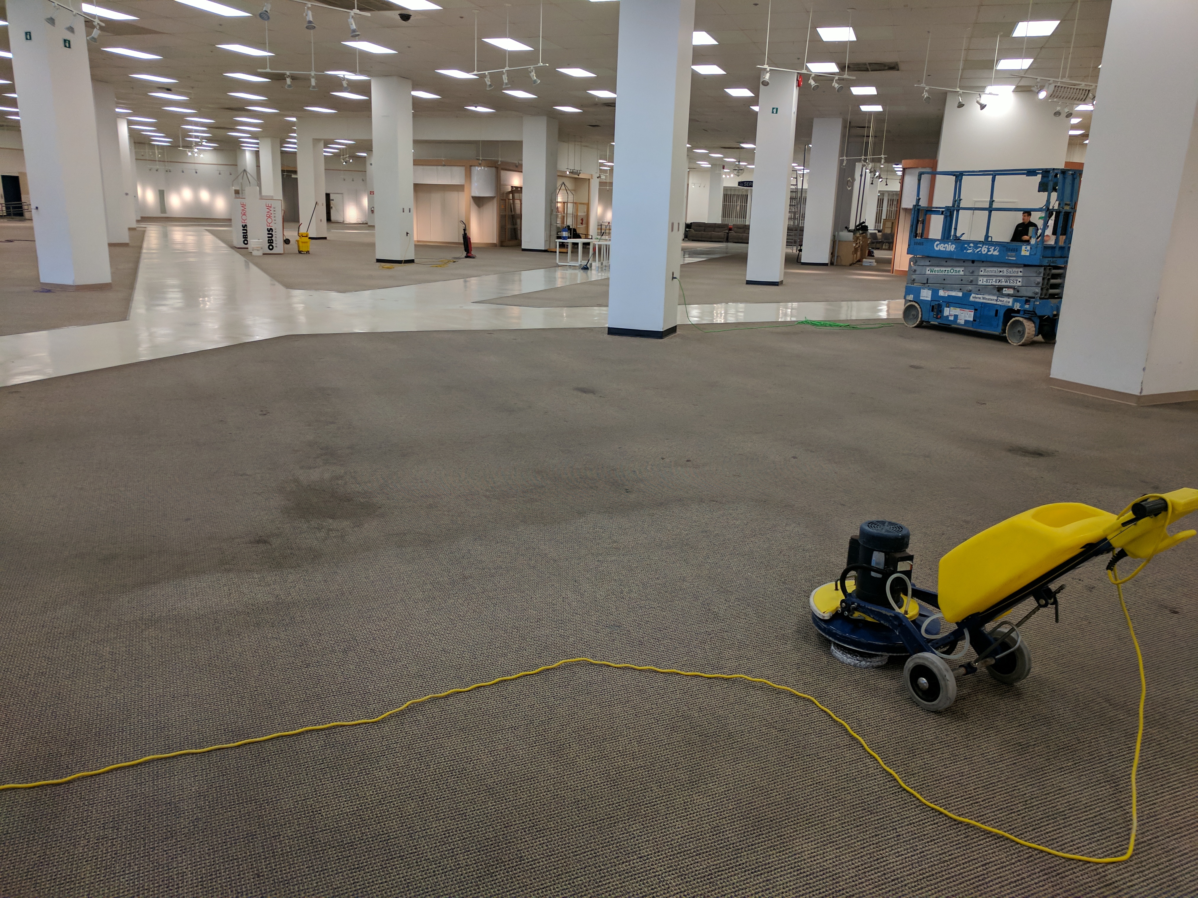

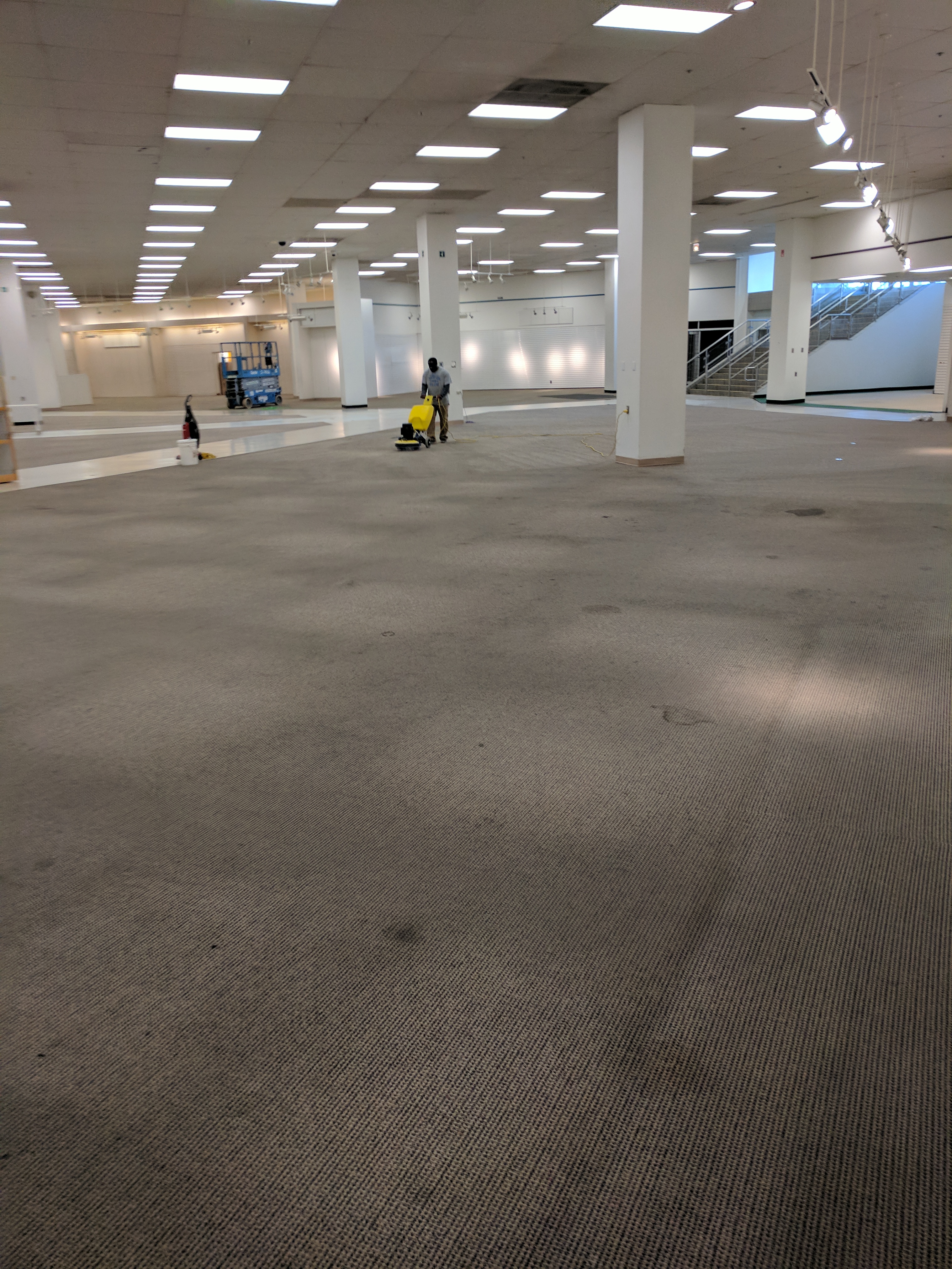

Well, done for today. They added about an extra 10, 000 sqft that they were going to replace bit decided to have cleaned as well. Probably cleaned about 18,000 sqft today. Slow going because of the heavy soiling. Also spent a lot of time vacuuming. Finally got some of their staff doing that. Used up 6 gallons of concentrate at about 10-1 dilution. 60 Gallons if mixed solution. So much different from hwe. You have to trust that your detergent is doing what it is supposed to do. Doesn't always look all that great right away but changes as it dries. Overall, most is looking good. Will touch up some of the worst areas as we go. My helper was great but tomorrow I have the legendary Willy P working with me. Should be a blast. I am finding the sprayborg is easier to operate than the Cimex and gets as good results. I would consider getting a vibe because of the built in 5 gallon tank. Here are a few pics of the store and the overall conditions. Maybe I'll shoot some video of Willy tomorrow.

Looking good.
Before you ditch the Cimex, install Big Wheels on it.
It makes maneuverability so much easier you won't believe the difference.
DON'T leave the Cimex with the pads on the carpet like that, they will leave a mark from the solution awkward to get out.
Lift the head & place a towel underneath to catch the drips.

I don't think I would ditch the Cimex but the big wheels would be great. The Cimex with aggressive pads really gets in there. I can really see the attraction of the vibe with the large tank. I have 6 2 1/2 gallon jugs that I space out for the sprayborg and 2 5 gallon jugs for the Cimex. You can really get a lot done before you have to refill them. A 3rd person would be invaluable on a job this size.
