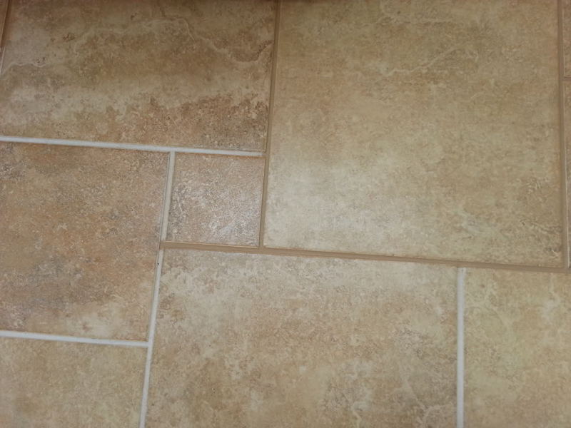

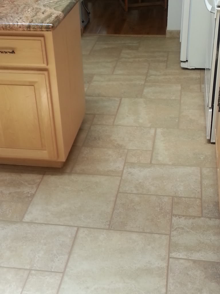

I have a color seal on for tomorrow with a pretty drastic color change..ugh..
Wish me luck.
And a one handed helper..ugh.ugh.

light to dark (summer wheat)
