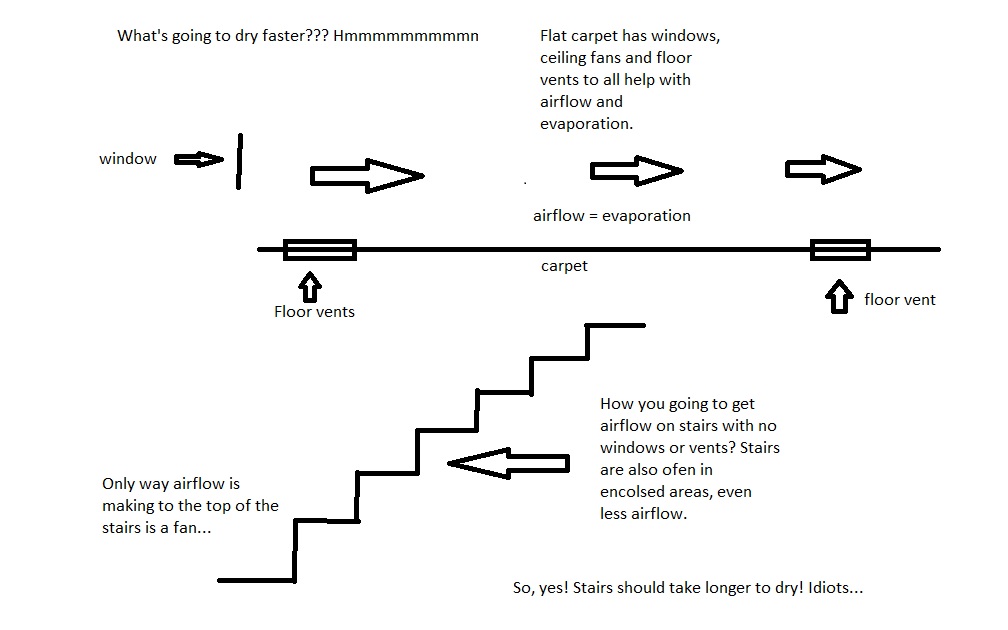

Ugggggg, the point of the post was a funny story about knuckleheads thinking carpet will dry faster with towels on it...
It's been ten years, I'm fairly confident in our cleaning techniques.:oldrolleyes:
Stairs are generally the last thing we/I do in the home as I work my way out... Because of this, they will always be the last to dry... Stairs are also the most dangerous for clients - I want them to put a fan on them.
That being said, I do believe that stairs will take longer to dry than a flat surface.
How many stair wells have ceiling fans or windows? If they(stairs) did have a window - as soon as the air hits the riser it will slow down dramatically.
Again, this is my opinion - simply seems logical to me.

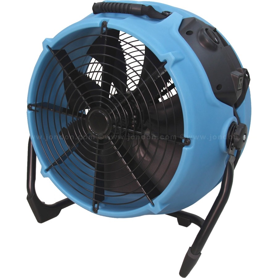

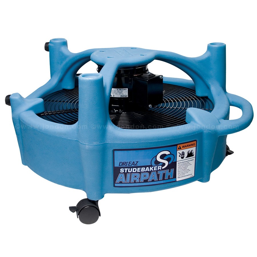

Well I could only afford 1 stealth and two Studebaker. I used my Legend reward points. I’m just a sad cleaner.
