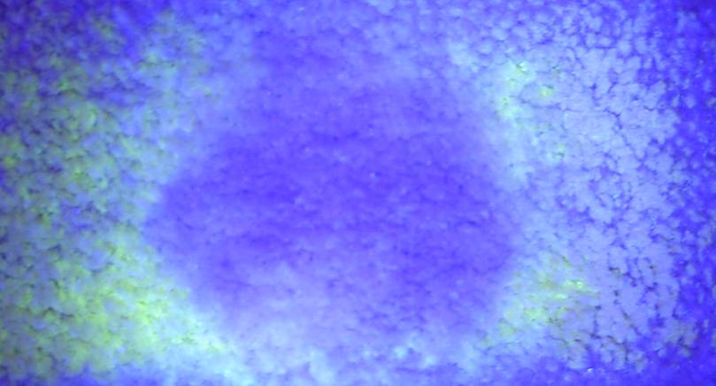

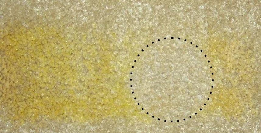

It still would take an Oxidizer + strong UV light to make Urine Fluorescence disappear:

So are you saying that peroxide and UV light removed this fluoresence? Or it removed it with the help of a UV absorber? If the UV absorber removed 50%, then would doubling the amount of UV absorber remove it all in your test? Did you try the peroxide and UV light alone?

The photos were of Peroxide & strong UV light only.
Five minute exposure.
