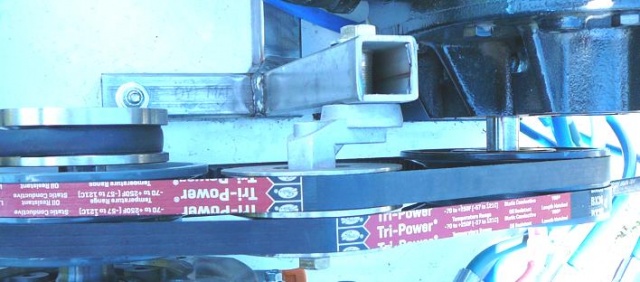

the concentrics are not a tensioner per se......better
they keep the belts tight lik they should be.....PLUS you can change the belts in about three minutes.....
Gene...ever try a Gates green belt....they're the best
Yes I love the green gates matched belts.

I'm not a manufacturer...
but i DID stay at a Holiday Inn one time.....
THIS is the proper way to tighten yor belts...
a BRACKET with two concentrics.....
i've got templates for most 45's and 47's
i believe this is Chris' machine
That is Awesome!
Yes this is my machine and lemme tell ya
It is sweet to be able to tighten the belts. I run the covers for posterity, still takes me about 2 min to tighten either or both belts, routine maint thats a habit now.

Yea he had it all re-done at the local distributor. Re mounted on a plate with slide holes for adjustment. But I thought they had said it wasn't necessary they had a solution. ???

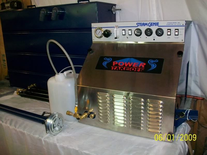

This post got me to thinkin'........
i got a CNC water jet crew ready and all set up to cut everything including the instrument panel.......learning at MF how to install into a new chev van is a snap.......i SHOULD make one more!
Hell i sold nine right under Mikeys nose....
he wouldn't notice one more....would he????
ain't they purty???

Several things to consider:,
1. user error... (No offence Lyon)
Are the proper belts being used? IE. Are the Sheaves designed for the 4x stronger 5vx series, and B style belts are mistakenly being used?
2. Are cheaper belts being used? And I dont mean $$ wise, I mean the quality... if you are using the same brand as always, maybe their quallity has gone out the window (Like what has happend to me many times)
Try matching the belts to the Gates Green "Powerrated" belts (Thanks BAWB), or the "Predator" series, I have had tremendous success with both, in situations were I was burning through belts every month.

I use matching cog belts from an engineering shop that's been around for 100 years, I tried automotive and the green ones don't work, the cog belts are the correct belt, I'll check out Cobbs new set up

The slotted plate is simple and cheap, and is a very common way to tension belts. Every belt-driven machine in our shop uses a slotted plate to adjust belt tension.
A spring-loaded tensioner is a good thing though, if you're willing to spend a little money and have the room, since you can change belts more easily.
If you find it terribly difficult to change belts you might want to try a link belt. If they stretch, take out a link.
http://www.bdhbelt.com/link-v-belts.asp
http://www.fennerdrives.com/powertwist-plus/_/PowerTwist-Plus-B/17/5L/
