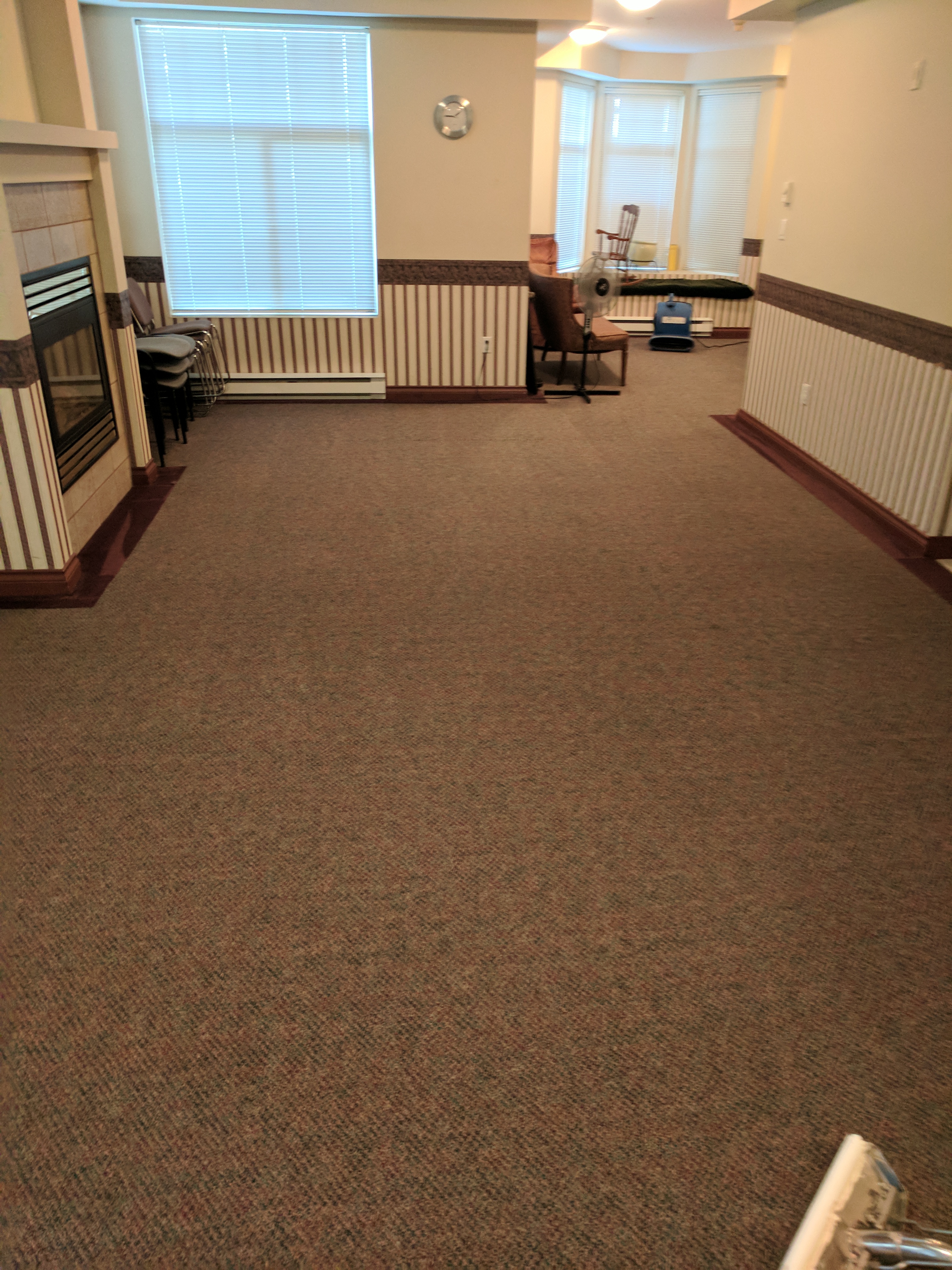

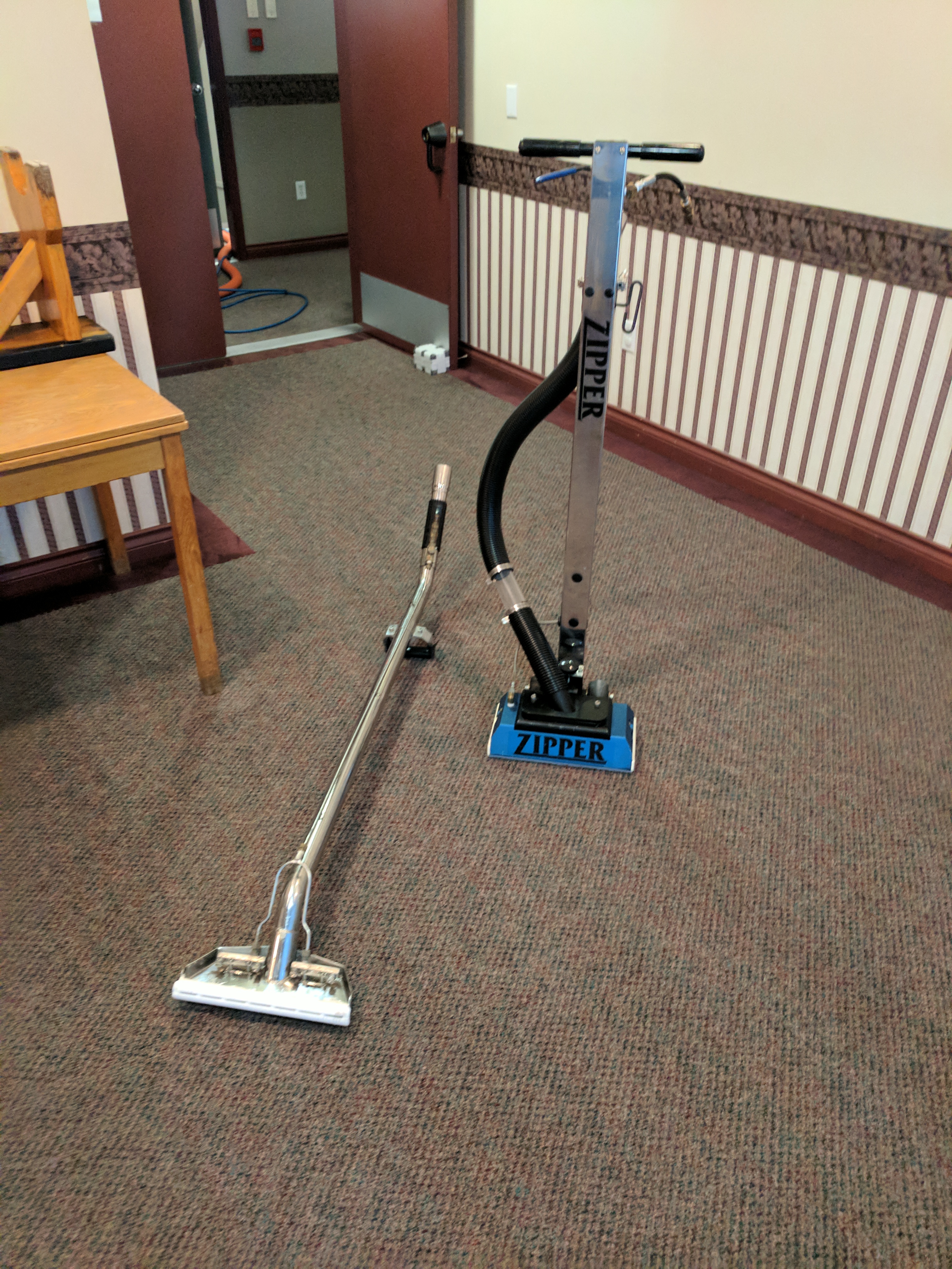

This is the beauty of the Zipper. Just cleaned the amenities room in my building. Although the carpet didn't look soiled, the yoga instructor who rents the room on a regular basis, complained that her socks were always black and the carpet doesn't have a pleasant odor. I used the Zipper and 2 inch wand to trim around the edges. The Zipper allows me to flush and vacuum in both directions, giving me twice the amount of cleaning solution but removing it instantly as well. When done, the carpet feels just slightly damp. (Dry to the touch as some would say) .I left one fan on it and will check with a moisture after supper. I finished at 2pm. I am thinking it will be dry at 6pm. Wouldn't it be nice to have a light weight wand built like a Zipper? Allowing you to flush and recover in both directions?
View attachment 83614 View attachment 83615
I agree that it is important for faster drying to be able to remove the solution immediately, rather than go back over a cleaned section much later with a dry stroke. By the time you do that, the excess moisture has sank into the carpet already.
I would like to see a tool or wand that had a front and rear vacuum slot with jets in between similar to the zipper but with the vacumm slots closer together. That way the solution would be picked up quicker on the forward stroke as well as the backward stroke when cleaning in both directions. It would seem to me that the carpet would be dryer if this were so. I may be splitting hairs here though.
I repositioned the jets on my 360i quad to make sure the solution was picked up immediately. For some reason the Rotovac is shipped with only 2 of the 4 jets positioned this way.

Just checked the carpet with a hydrosensor. Most of the carpet is bone dry with just a couple of damp spots where I worked out some spots. 4 1/2 hour drying time. Temperature 30 degrees Celsius, humidity 39 percent.
