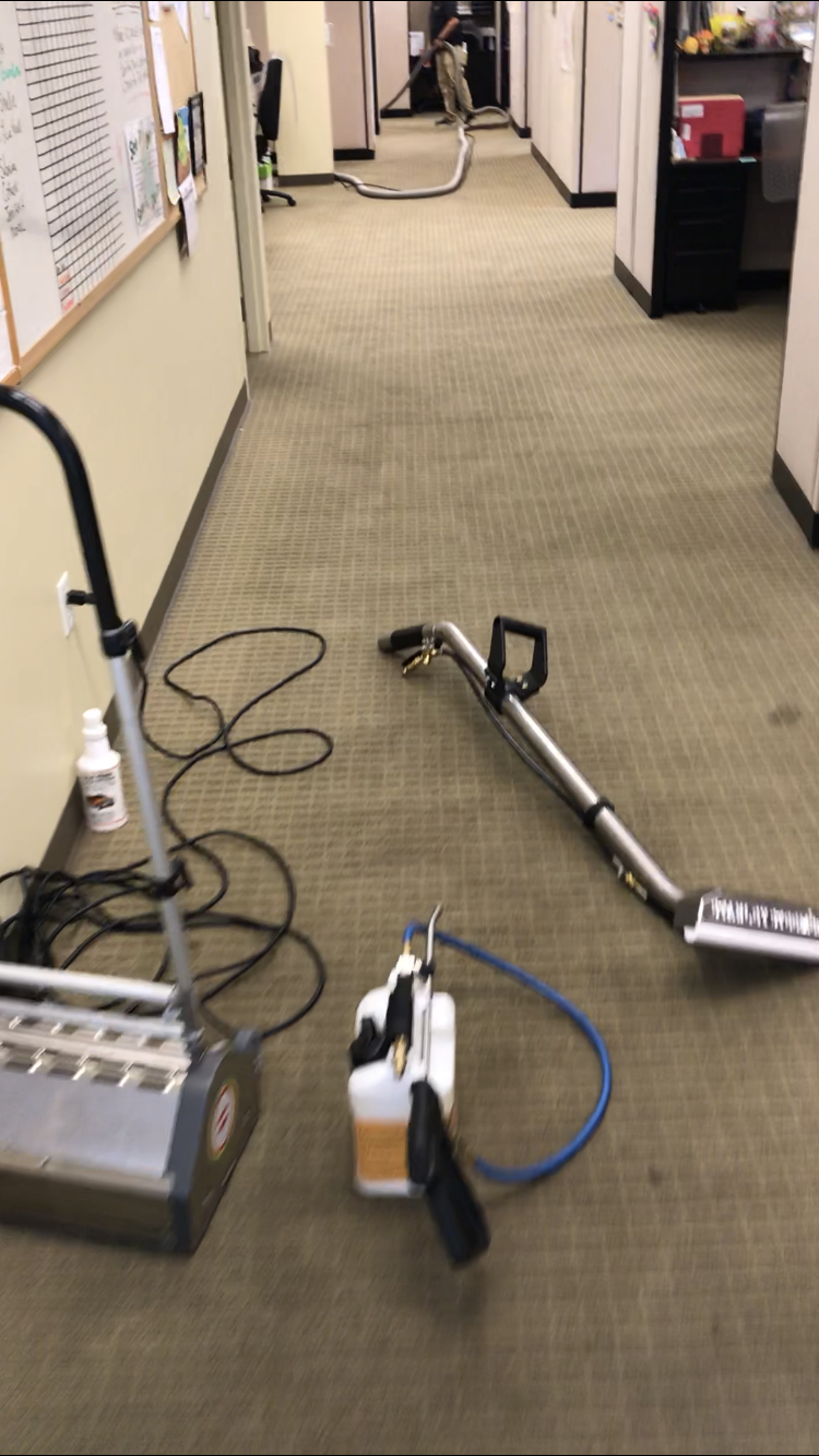

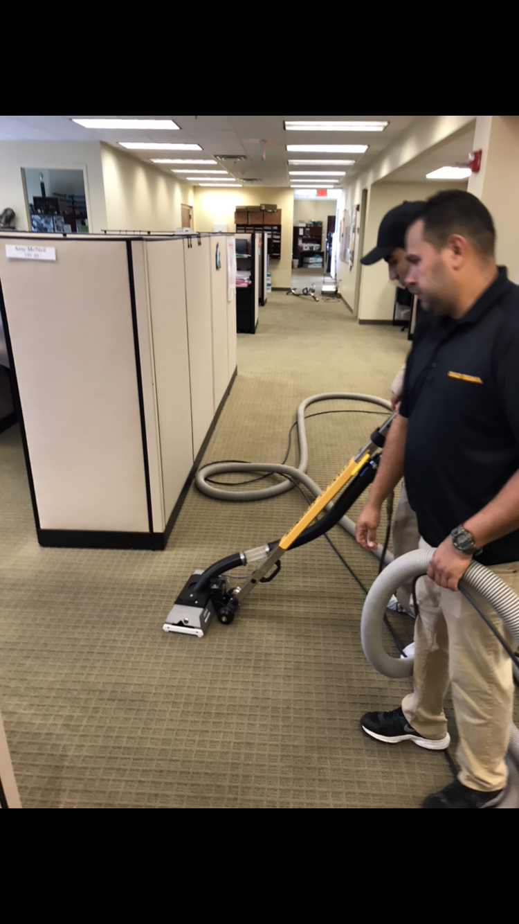

View attachment 78046 View attachment 78047
$2000 commercial job done this past Saturday (16,000 sq.ft at $0.12) that’s was a 3 year old estimate that we honored because we do a lot of work them. Normally $0.15.
2 (2 man crews) pre-sprayed, CRB-ed, Tom Conway’s Dev. Wand around cubicles, Erik’s 15” zipper open areas and halls. Done in 5 hours. I’m ok with $200 an hour. The customer was THRILLED. We clean portions of this place yearly and have never had a better result as easily as this past weekend.future work for them will be priced at $0.15 and they were contemplating protecting since it came out so well.
