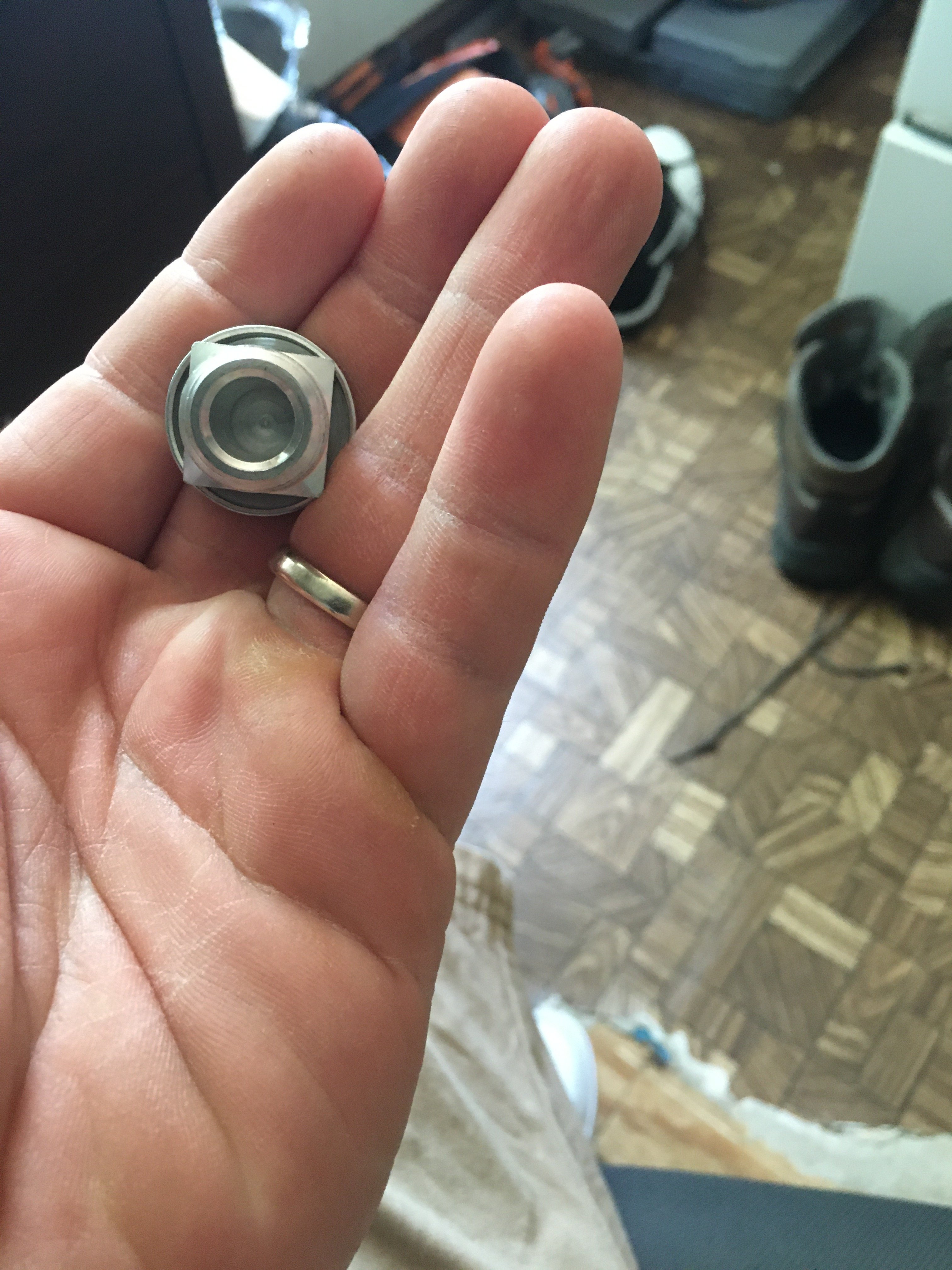

I contacted gardner Denver on getting these brass filters. I can’t find them anywhere
14,126
Real mechanics don't use crescent wrenches. Stuffing a piece of foam in there instead of the original piece doesn't seem very smart. I'm sure you or your repair depot can order the right part.
Hey Douchebag! I'm trying to get the original part to put back in the cap and it's not possible. Both MoronJondon and another Gardner Denver supplier are telling me that they don't supply that part to put in the fill cap. So I told JD to send me the whole cap assembly with it inside. JD wants $100 for each FKIN cap!
Another frustrating fact: Tech"support" at JD told me that I'm the first guy he's ever talked to who is trying to order that breather stone. Then he went on to say it might be my fault with the blower shooting out the oil seal, not the breather stone, even though I couldn't blow through the cap with the stone in in 600hrs ago WTF? Either the dickhead is lying or he's just an idiot that JD put to answer the phone.
I'm in the process of contacting GD directly today to find out WTH it's impossible to get that stone

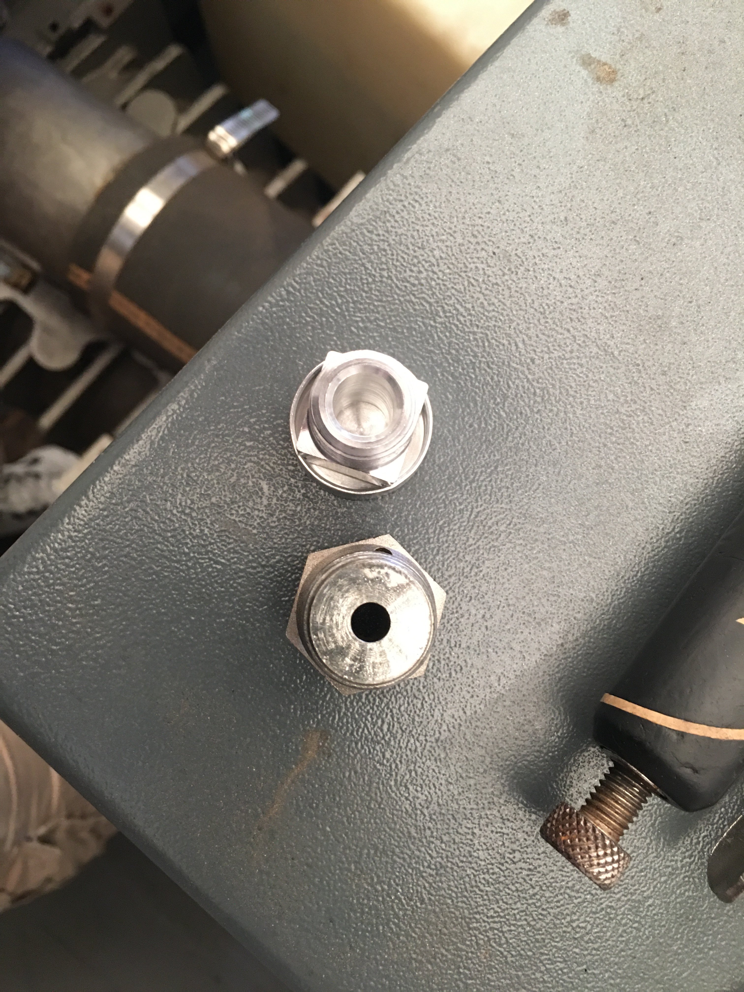

I like to replace with original parts. It seems prochem made the decision to put this type of breather cap on the blower, because my conversation with GD this morning informed me that they put just a hex plug in that hole.
I got in touch with CleanSource in Columbia and they’ve been replacing that overpriced part with a grainger breather cap they’ve been using for over 6 years with no problems. I ordered 2 of them and I’ll show the part number and pic as soon as it gets here.

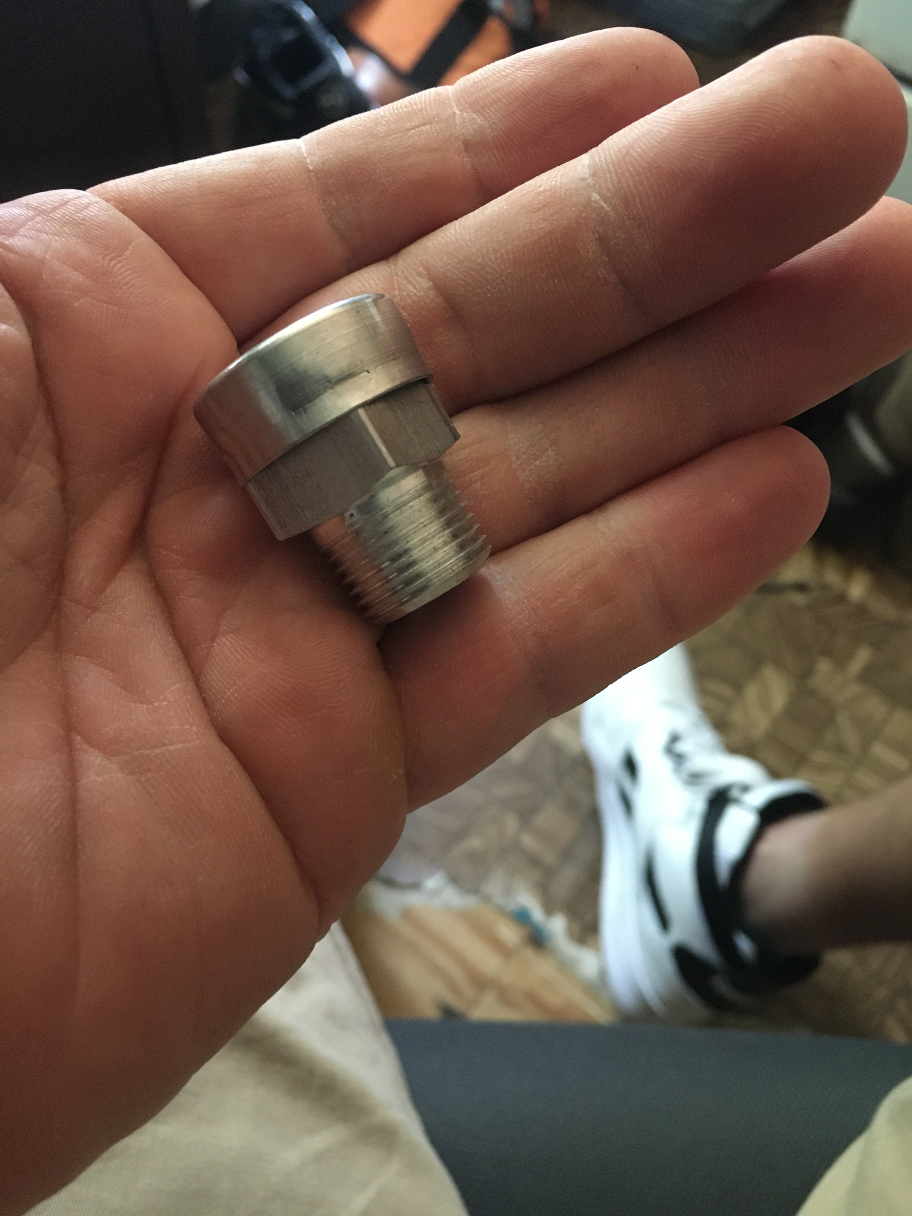

This is what CleanSource in Columbia has been putting on the blowers for 6 years. He told me he’s seen no problems.
A pinhole breathing tube on the one with the stone or a 1/4” breathing hole on this one helping the heat escape makes more sense.

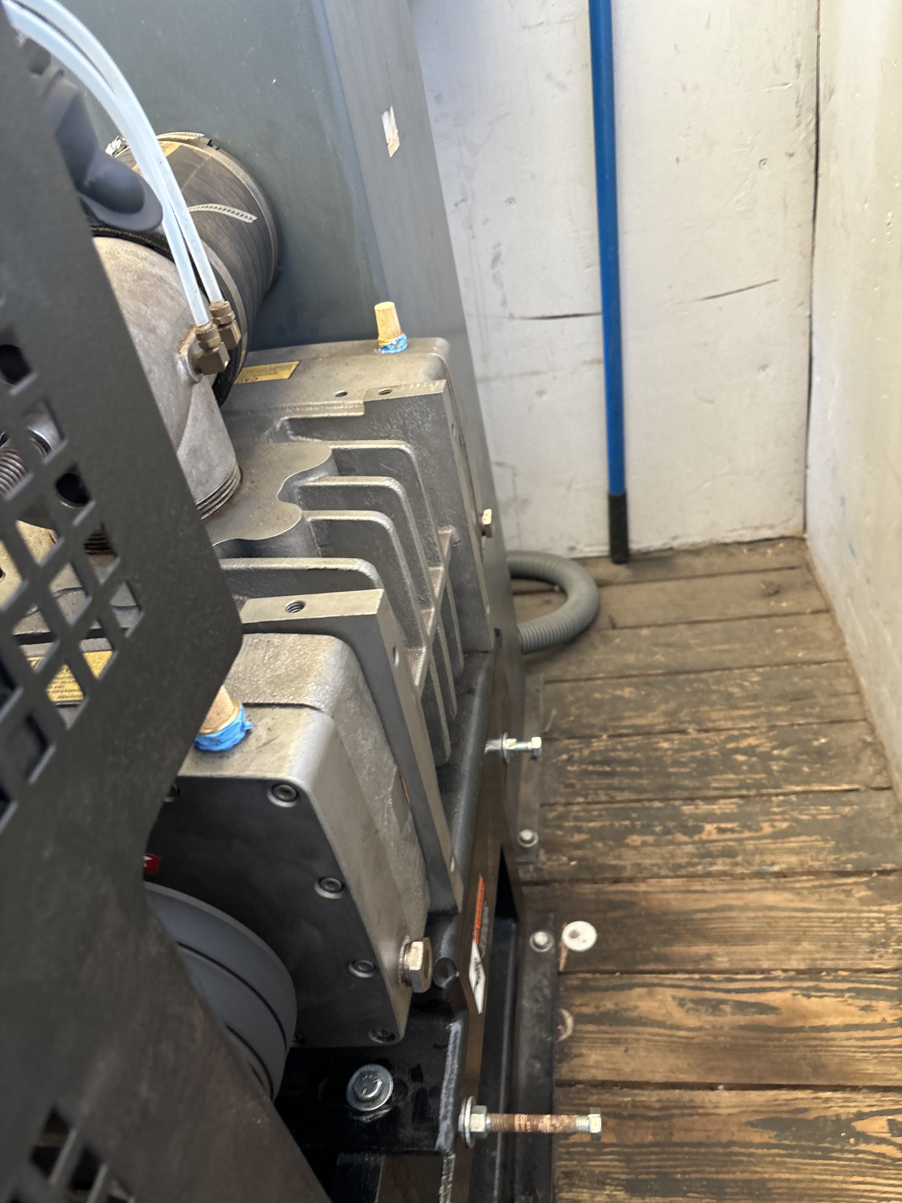

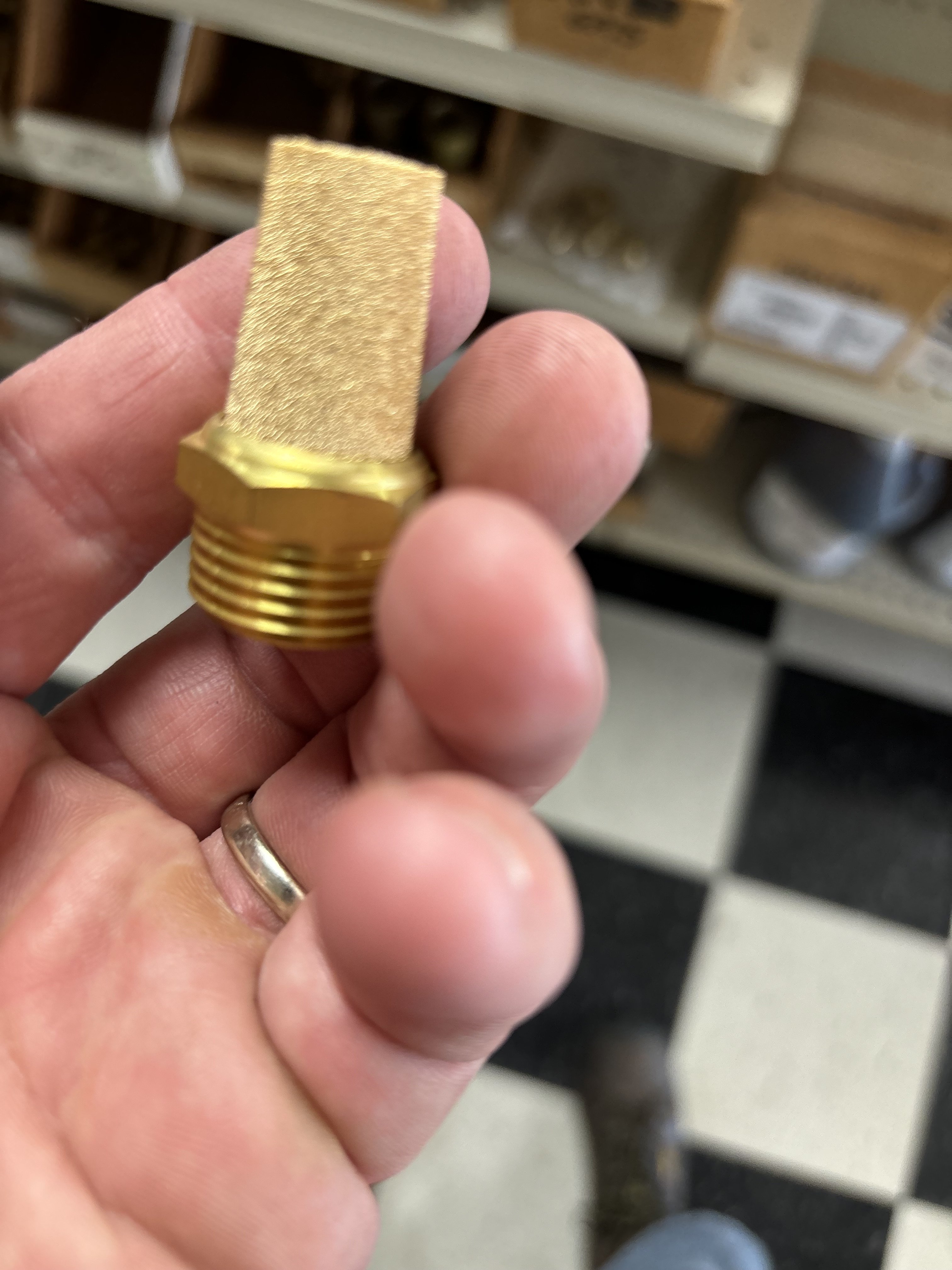

I found these brass mufflers on the shelf of my industrial supply store today when I was buying some new belts today. I figured I'd get a couple and see how well it works. I made a couple calls from the 2 guys I trust for these kind of technical questions and they both said yes.
It went through 5jobs today (9hrs) and it seems to work great
The hole to breathe is 10time bigger diameter than the tiny hole in the stock cap
And I don’t see any way for this brass filter to get wet with oil like the little filter does so it shouldn’t build up pressure in the blower since it’ll breathe better
9hrs and the filter stayed dry. I’ll update more about a month from now
