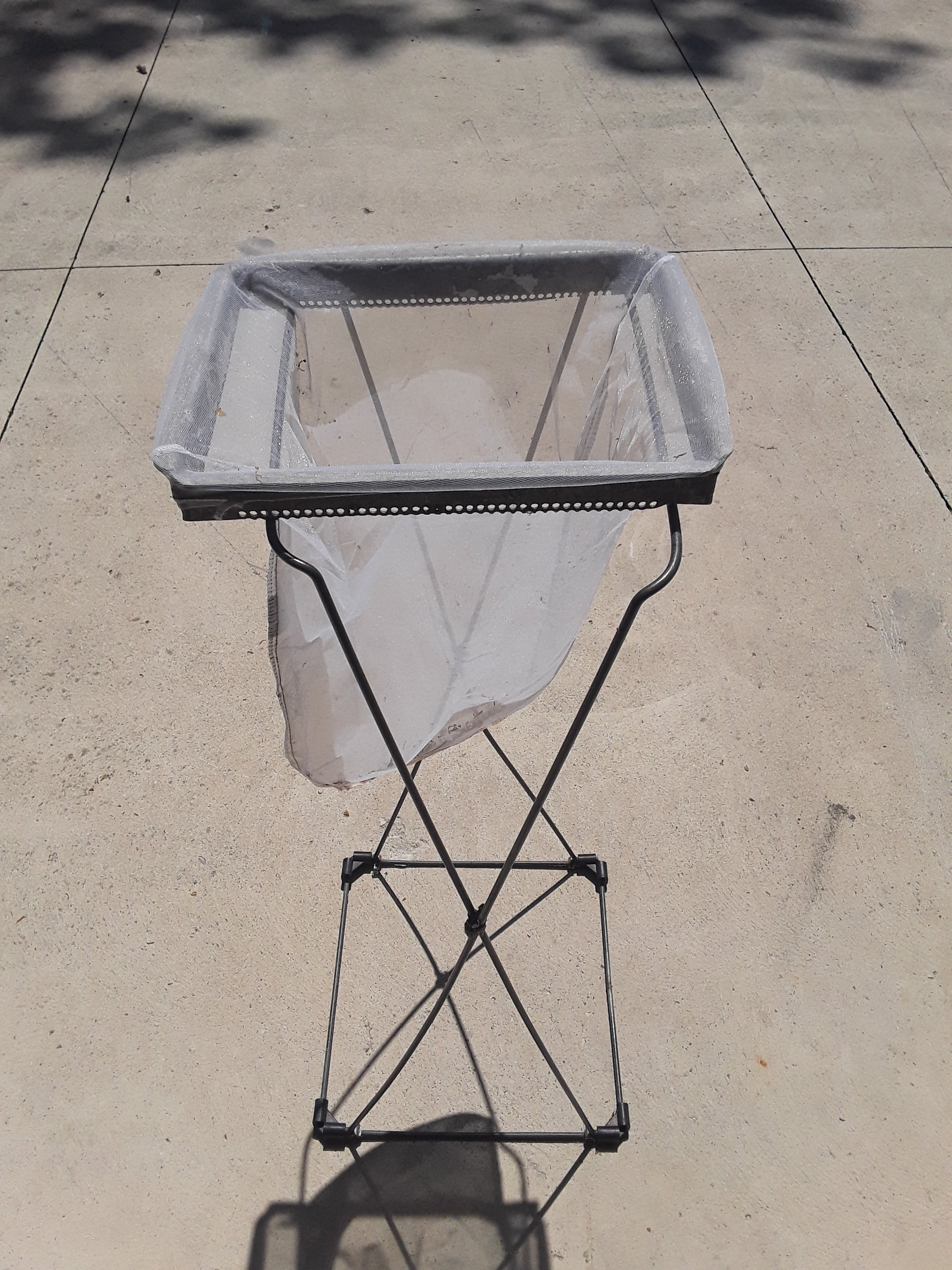

Rob Grady
Talk about airflow! I had the silver bullet Devestator, but the puddling at the bottom of it was very annoying, and sloppy to change out bags. This gives me maximum performance and is easy to swap out bags.

What is this and where does it go? And where do you get this? Thanks !!
It fits into the waste tank directly under the intake ports. My AquaTech nits came with a metal basket which would catch the debris entering the tank. I cut off the bottom of the baskets, leaving just the top lip to hold the paint strainers.
With this setup, I have full airflow around the strainer. As the tank fills, the debris gets submersed in the dirty water, but there is still plenty of airflow.
