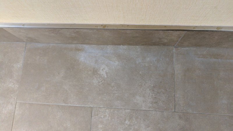

Aug 9, 2017 #1 J jawhit Member Cleaning Professional Joined Dec 29, 2015 Messages 80 Name Joe Had some viper renew that dried on a tile job last night. It put a haze on the tile. Any suggestions on cleaning off the haze? Attachments IMG_20170809_083200.jpg 63.4 KB · Views: 554
Aug 9, 2017 #2 Mike Pailliotet Administrator Cleaning Professional Joined Oct 6, 2006 Messages 117,341 I've never used the Viper products, if that's the acid one, I'd rinse that with ammonia
Aug 9, 2017 #3 J jawhit Member Cleaning Professional Joined Dec 29, 2015 Messages 80 Name Joe Yeah its the acid. I'll try some ammonia.
Aug 9, 2017 #4 Old Coastie Supportive Member Cleaning Professional Joined Jun 29, 2015 Messages 7,504 Name Stephen It will come right off.
