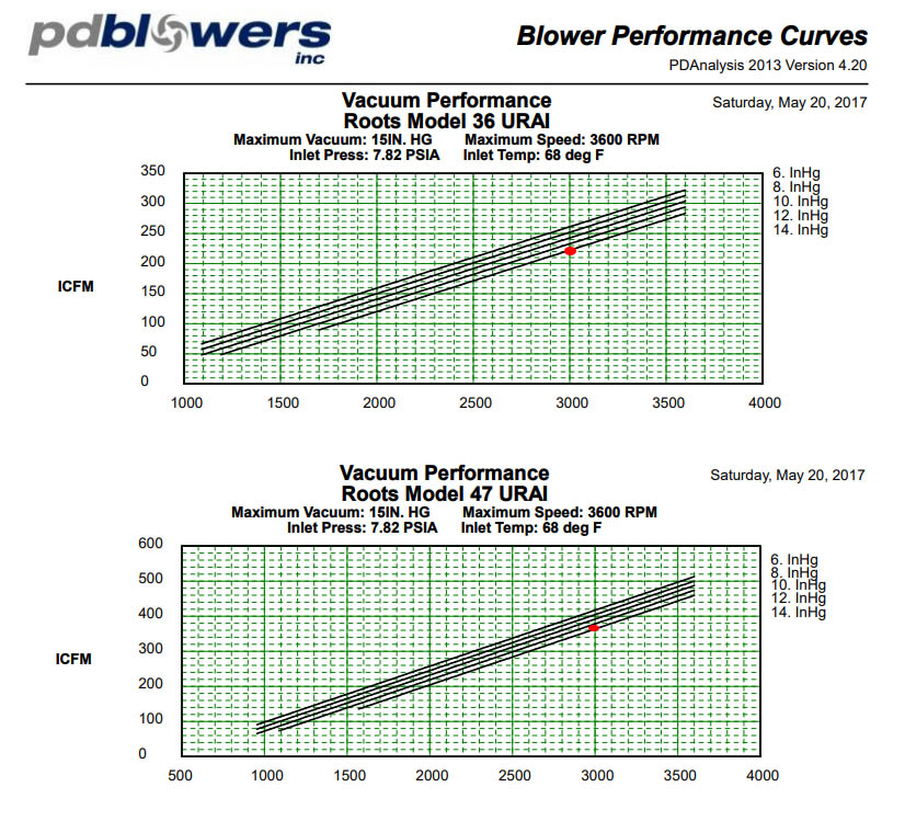

JohnHawkP
Interesting.
So a Roots 47 Blower has around 140 water lift from memory.
Something isn't adding up for me here.
Interesting.
The 47 blower, assuming set at 14"hg is around 190 inches of water lift.
but alone this is a meaningless number
If you start looking at the curve of progressively larger blowers you see that they are capable of moving more air AT 14"hg . The actual work being done under a specific load so to speak.
Generally the lift of any given tm is set at 14" hg. The performance increase is seen in the amount of air being moved at 14hg.
So a good question is how many CFM will a truckport move AT that lift level?
edited for clarity corrections
J
JohnHawkP
If you start looking at the curve of progressively larger blowers set at the same rpm/hg you will see that the amount of air move AT that vac level increases. The actual work being done under a specific load so to speak.
Yes there are many questions to ask.
470 cfm from memory.
I like to set the Hg lift at 17
I edited for clarity and to fix a mistake/something that could cause confusion.
Here are the performance graphs of a 36 and 47 standard sutorbilt urai blower. Chosen because they share the same max rpm. Both are easily capable of 14"hg/190in of water. The difference is how much air is being moved at that lift level throughout the curve.
At the red dot in this image (3000rpm) the 37 is pulling 220cfm at 14". The 47 is pulling 360cfm.

JohnHawkP

I have measured a 47 at 470cfm
I'm not arguing the stats of any specific blower....................
I'm talking about porty peddlers using the lift number alone
Reactions: JohnHawkP
J
JohnHawkP
Two hundred inches of water lift @ ZERO cfm.
Thus like pushing on a boulder with a ton of pressure, and the rock doesn't budge.
In each case if nothing moves the effort is moot, no work is done at that point.
Thanks Lee
That is what I was trying to work out.
Smoke and mirrors
