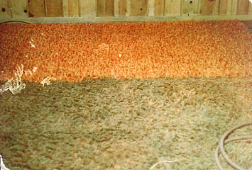

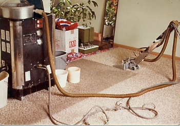

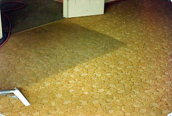

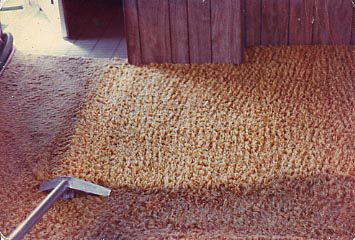

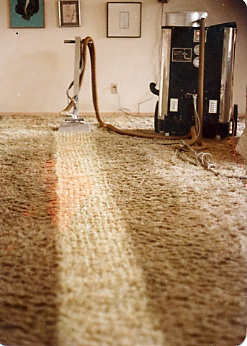

My Dad was a one step in tank cleaner back in the day, if it was extra dirty he'd 2 step and prespray a room with his wand before extracting.
No vacuuming either that was what the customer did.
He had lots of happy repeat customers.
But couple extra steps do make massive difference to the job and your rep if your competition doesn't
These are some pictures of the one step method back in the day. Steam Way Powermatic, Steam Way Wand, Steam Way Formula A detergent through the truck mount.
