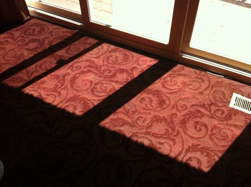

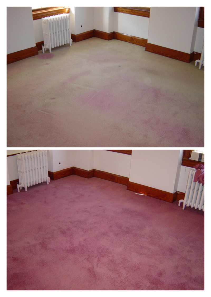

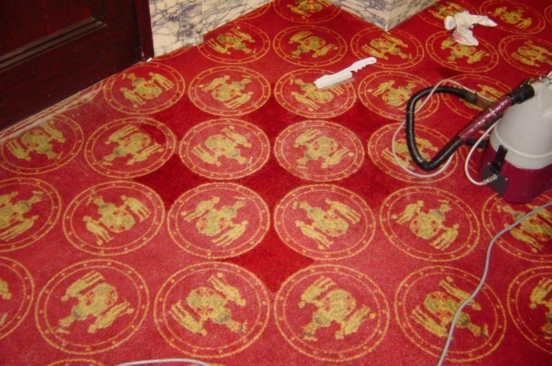

Cleanworks, yes, it's possible to restore just the areas that are sunnfaded. It's not necessary to do the entire carpet.
Here are a couple of examples.
The first pics show sun fading along a glass door. We restored only the faded areas. The second set of photos show a stretched limo where we restored only the sun faded sections. The third photo shows an entire room that was restored, but you'll see a circular area against the far wall where a plant had been covering the carpet and some areas in the center of the room where a bed had been. We worked around those areas since the original color was still present there.
The last two photos show the carpet in the Maryland State Capital Building in Annapolis where the red background color was faded, but the yellow patterns were fine. So we worked out around the unfaded areas to restore only the faded areas.
