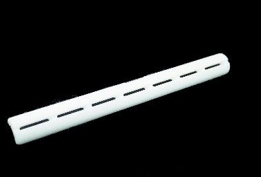

I see that as the benefit not all the other stuff. I am not bashing glides I was answering a question and the question was "Do they clean better"
Now the glide mafias can stop PMing me :lol:
I don't know who makes this one but it is similar to my slotted(I have the hybrid as well) Point out where there is more cleaning area than an unglided wand floorguy. I see 20-30 or % of that covered. Now I look at it it is probably over 50%

Just a note: Glides Do Not increase agitation. You always lose agitation with a glide. More so with a hole, less so with a slot. However that is generally easily compensated for by the positive qualities of a glide.

So Greg is saying if you reduce a wand's vacuum slot by half, you are somehow reducing it's cleaning ability?
Jez....Crowley, I thought you were brighter than that.

You need to read the Ameteck/Lamb charts. reducing the orifice size increases air watts and velocity. That's why HM's high efficiency skids are half the slot size as the old skids. This phenomena is more pronounced the smaller the machine. The difference in recovery on a small porty between a hole and slot will be significant, on a Vortex it will be negligible.
What you lose is DEBRIS REMOVAL capability by making the orifice smaller.
I have no clue what lead you to believe that.
Greg is saying a few things
1. If you reduce the head of a wand escpecially after heavy duty agitation you may have trouble recovering everything you just pushed to the surface. Even after a serious vacuuming my waste basket gets filled with hair, sand and debri
2. The pile doesn't have all these lines in it and lifted better with a naked wand not leaving especially where you get filtration areas around nightstands etc so the the areas are cleaned more evenly
3. The ability to move faster isn't a pro it is a con. If the arguments are that you can move faster and it will dry quicker, that is flat out wrong because if you are moving faster you aren't receiving the benefit of the faster drying. The glide is great for some owner operators from a physical standpoint. As someone pointed out to me at SFS after I was telling them my body feels better than it has in years(looks aside) and he said "you haven't been doing this that long, wait"
