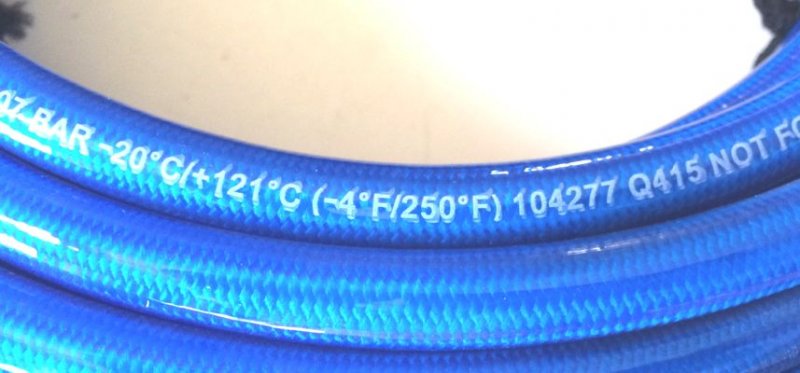

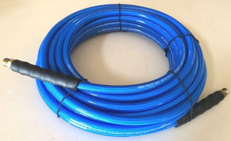

This new 250 degree Blue Thermoplastic solution hose.
Insulates heat well and slides easier on the carpet.

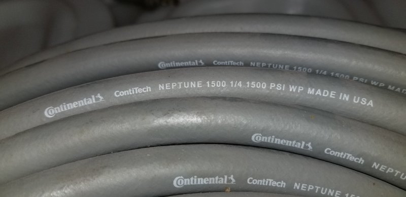

Goodyear Neptune with the nylon braid. We also have reusable fittings that can be changed in the field.
Our hoses last several years as well and these are all employees.
Wow, Brian. I didn't know Goodyear had an all plastice hose. Where did you get it?

Our new hose is rated 20 degrees higher temp than the Parflex (& rated 3000 PSI).
Plus it is more flexible
I have been using Larry's new thermoplastic solution hose with my high heat Butler. I use Butler's live solution reel that coils the hose tight. The hose lays flat even on these cool New England mornings. If Larry's new hose holds up as well as the Parker Parflex that I have used for years, it will be another board favorite.
