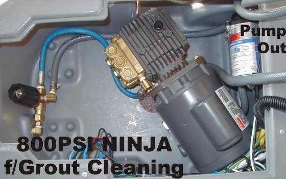

John;
Here is a picture of a General 2.2 GPM @ 800 PSI pump in a Ninja:
It was for Carpet or Grout Cleaning.

curious Larry
do you have to open that machine up (in the pic) to adjust the pressure????

I'll bet that cavity was hot as hell, when those ninja vac motors set down it looks cramped, were they just 2 stage vacs?

Larry did you have to mount the assembly on a steel plate? I'm going to take some pics of my old beast, fire singed as it is with the dual vac head.

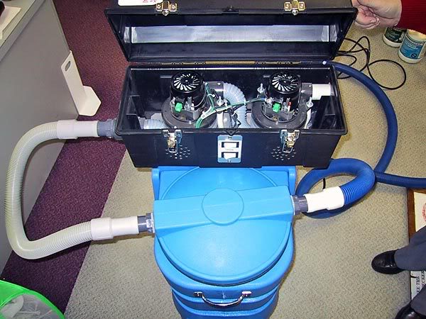

Here's a picture of the Ninja vac booster setup. Quad 2 stages, both in series to the lonely standpipe. AWESOME vac.

Greenie;
It had two 2-stage vacs and a cooling fan for maintaining the components.
No metal plate, Willy, but we did use large SS fender washers underneath the pump motor.
