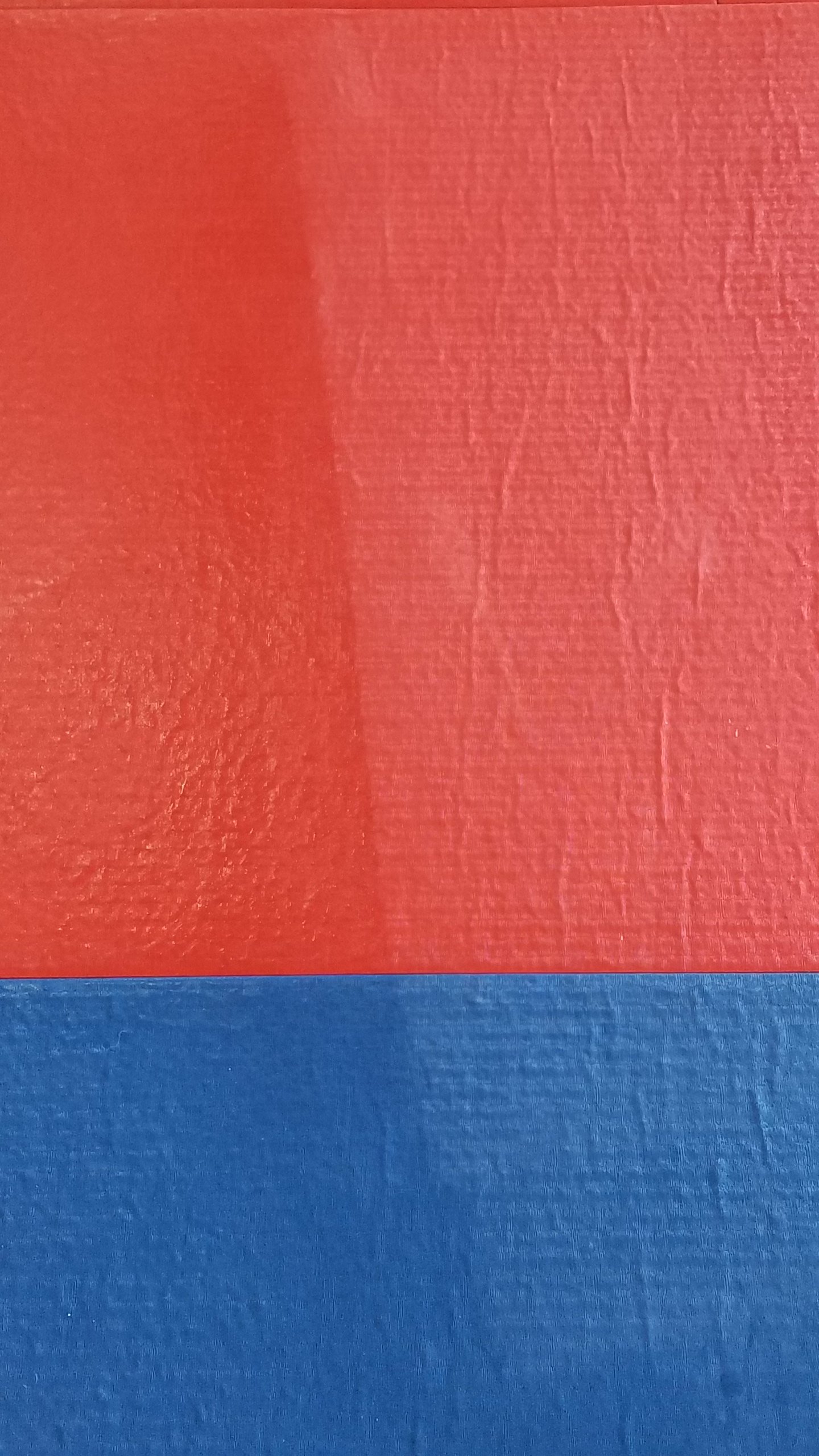

Second or third time I've done these, usually found in Martial Arts studios.
They've been mopping them on occasion.
Black top parking lot
Blood, sweat and tears..
Procyon mopped down, Red padded, glided wand rinse @ 300psi at medium heat, micro flat mopped any puddles

Why didn't you use a tile wand with a brush on it? It looks like your carpet wand would lock down on it
Cleaning Professional
14,646
I hate my tile wands and only use when the wand does not. It worked killer.
Larry is sending me one of his tile wands, so I'll let you know how much I hate it
10,260
I wouldn’t worry about all that, you killed it! If you microbanned, you’d want to do that first, then neutralize. Looks good.

I clean them but I use a microfiber bonnet for agitation
Afraid of a red pad

You guys crack me up with the buffer on the gym mats. It’s not like it’s restaurant grease. It’s just dried sweat. Let the chemical do the work and just rinse.
It should almost be the same as doing a urine treatment with some all fiber rinse. Just spray, dwell, rinse and suck
117,387
I tried with just prespray and the wand.
Very streaky.
Why or how would a red pad damage thick vinyl?

Red pad won't hurt it unless it very cheap stuff.
Have more concern with moisture between the cracks of the mats, would need to run air movers a while as I don't live in the desert.
