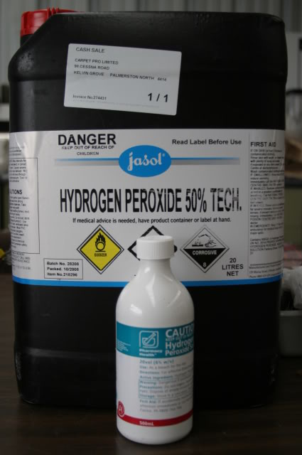

If that is the case, why do they sell it at higher %'s then?
I can buy 50%... in bulk.
John

It would be foolish to buy it @ >50% concentration.
Heat and slight contamination can cause immediate problems. Have you ever seen a drum rupture from overpressure ??
It is also in a higher hazard class (UN2014).
The safety agencies would demand to see your HAZCOM training program, if you had a spill.
Not worth the combined RISK.
Larry

It is still dangerous....
Quote from a manufacturer:
"Small amounts of other materials that contain catalysts (silver, lead, copper, chromium, mercury, and iron oxide rust) can cause rapid decomposition and an explosive pressure rupture of the containing vessel if it is not properly vented."
Larry
