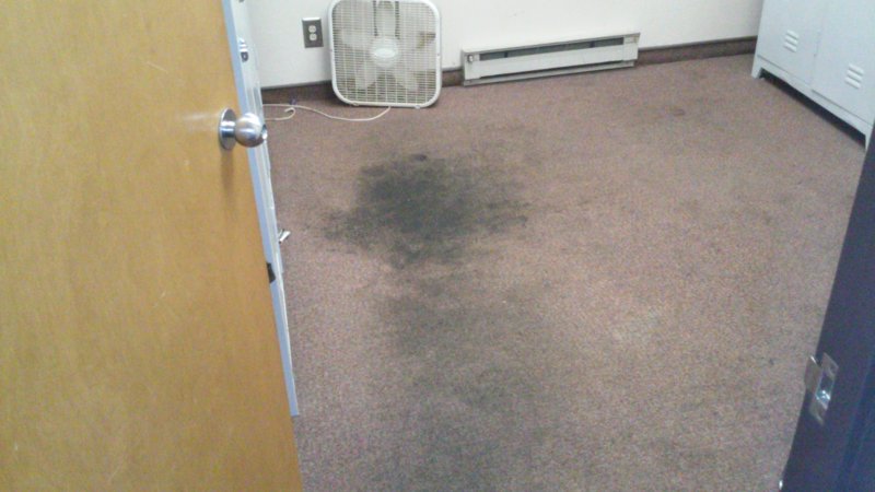

If my Mach15 would've had a good seal on the carpet, I would've been able to make quota on time. But since I had to use my little prochem quad, I lost a lot of time.
And I didn't prepare for the job like I should've. When I arrived I had to find someone to give me access to a room that had water access on both sides each time I finished a side. And I never should've used an inline filter. Both my devastators got clogged up with mud (Yes I prevacced).
I think if those two things weren't in the way, I would've saved enough time to make quota. I made $66/hr on that job, but I was by myself. So I'm not complaining too much

No, you are actually lucky -in a sort of - weird way that your wand didn't "have a good seal" on that carpet. That wouldn't have allowed even that much air movement to extract moisture, as opposed to what you got with your other wand.
Reactions: Bryce C and Mikey P
14,126
I somewhat agree and disagree. You need a good airflow, but you also need to have a connection to close off one of the lips on the wand to get that air to direct the water up .
It felt as if there was no connection on either of the lips with the mach15, which would've over wet the carpet.
I know this by how fast the carpet dried. It felt bone dry the next day, and how much water and mud I was extracting

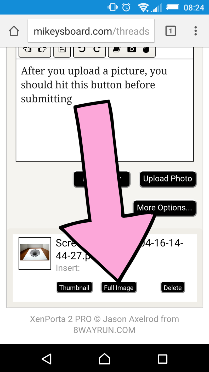

After you upload a picture, you should hit this button before submitting:
That wasn't my problem. It was how it recorded it. I laid the phone on it's side to make it record full screen, instead of laying it upright, but it still recorded like it was on upright position
I meant for you to show your pictures... I didn't even look at the video.
