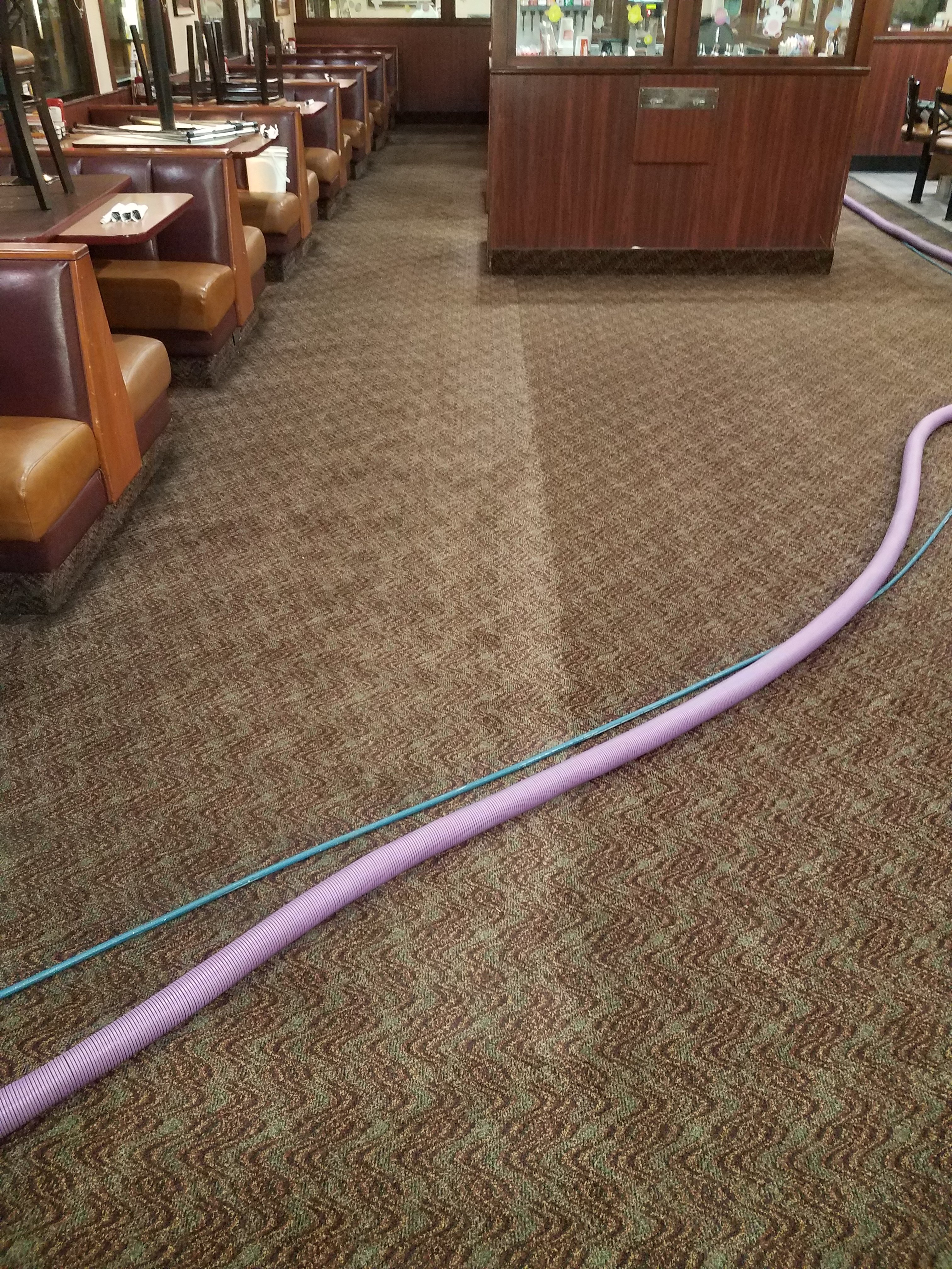

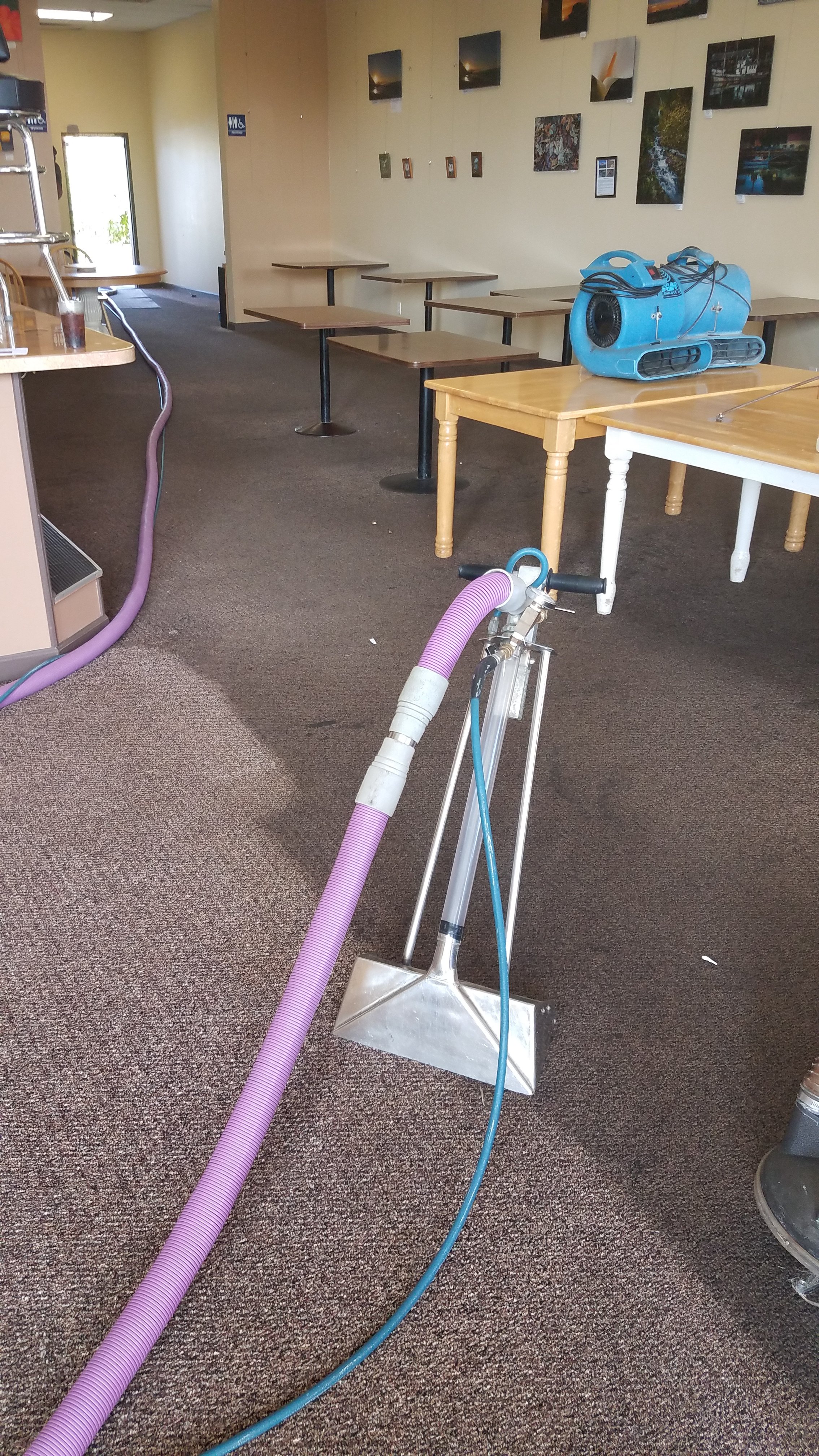

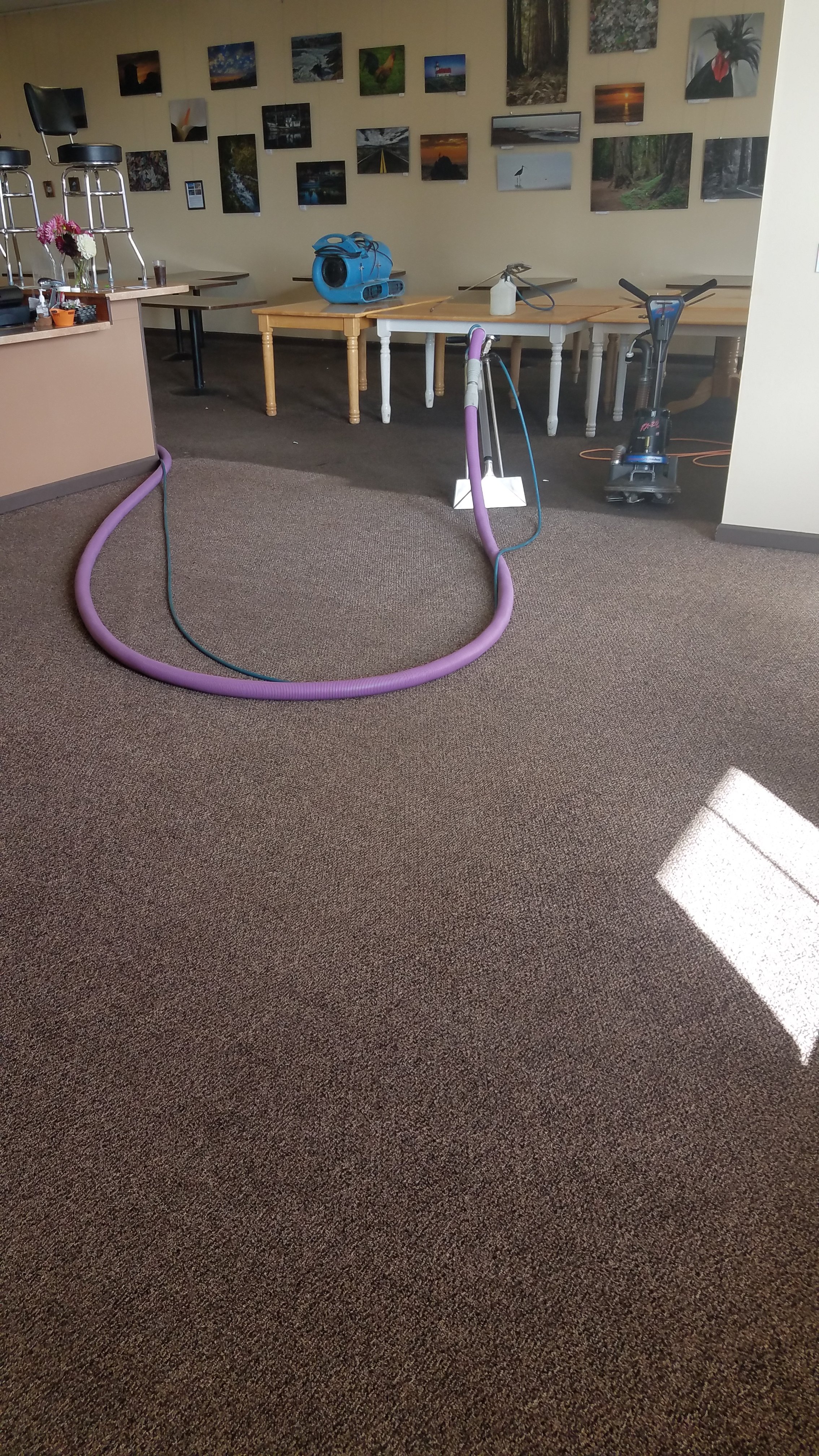

I prefer the rx20 and old school drag wand. I do every carpet twice. All carpets done by me are presprayed, scrub pass and dry pass using an emulsifier and rx20 then a rinse/dry pass using a rinse agent and old school drag wand, the rotary gets the carpet clean and the drag wand gets um dry and residue free

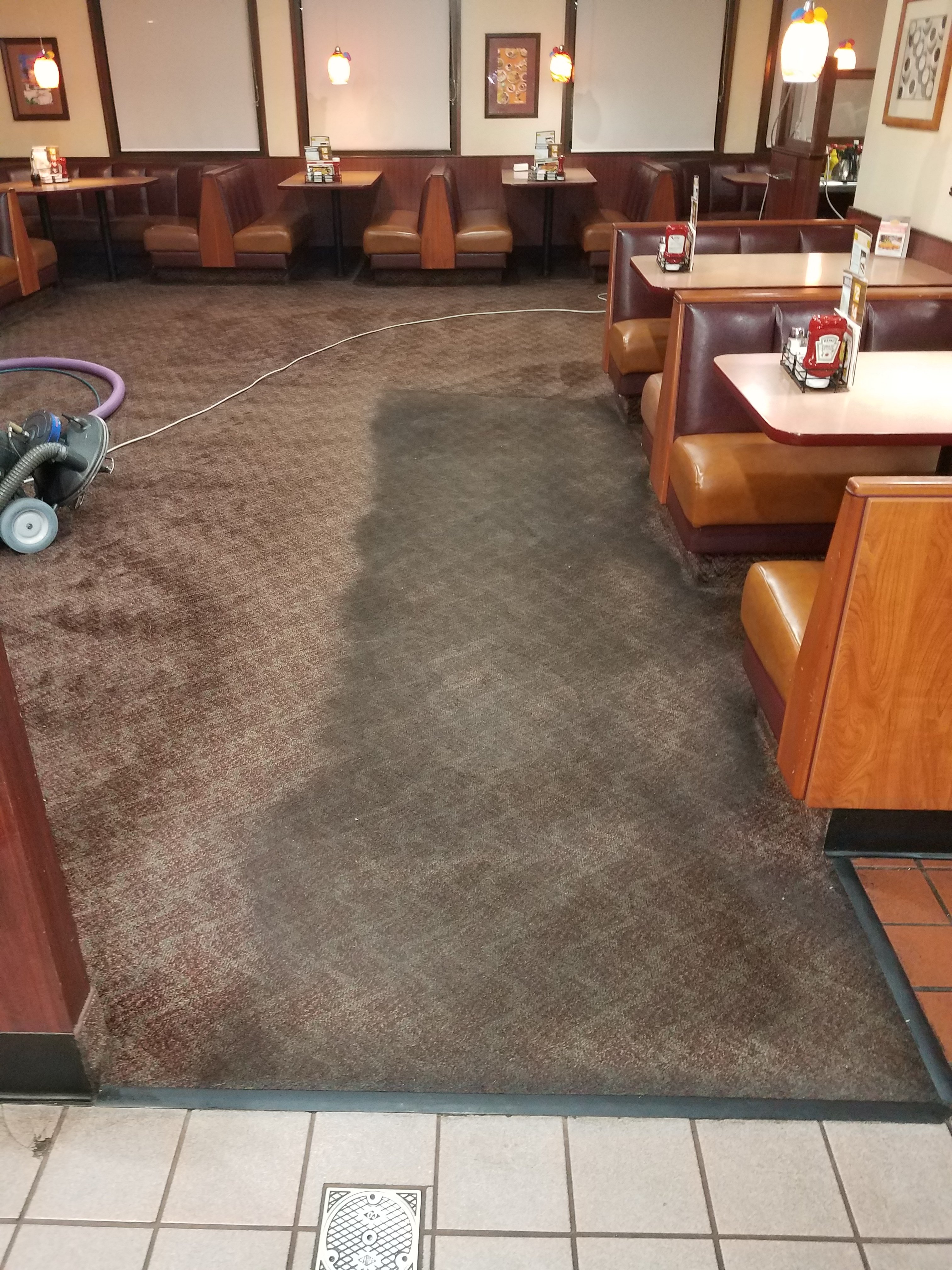

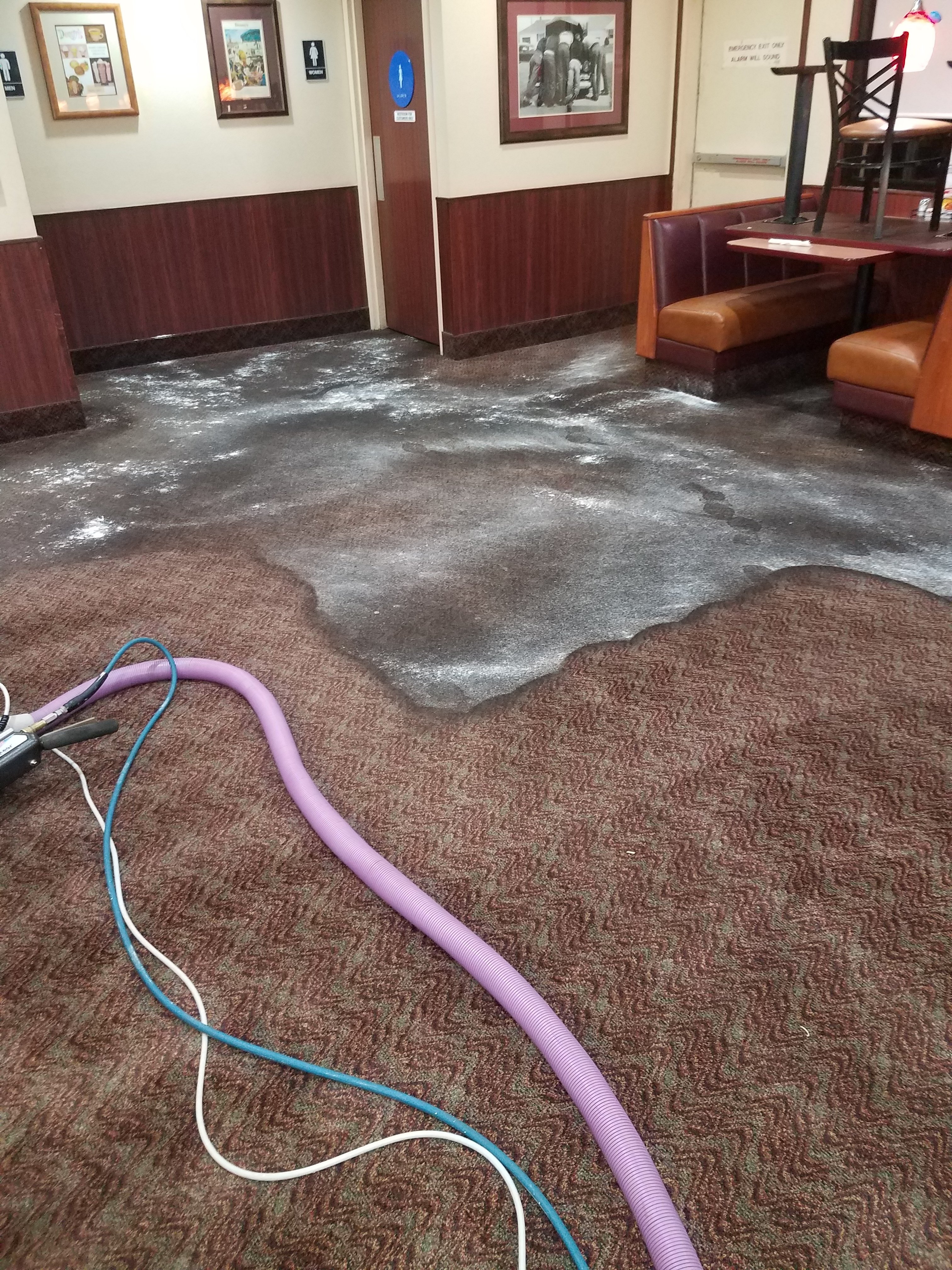

Heres a couple of restaurants 1 was done by someone who left a crap load of soap in it had to use a truck load of defoamer but it was clean and residue free when I left

What the heck are you using that you need to use so much defoamer? This isn't 1985, there are new/better chems out there.

I used more defoamer on that one Dennys carpet than i used on all the carpets ive done in over a decade combined! , im sure there is better stuff out there but not available at 1 in the morning in fort bragg

It wasn't what i used it was what the last guy used that was the problem , i just showed up and surprise !!! 😶‍🌫️😶‍🌫️😶‍🌫️🤯🤯😵‍💫😵‍💫🥶
