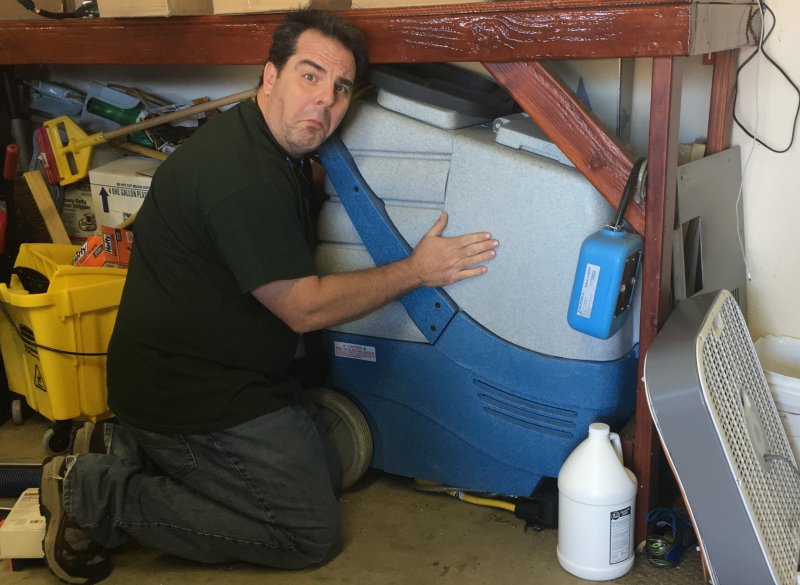

My truckmount was parked in a garage and a heater inside the van when it was really cold. Seldom had freezing issues. But I did let it freeze twice. Once was just the Dwyer meter cracking.
The second time, an employee left it parked outside since the forecast did not predictfreezing (just 33 F). A plastic filter broke from expansion as the water froze. That acted like a freeze plug and probably savedthe unit from worse damage.

Hey Damon for starters your lucky you picked up your machine when you did. I-5 is shut down. Now for me yes I froze my amtex the day before I was getting my new 575. I did a job Sunday afternoon and then came home. I forgot to plug in my heater, which I usually check twice every night. That night was the coldest of the year so far, 4 degrees. In the morning I was all excited to go over the hill to get my new 575. We'll I opened the trailer door and smoke came out my mouth. Oh god it's froze. Then I made the mistake of trying to start it.I was trying to get it warm. So I just got in my truck and went over the hill to Medford. I cried on the way there. Oops that's personal. The damage was basically the pump and a pressure hose. Also mike replaced all the pressure connections cause they were all done wrong. Costs $800 to buy new pump and fix hoses and get it ready to ship. I'm building a garage this year hopefully to never let this happen again.
