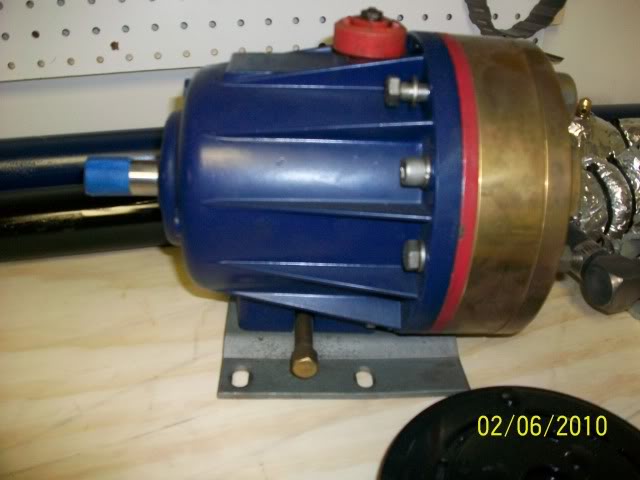

Now I just need to work on this pulsating pressure pump (or replace it) and the SG will be good to go/
Sep 15, 2007
44,665
Larry B said:
I wish but no this one has been replaced with a cat pump
won't work...that's why it's pulsating....remember the brand new cat pump i sold a while back....some idiot tried to put it on a Genie.......NOT COMPATIBLE!!!
Cats are piston pumps where as the Wanners are diaphram.......
you'll NEVER get the shakes outta it......maybe a damper will hep...but i doubt it!
