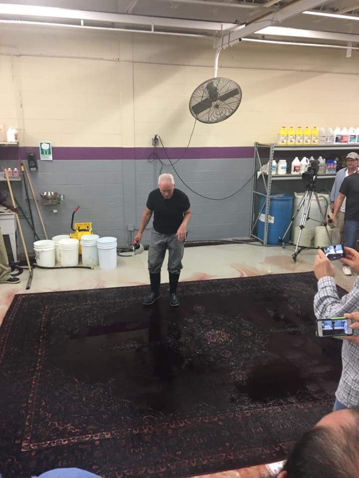

Streepene is the old technology.
This is an example of the new one:
http://mikeysboard.com/threads/dye-bleeding-created-and-removed.284136/
I am watching it Larry and maybe it's just the quality of the photos but I seems like the texture of the rug is changing. Having said that, I am impressed with your product and may place an order shortly along with some of your dye removal products. You have to treat me nice now because I am paying with Canadian dollars and paying a fortune for shipping and customs.

I think a fair comparison of Reduceall and Hydro would be using them the same way plants all around the world use Hydro....in a bucket of hot water poured over the rug, on the wash floor, prior to spinning or extraction.
After watching the video it seems like a ton of product is needed to create the reaction and what your 5 minute video showed could be accomplished on the wash floor in about half the time (depending on how stubborn the dye was being).
