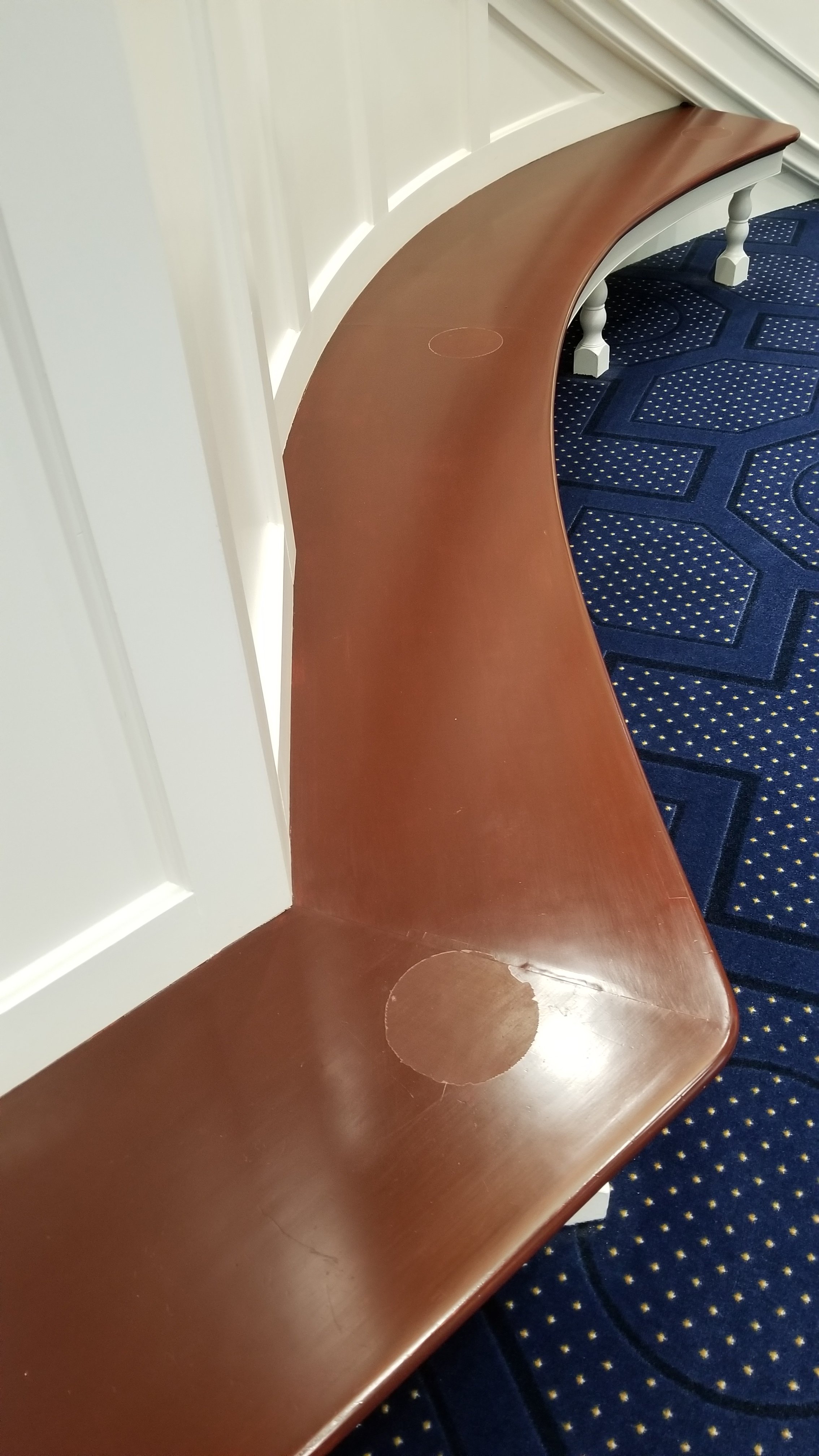

One did have issue in the other building with some put on a wood bench but it was more the custodians fault. He just pulled them off, taking off the finish and then called me to tell me.
We used a heat gun, warmed them up and they peeled right off the wood, no issues.

Had he heated up the sticker she would have peeled off fine. It was the only casualty of war.

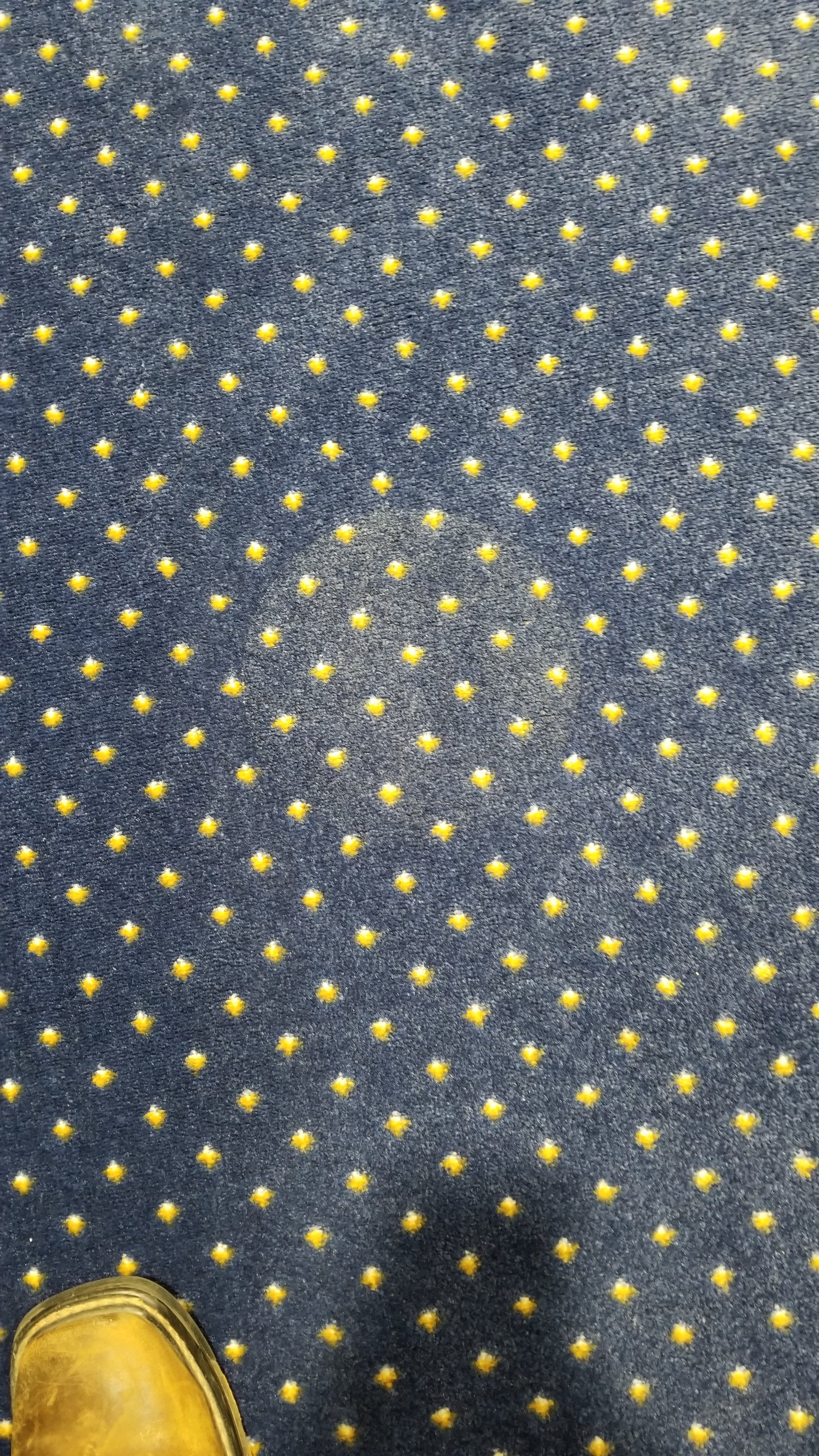

Here is where one was. Not sticky and hasn't resoiled in the last month. Still doing good so far. Although it did kinda crush the fibers down, hopefully it lifts back up with vacuuming and cleaning.
