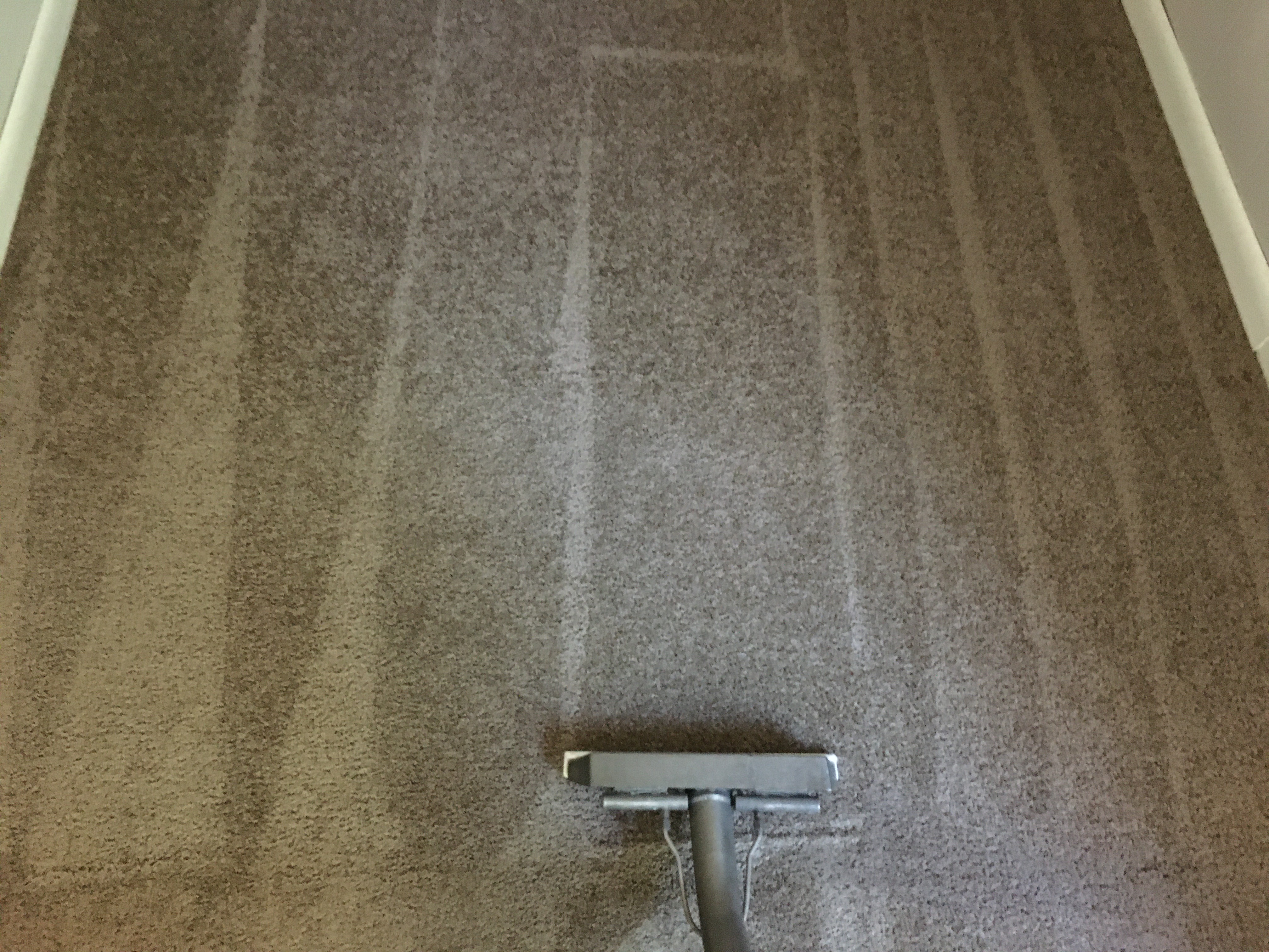

14,626
No bridge marks!
I noticed that too. I don't know why it showed the marks on the first job and not the second. I increased the water pressure on the second job to try to cause distortion and it didn't happen. I'll leave it at the set psi of 600today and see if it gives the same result. I like the new glide much better than the one I bought a couple years ago
  • Love
Reactions: Mike Pailliotet
117,249
Feel the love...
50,007
It’s not normally a problem if you always clean thick pile, large denier carpets. It’s going to be in the cheaper grades that it shows up.
