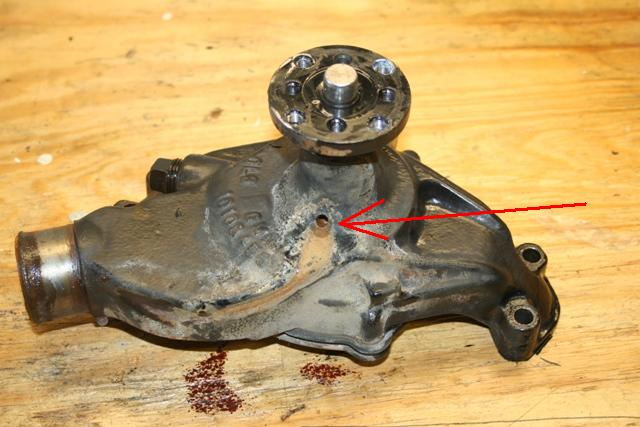

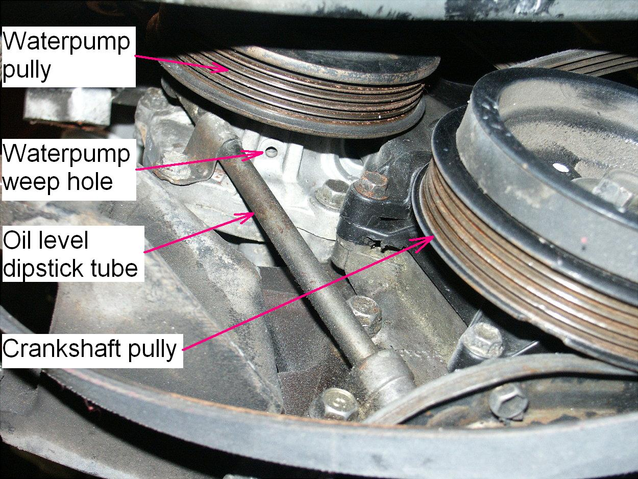

I've been corresponding with Justin from Legend. Working through one thing at a time. I think the diverter is always open because the water temps don't get hot enough to close it. I'm wondering if the problem might be an air block in the cooling system because the water pump has been weeping water. I do get occasional hot water and when I do, the radiator cap on the motor is hot. When the temps suck, the cap is warm at best.
