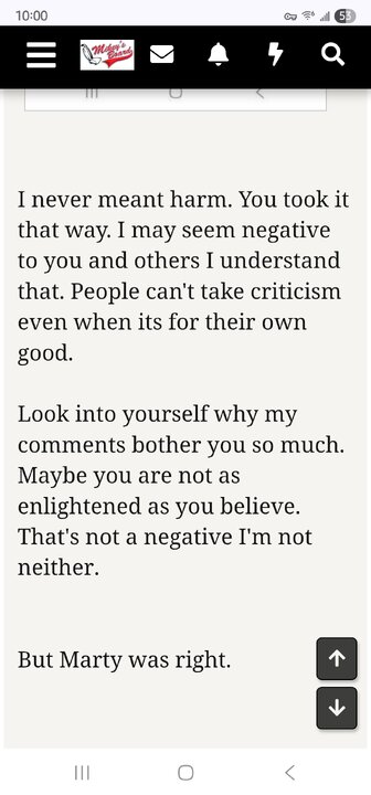

This got me ignored. He thinks im butt hurt because i blocked a couple idiots instead of continuing to piss them off with my replies after he said he didnt want all the arguing.
Im really not sure what comments he thinks i was offended by.
Its just more of his warped perceptions. Its never him. His ego is too big to let that happen.

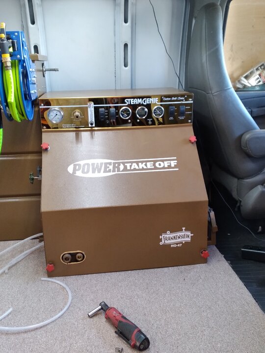

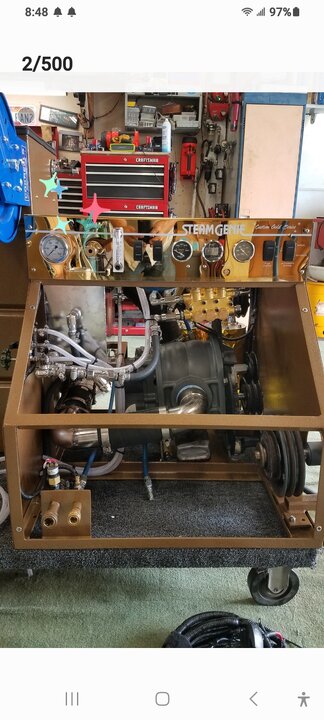

I got 4 of them im parting out. Come on down and get yourself one or two. I have 8 steamgeni ptos total. Frankenstein, my main machine 2000 chevy with sg pto as a backup 2 others already parted out in storage keeping as personal parts. Then still in vans i have my old spare( still running,barely) 93 ford w/sg pto 2003 chevy w/sg pto bought as package deal never did anything with it. My old main machine 1998 chevy w/sg pto (blown engine) and waiting for space, a competitor's 92 ford w/ sg pto blown engine the last 4 are up for grabs at this point im going to part them all out. If i don't find homes for them , ill keep the drive shafts, waterboxes,heat exchangers, & vacuum relief valves. Sell blowers and pumpsand reels and i really hate to do it but scrap the rest. Any of these can be be built to last decades an installed in new or newer vans. If your the kinda guy able to take on such a project. I did and after looking at whats out there in the market i am really really glad i did. I now have a machine that with proper maintenance will last 2 or 3 more decades before needing to be rebuilt or replaced not 5 to 8 years like the crap on the market today.
What is it with a machine like a Steam Genie that makes it so much more durable than other machines? Is it a really high quality pressure pump and blower? Slightly stronger fittings and pressure lines everywhere? A more intelligent design that preserves every part better during normal use? Or...?

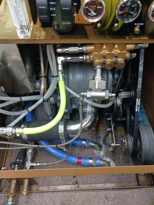

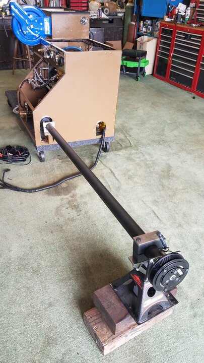

Design, for instance drive shaft, straight with inner and outer only 2 bearings easily rebuild no ujoints. Belts are adjusted with camed idler pulleys 2 cresent wrenches 1 bolt from start to finish less than 5 minutes ( including removing and installing covers)Wastetank/ solid stainless steel. Standard steamgeni uses starvation for chemical feed,no chemical pump and related parts (lines,valves,check valve etc.) Instead of a throttle controller steamgeni uses a somple solenoid( but only has high&idle). Acess front and top covers remove for complete access to all components. Its not that things don't wear out and need repairs. Its that everything is open and easily accessible. All machine components control panel, everything is in 1- 3'Ɨ3' box behind the drivers seat also when things need repaired or replaced, you can do it without standing on your head the difference between working on a steamgeni and working on yours is like the difference between changing spark plugs on a car built in the 70s vs. finding and changing plugs on one built today plus the added longevity of stainless construction. In short they are built to be repaired not replaced. Keep in mind when showing pictures of frankinstien ive added chemical pump, salsa heat, dual chemical tank valve dual wastepump float switches,throttle controller/ remote start/stop on machine and on the pressure pump. Blower Tachometer etc etc In short theres a lot more shit in the 3Ɨ3 box than a stock steamgeni, and still you can see and acess all components easily. I have a near stock one as a spare. Maybe this weekend if i have time ill pull the covers off and take some pics and put um side by side woth frankinstien. To show how much more simpler the stock ones are
