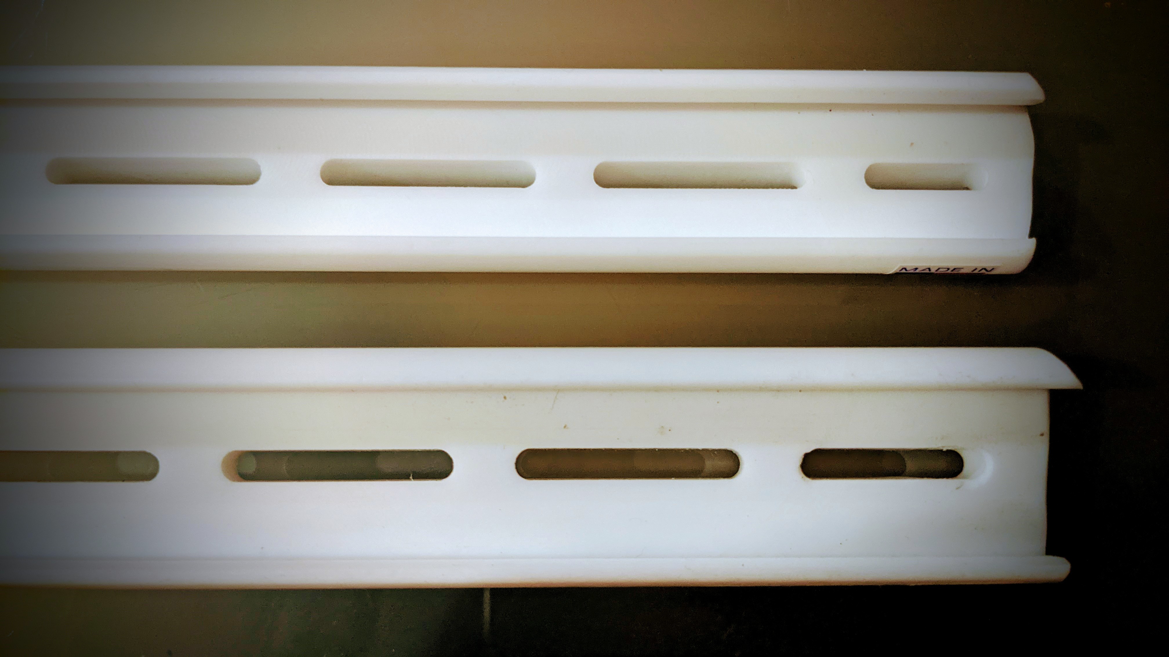

Im quite proud of these beauties...
116,520
Evo's.
Papa John was a big help.
Probably our most perfect Glide.
Numero Uno

That is our "slot" glide
Bridges are necessary for strength.
It's our best selling option by far and away.
Holes are good for super dense piles, Rugs mostly, especially when there is no one to stand on a corner.
Marty likes a hole because the Devastator slot glides suck.
and he's a gimp.

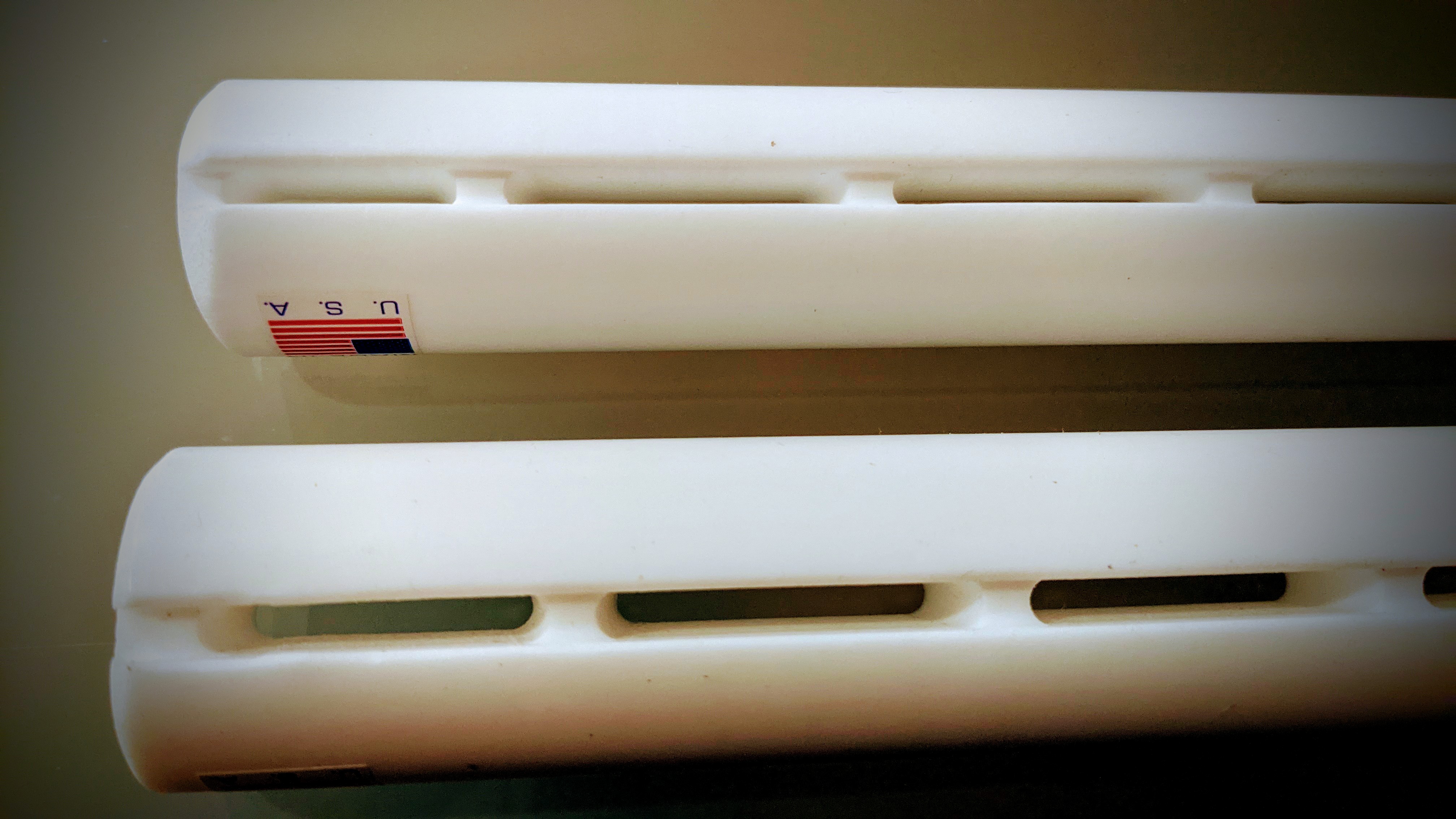

It's a nice glide.
I was skeptical of the water recovery due to its narrower slot- But the Evo wand with this glide seems to remover more water quicker than my Dev wand.
It's now my go-to wand when I don't need a swivel.
The wand did stutter sometimes on some carpet at first, but after doing a couple of homes it stopped. :biggrin:
I only use a hole glide on woven rugs when I need less suction.

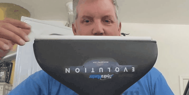

Wide slots create lock down, which gives the impression of more suction and better recovery.
Simply not the case, as you now see.
Teflon does need a few jobs to get smoother...
I have the 2 Evos, which I'll be doing plenty of testing with this month.

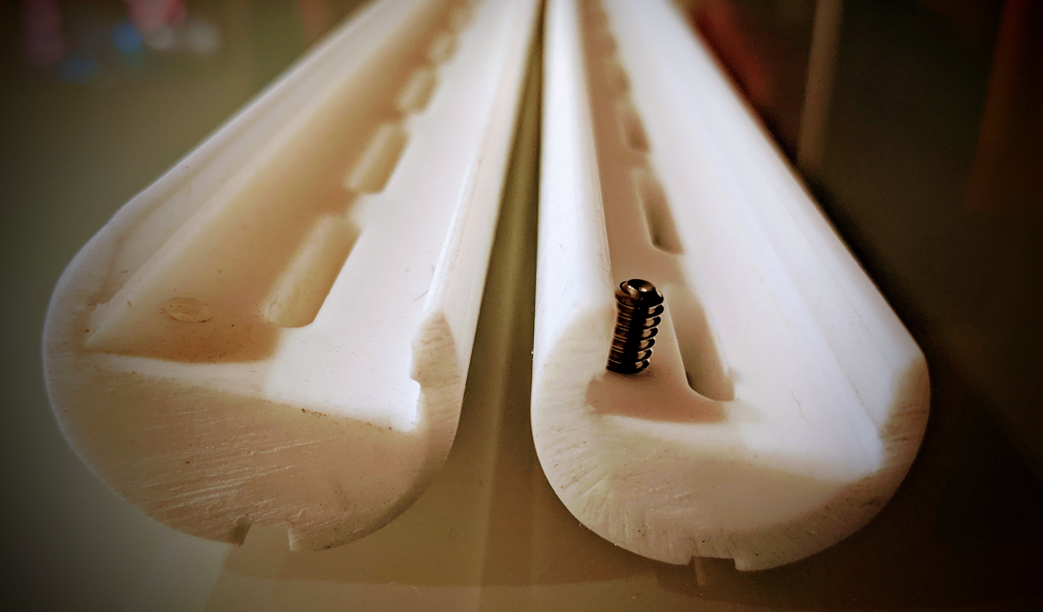

A whole glide is only easier to push than a slot glide that does certainly not clean better and any side-by-side testing with all conditions and equipment being the same that becomes painfully obvious.
All PMF glides have far too wide and opening in my opinion
If you get one of our internal fit Mach 12 glides in the slot pattern I think you'll see that the better results are definitely worth the slight bit of extra effort it takes to push and pull the wand

One of the differences between the pmf glides and green glides is that the pmf glides are very flat and that is what causes the lock down. The green glides are rounded and present less surface area to the carpet which makes it easier to move. I have a 2 inch titanium wand made by pmf with their flat Teflon glide that is almost impossible to move with a 47 blower. I also have a steel westpak 2 inch wand with a green glide that is a joy to use with the same machine.
