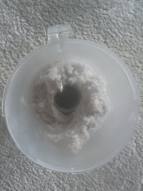

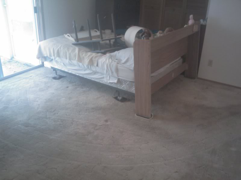

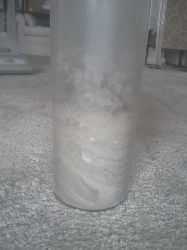

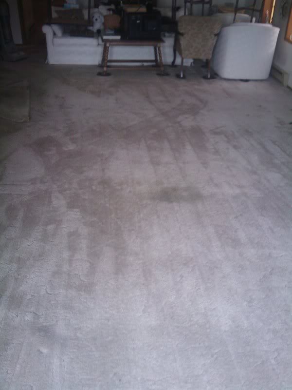

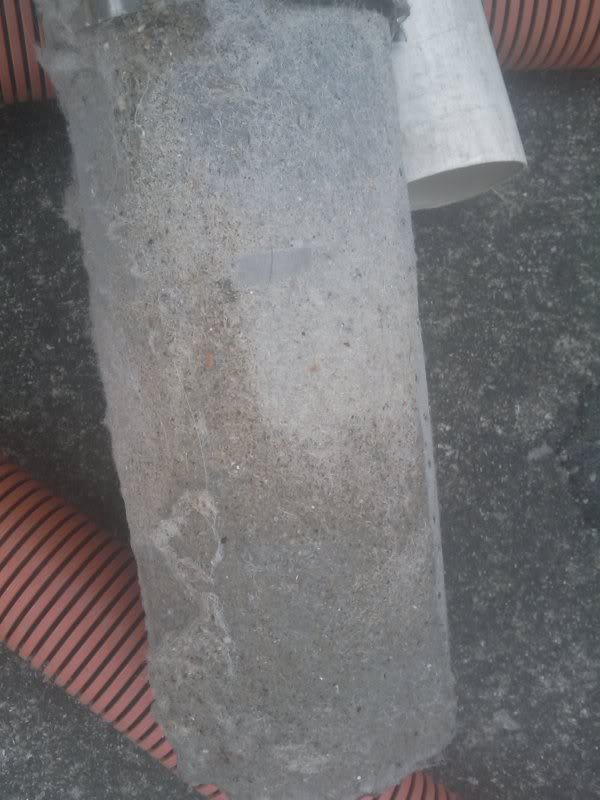

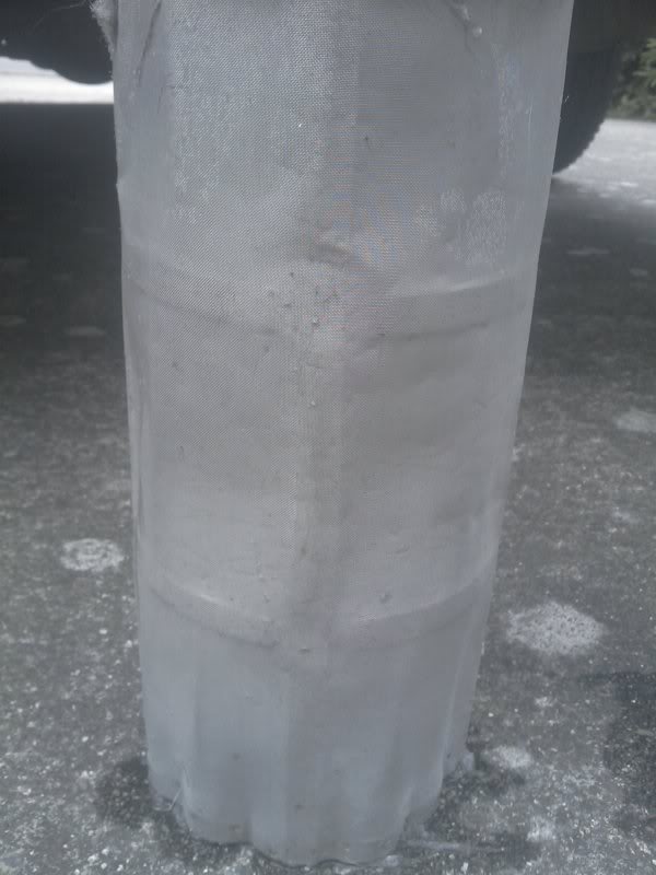

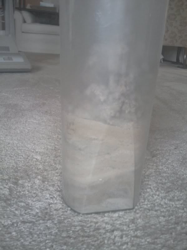

I'd really love to put that to the test. That was the whole reason behind that demo I put on at MF. Put a bunch of sand and carpet deodourizer powder in a carpet, clean it with a machine that most would agree would give the best "clean", let it dry and then vacuum it. In the demo it was a Genesis but unfortunately he wasn't using a greenhorn or equivalent. What he did remove was a fair bit of the sand, what it failed to remove was the powder, which once it got wet, it was there to stay.
I've see so much lint and hair come up from vacuuming a carpet that had just been vacuumed by the owner, I've seen what's on my prefilter before the TM (which is as fine a mesh as a blower filter, but I've NEVER seen more in my TM filter than I have in my vacuum canister.
I know a TM only will put a lot of junk in the filter if it's not prevacuumed, but is the soil removal maximized? When you get down and look into the carpet, you're looking over less than a square inch, would you see a white powder thats caked onto the backing?

Let's be fair Ron, Half the shit you vacuum out of a carpet is fiber and the rest is soil that that you don't know how much more you got than the other guy.
The majority is NOT fibres. Its dust and sand and unknown powder, sometimes its latex from backing breaking down. Go back and look at all the pictures I've posted. Yes, there are fibres there, a lot of lint, but the majority is granular.
AS for this cross contamination stuff, the only way that's ever going to be an issue is if some idiot starts making a big deal out of it and it gets all out of proportion as did the mold issue. I've been vacuuming since 95 and maybe once or twice a year I felt the need to wash the brush etc because the last place was such a filth trap.
I would love to not vacuum. It doubles the time it takes to clean. If you saw what I've seen come out of carpet that I "thought" was clean enough that I didn't need to vacuum, you might understand why I do not trust to not vacuum. I look at what comes out and I ask myself if this stuff would have gotten removed from just steam cleaning and it always comes back to me the same; No it wouldn't. Its like in my video. Some guys said that they would have gotten that carpet "just as clean in half the time" by just steam cleaning. No, they would have left a LOT of crud in that carpet, and it twernt just fibre I was vacuuming up.

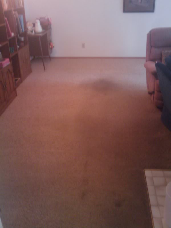

Here's the job,
LR/DR combo, FR, hall, 2 bedrooms. almost 1000sf
moved most of the furniture - Thank God for sliders
here's what the LR/DR, Mstr bedroom, and FR looked like
Vacuuming took 1hr
You can see the layers of soil. There is some carpet fibre but its only part if it. There's a lot of dust and hair and soil. Couple dark soil lines from entrances.
Here's how fine my prefilter is and here's what got caught on the prefilter after steam cleaning
Had I not prevacuumed that, there is no way I would have removed the same amount of loose particulate. I could have used the tank filter, much courser holes, I still would have left stuff in the carpet just wouldn't have seen as much in the filter.
