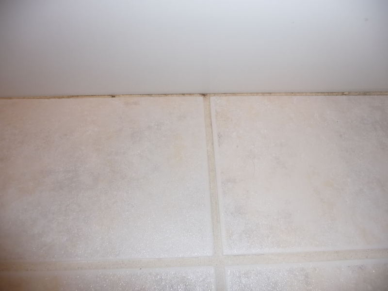

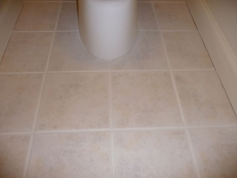

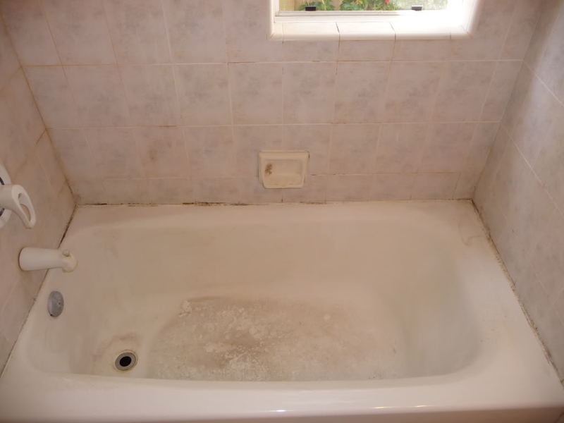

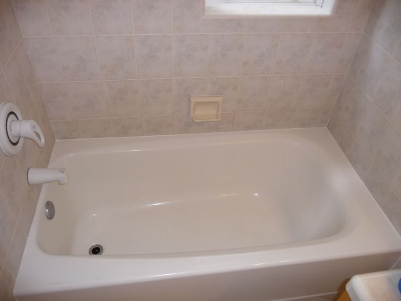

Other tub done yesterday (notice the proper technique of before and afters)
and some foreplay for Vince.
and a the promised chimp's eye view of Grout Perfect in action
117,258

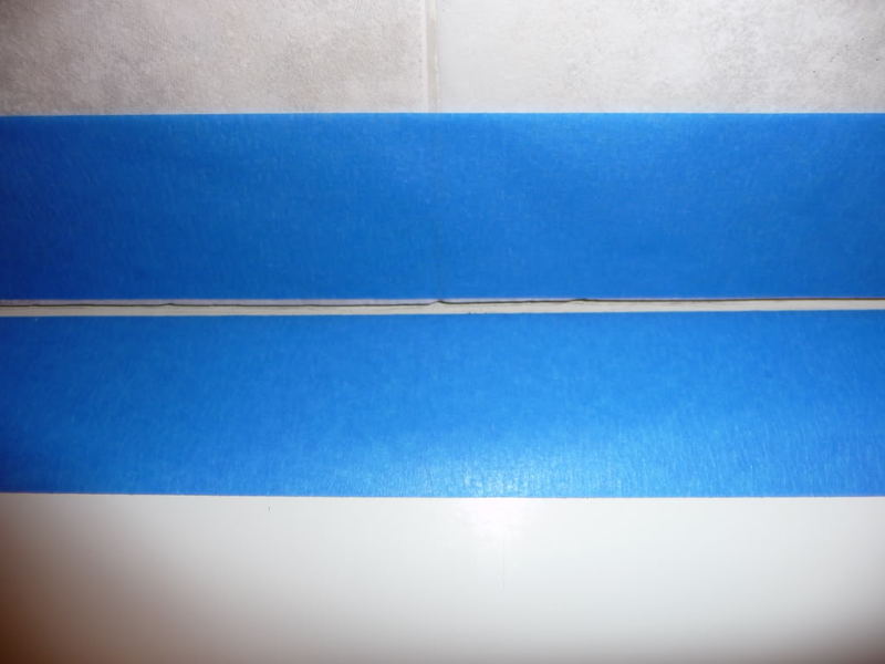

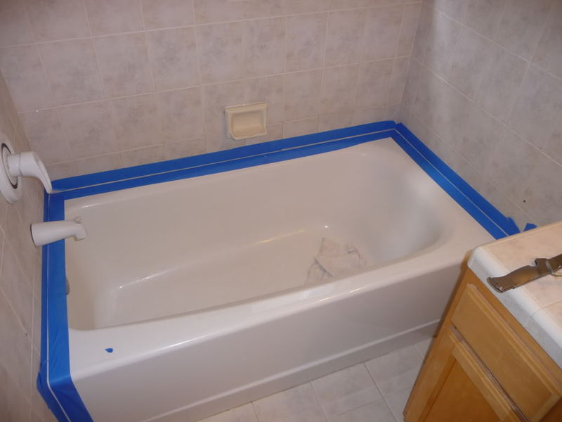

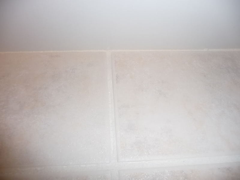

I've never seen the painters tape used to make perfect caulk lines. Nice.
Is it painters tape, or that other stuff you have cut in half?

I do a horrible job when I have to caulk. What is the easiest caulk to use? Whats the trick to gettin it smooth and lookin nice? How do you get the tape lines straight? Where do you get the lime away gel?
Golden Boy
117,258

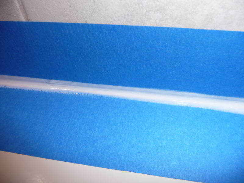

Dont use Caulk, use GE Silicone 2.
Good lord Waldo, I have to tell you how to put tape on straight?

Yes I have used the blue tape before. i have a bathroom I painted to prove I can not tape straight. If I need something caulked I call a plumber.

so Molly,
no seam sealer, caulk for the spout or valve discussion plate?
ya know water's gettin in there
having enough trouble with straight lines with blue tape that circles are out out of the question?

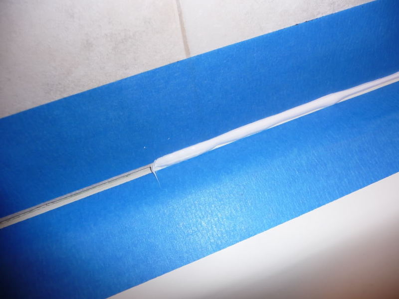

looks like you use a caulk gun to apply, inconsistant bead, i like the smaller tubes, exact razor cut the tip, apply near perfect, and use "a spray" sold at lowes, to smooth, this product, like another i got at coverings, will not allow the silicone to stick to the tile. so use carefully
carl
117,258
clean image said:
so Molly,
carl
Spout and plate are getting replaced.
I'll try the tubes, thanks!

Instead of using the blue tape try and use a popsical stick (paddle pop stick) that way all you have to do is cut the right size whole run your bead and than use the stick to tool with works very well for me as I use to use the blue tape all the time but no need to anymore.

What happened to just saliva and your finger?. It does ok if the caulk is not too sticky.
Albert
S
safeclean
The finger works well but you get a better uniform line with a paddle pop stick I still use my finger for the corners though and neutral cleaner not saliva yuk.

I like Laticrete Latasil 100% silicone for caulking ANYTHING. GE is a very distant 2nd best. Do not use DAP, it stinks, and is very difficult do use and clean up and really is not a good caulk. Do not use latex, acrylic, or siliconized latex. They will all crack and mildew. If you will be caulking showers, use the best possible 100% silicone caulk.
