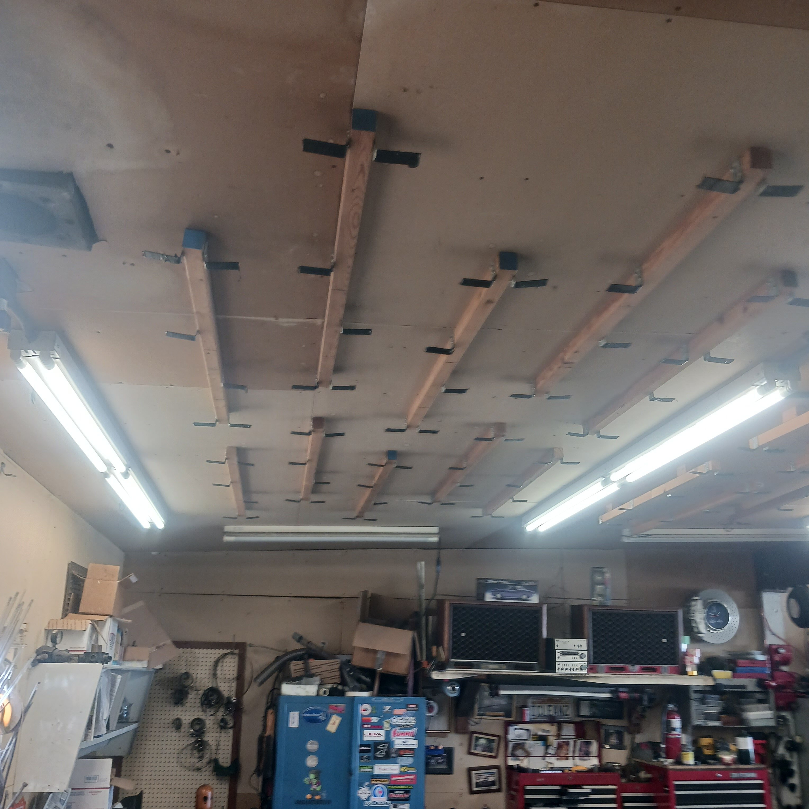

I used to do them on site but it got too expensive to maintain, insure, and license the 14' box truck to be mobile. For the past 10 or so years i do them at my shop. I try to have 15-25 of them to do before i setup the machine. I go around in the morning and pull um and bring um back to my shop where there cleaned, hung to dry then i re hang them in the evening
View attachment 134336 View attachment 134337 View attachment 134338 View attachment 134353
This is really interesting. I know nothing about this kind of cleaning so I have no idea whats in those vats. Cool to see though./ thanks

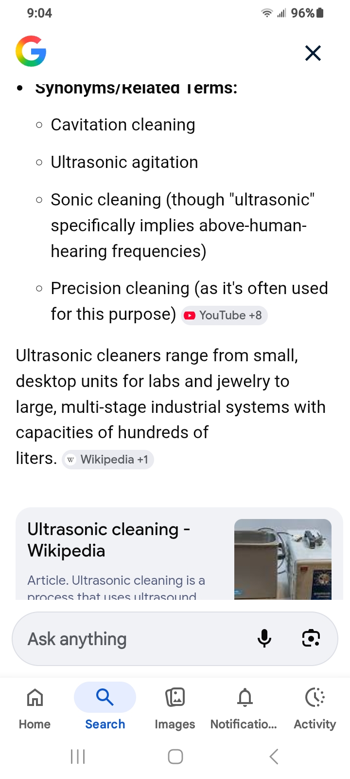

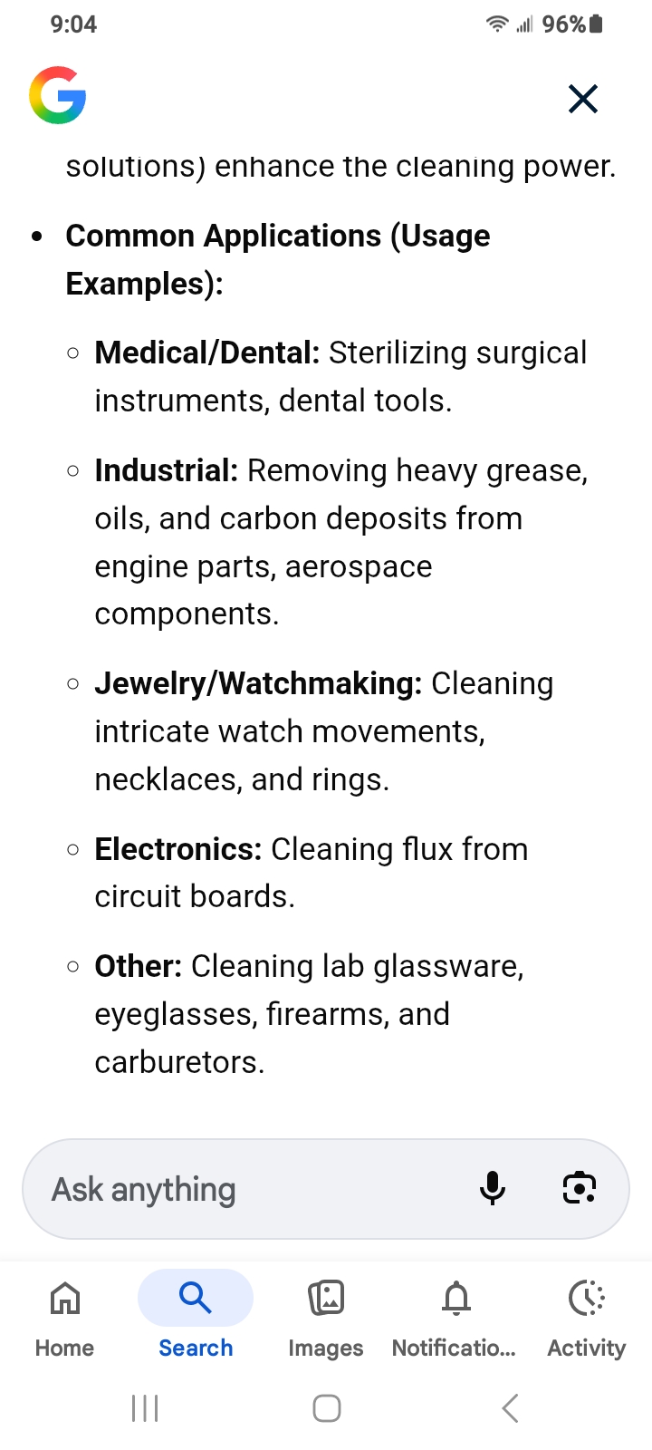

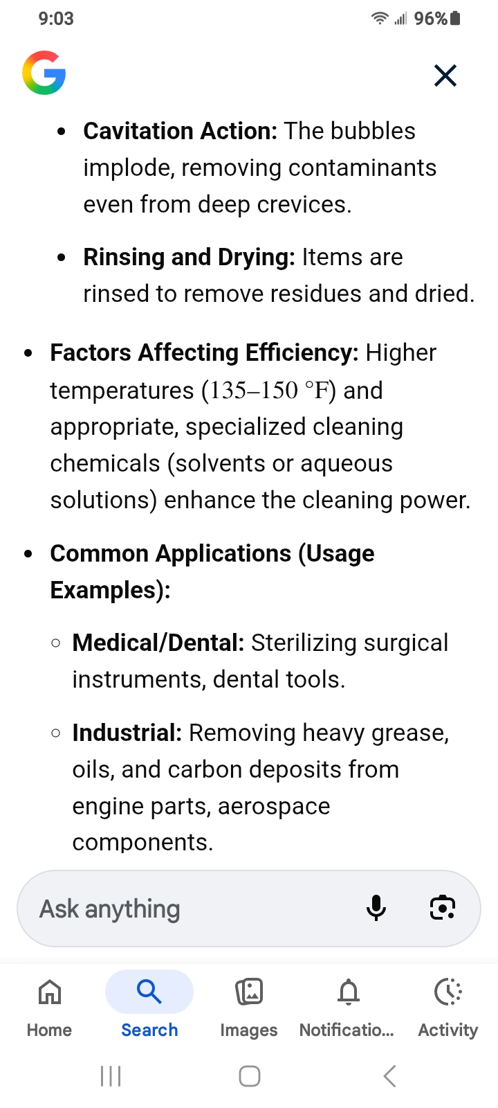

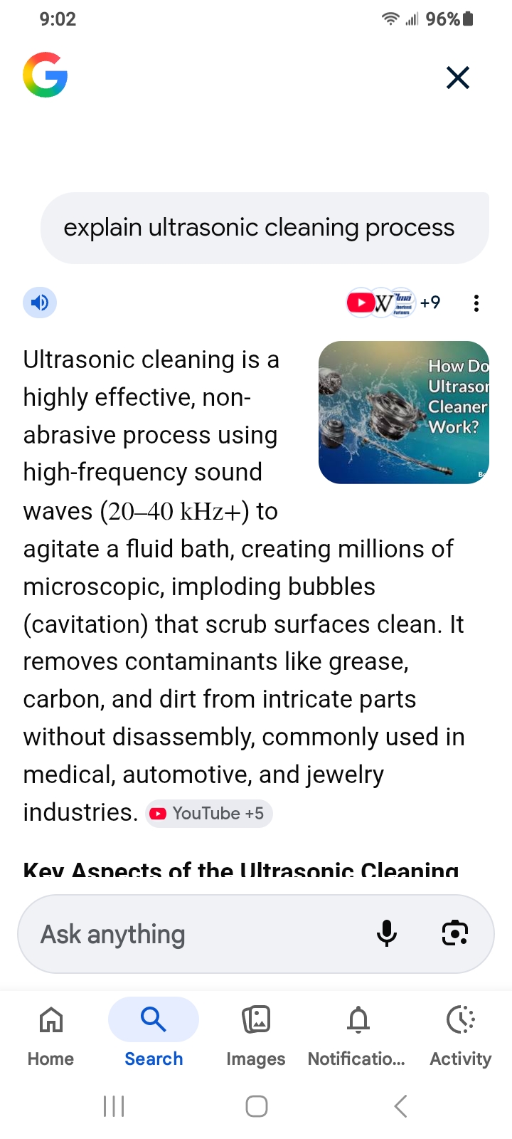

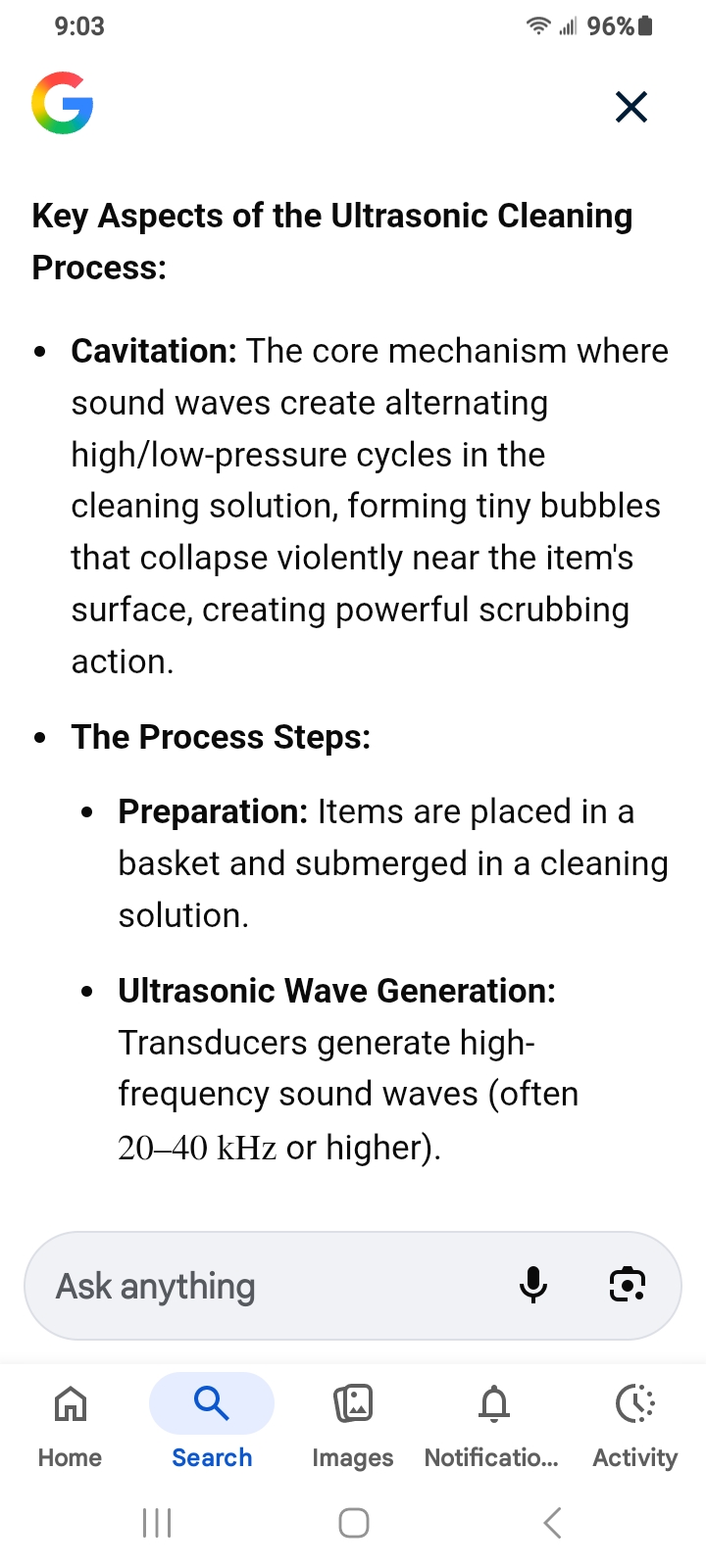

If you know what an ultrasonic jewelry cleaner is, what i have is an 8' 30 gallon ultrasonic jewelry cleaner. The front tank has the ultrasonic generator transducers the pink stuff is a mild detergent. The back tank is a rinse.
