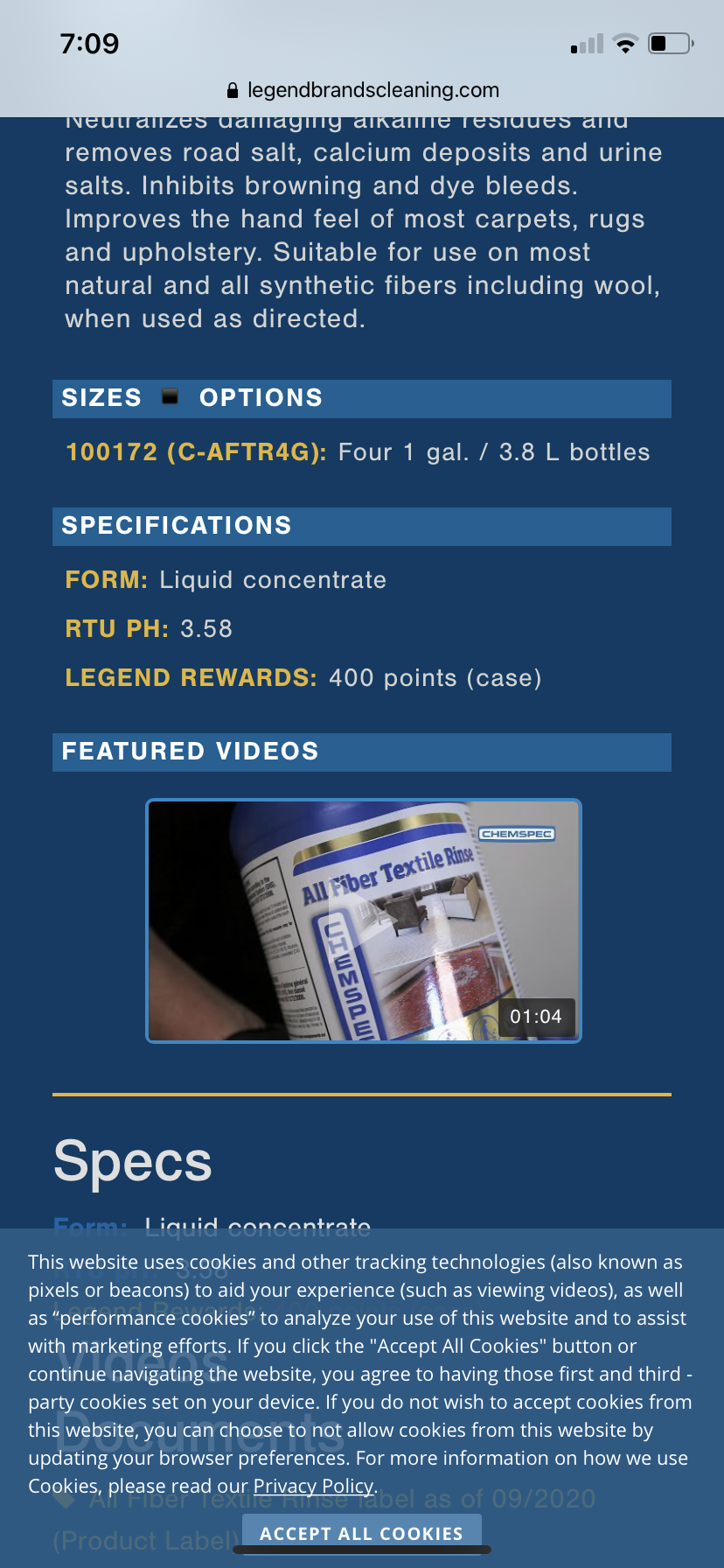

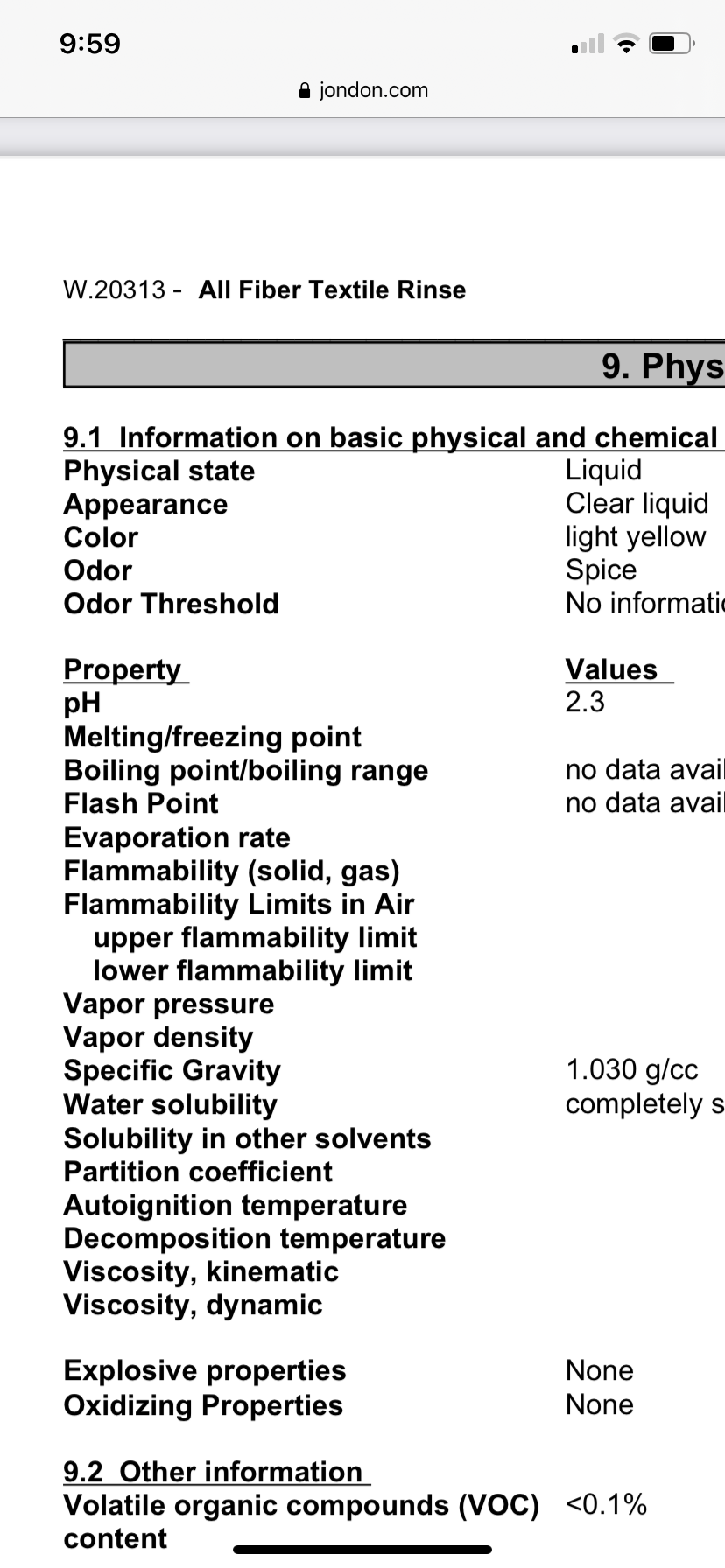

6,564
Not to split hairs...
BUT, undiluted; 2.3 ph
RTU; adding water increases the ph; 3.58 ph
Regardless, strong acid.
