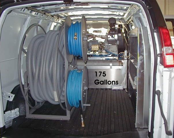

Daniel;
I would try to eliminate the 4 solution reels.
A good narrow triple reel (2 solution reels) is an alternative.
For additional cost, you could custom-make the triple reel to give you more floor space.
We like water tanks flat on the floor of the van. Here's a photo of TM w/2 water tanks & triple reel.
The two solution reels could be installed on the left side with a custom built support.
Larry

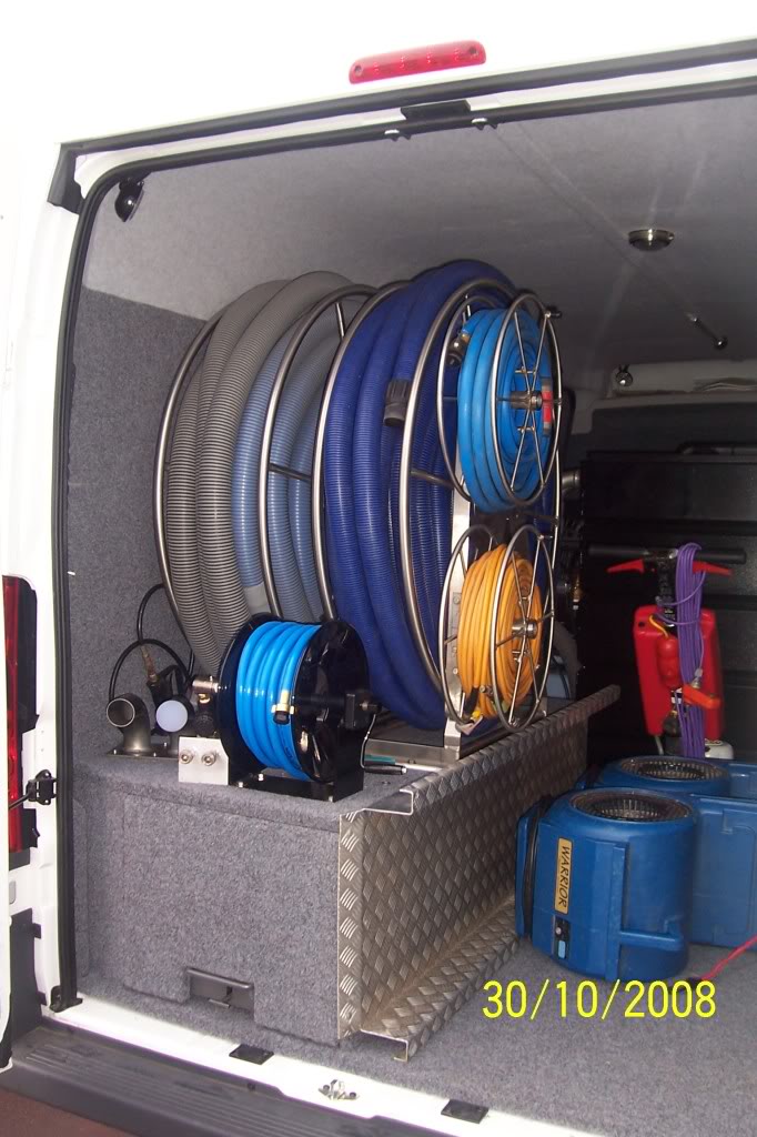

For guys who insist on rear mounting their reels (like in Larry's pic), I always liked the idea of a custom fabricated roof bracket that would allow you to flip the hose reel upside down and bolt it to the roof rails, this allows you to slide the reel over to the side about 6" and gets it off the floor, a win win if you ask me.
Anyone have Duane's mini-van pic of this?
We used to have the slide in rear mounted on the left over axle, and hose reel next to it (200' tall skinny) but sol. reels were a pita, but man did the extended van have loads of room in the side door! and it rode real nice.
