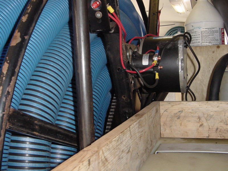

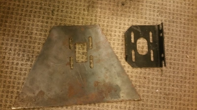

This was my take on what Keith did with the motor, sprokets & chain. It's a little hard to see but it is just 2 pieces of flat stock welded across the reel frame. 4 slightly elongated holes in the flat stock.

four slots and a larger hole for the motor shaft, we have 2 that are this way and 1 that is the way your is. We like the all welded bracket with slots to be much more rigid and not trouble free.
Justin's bracket is MUCH more solid than any other I've seen. I wanted to avoid any design that involved loosening the 4 motor bolts because of the billet they thread into. One big bolt locks it down after swiveling into place.

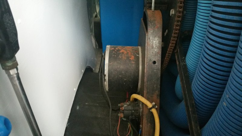

I have never touched those 4 bolts..
I don't like that the hoses will be dripping on the motor when it's raining or when dealing with snow..
Mine is all rusty, and it's higher and to the side..
