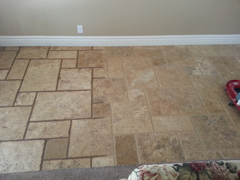

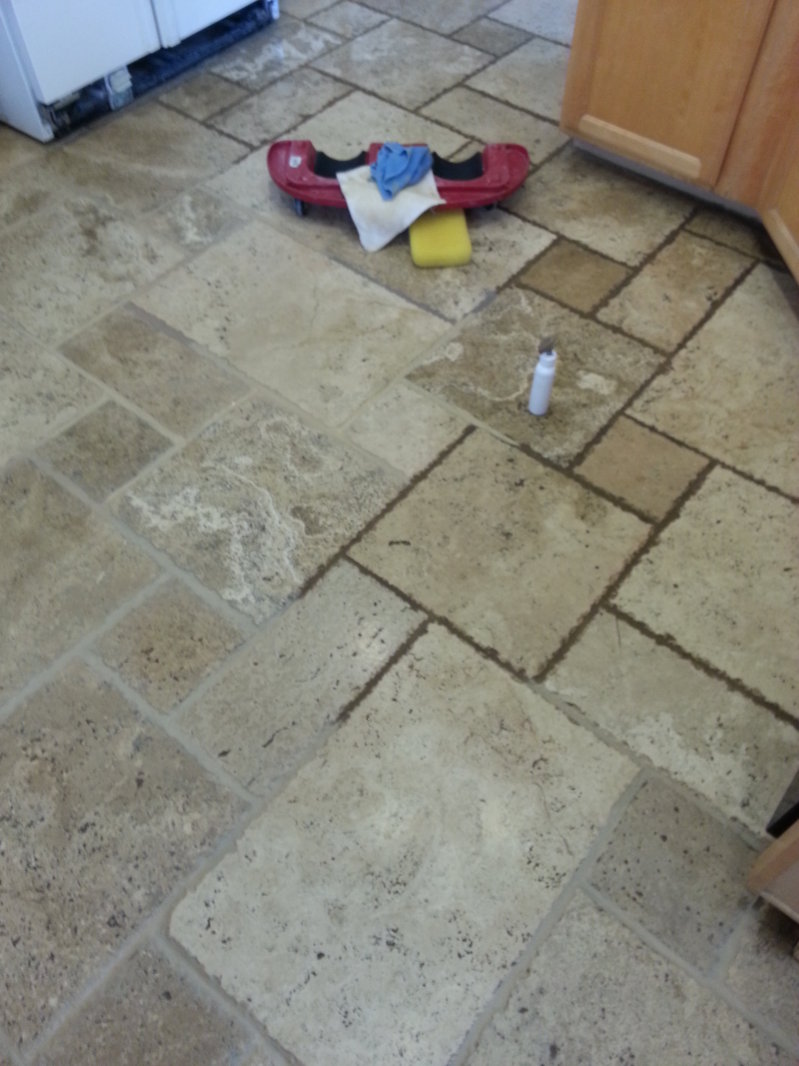

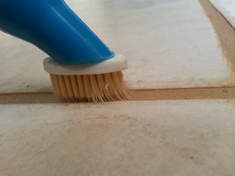

I started out with flex citrus and the ten inch crb. I swithed to the buffer and a carbide brush and got better results.
Went back with viper renew and worked the grout lines more and ran the buffer again.
Still had the topical aroind the edges but each pass got better.
I finally used some stripper and stiffer brushes. Its drying now.
Mike lol it looked clear to me.

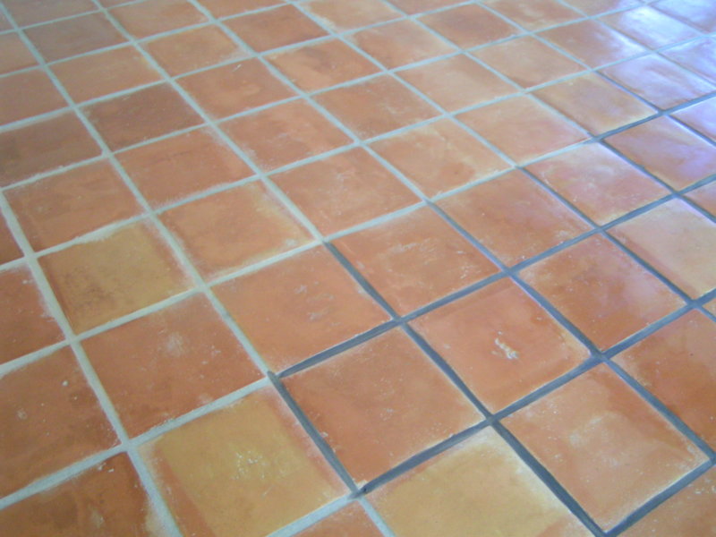

Steve, Consi der instead of working so hard to make porous previously stained grout to look brand new you will find much better result and far better protection from color sealing the grout. Using penetrating sealers will only reduce porosity for future spills etc. If you apply a coating that makes the grout uniform in color, stops porosity and keeps soils from getting trapped in the sandy texture of the grout you'll never have to do a restorative cleaning again. I do these kinds of jobs every day and make a lot more income than cleaning carpet.

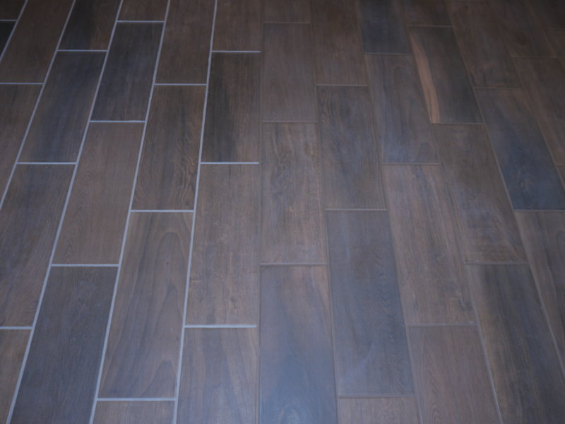

I use a product that is quite tenacious and has not failed on the thousands of jobs I've sealed over 18 years now. It looks natural as well without looking "painted".20140922_092135.jpg P1020361.JPGAdd or reduce character.jpg Stripping whitewash7.JPG

Im not an expert but I assume mop n glo. It had that caramel coloring and was hard like acrylic.
The stripper I used worked best. The grout lines are not as bright as id like but I dont want to color seal it.
I sealed the grout already and put the baseboards back on. Its not perfect but wayyyy better than it was. Ill tackle it again next winter or cover it with the LVT ive put in the other rooms.
I realize now I like carpet cleaning better lol. Ill take on some tile jobs but ill be picky.
