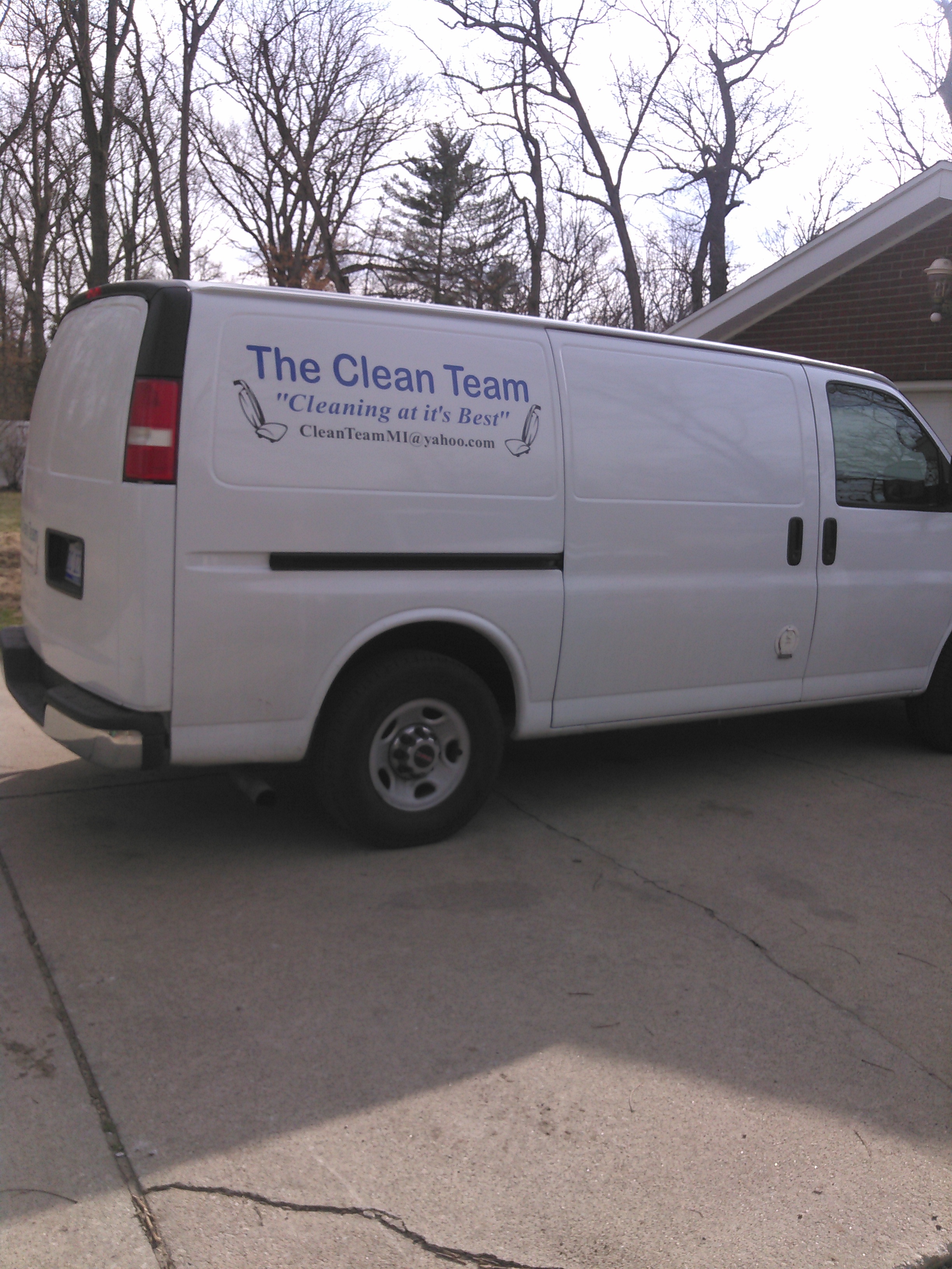

13,372
Got the butler lettered today! Maybe I'll start using it next week. Ran the WM about 7hours today. It's going to be hard to give up. Already thinking about the next TM.

13,372
im pretty happy with how it turned out. Time to put it into action.
