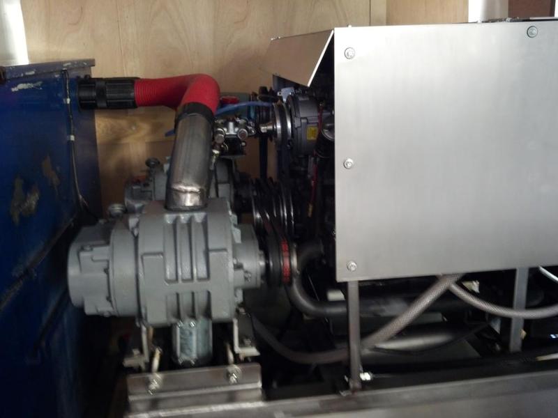

Ok got my throttle worked out today. I am really starting to realize why most TM's are in the 330 cfm of less.
This was my set up 2 12 foot 2.5 hoses to back of Devastator no filter just using it for Y. Then out of the front or Job side 25 feet of 2.5 hose at that point took cfm test to see 485 cfm truck mount was at 8 HG's
The minute I hooked ANY amount of 2.0 hose the HG's would climb to 13 HG's and due to the fact that I am running a vacuum governor and have it set to max my TM at 3000 rpms so as the HG's increase so does the throttle just like it is designed to do but it will not drop back down due to the amount of HG's created by the restriction of the 2.0 hose.
I finally got some decrease when I when down to a 12.5 whip of 2.0
I don't think it would be any different on a PC Ev or any TM with 5.9 blower due to the fact there governor works off of load the 2.0 would still create HG's and thus a load and increase the throttle so is the vac relief on them just opening to bypass the restriction of the 2.0 hose or what.
What I can tell you is I have never seen a vac gauge move so fast in my life I mean it is instant from 5 to 13 in less than a blink and it is pegged
What is some of your guys experience on this with bigger TM's is it just that with bigger blowers you just have NO LAG time when you set your wand down its at max vac as soon as the wand stroke starts ?
I can tell you for sure I will have no problem with heat as the exhaust is very very hot compared to my legend with it 20 hp any input would be great.
I just don't see how guys are getting 500+ cfm out of a 2.0 hose from what I saw today it is to restrictive

With my legend I have to wait for it to create max vac where as the vwtm the hose is already loaded it this how larger TM's work. As you can see this is puzzling me.
Also with my PC on some carpet it doesn't get as good of lift, I am thinking with the vw it's not going to matter what carpet it will always reach max lift.
Is this the case or am I missing something?

If your running straight if the blowers... Then that's why.
Or do you have a vacuum tank ?
Size of tank equals buffer time
Also, I think to a degree, the bowers are also fighting each other for air, so quicker peg.

I have it hooked to waste tank, granted it is small, I guess I will go and get the larger one I think 120 gallon. I do understand that as far as size goes.
As far as blowers fighting each other they are they are plumbed to the top of the center of the waste tank lid and within 4" of each other for there intake. My plan is to make a intake filter housing that will hold the two intake filter to protect the blowers that we will bolt or weld to the lid this should make the two work totally together in removing air from tank, the 2 2.5 ports for hoses to front of machine are one on each side of tank that come out to front of TM one on each side as strait as possible.

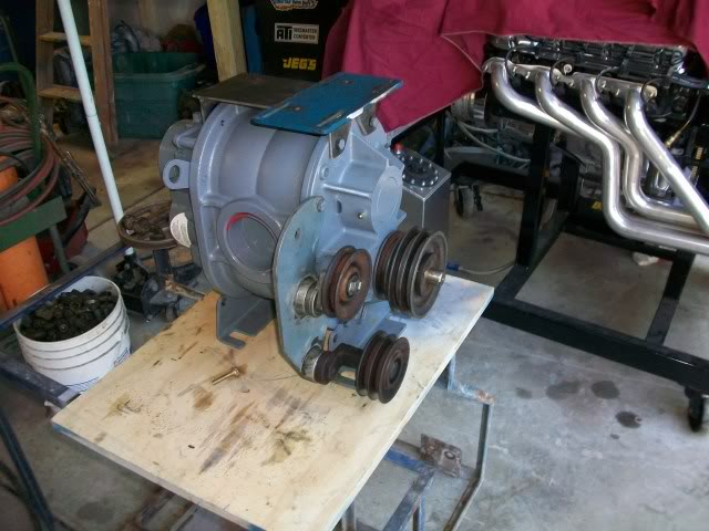

It is coming together pretty good so far if I do another one I will go direct drive 5.9 blower
VW's are a faily cheap HP rated motor. The guy that is giving me a little advice used them in Napa Ca for the wine vineyards as wind machines to keep the frost away, said they are still running today @10 years

Sounds like it boggs down too much when you cuff the hose, you have a relief valve on the blower?

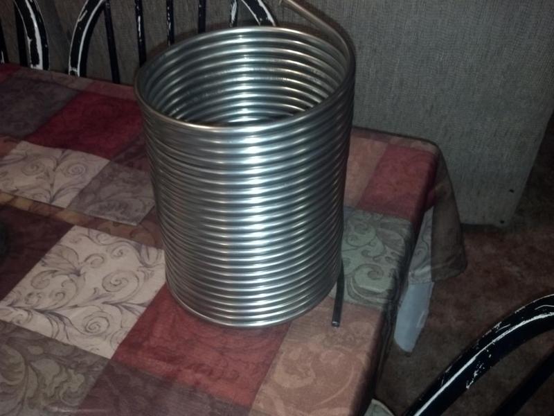

Well I just did my 10th job with VWTM and it is working pretty dang good so far. We are going to start on the HX next I ordered some ss coil to see if we could coil it okay and damit I should have ordered all of it as it as our test coil came out awesome took about 3 minutes to coil it. It is so tight you can pick it up and it stays wound cant wait. Talked to Ben at Amtex about the type of work I do and flow I use to come up with a total amount of coils to hold 200 220 continuous can't wait

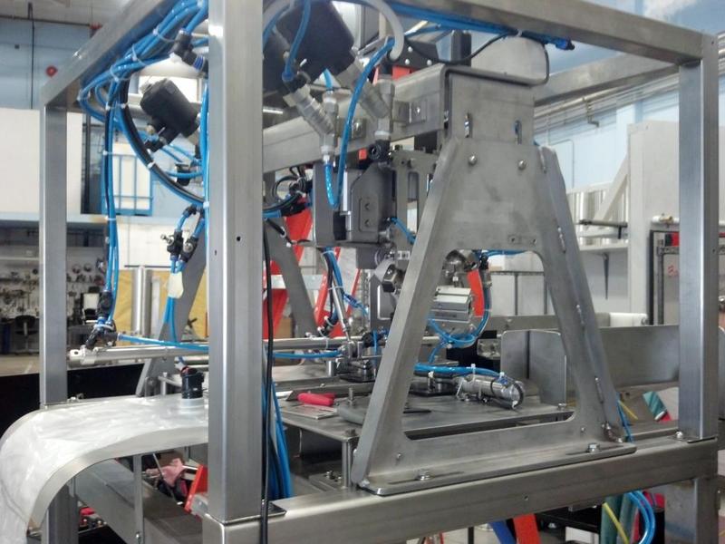

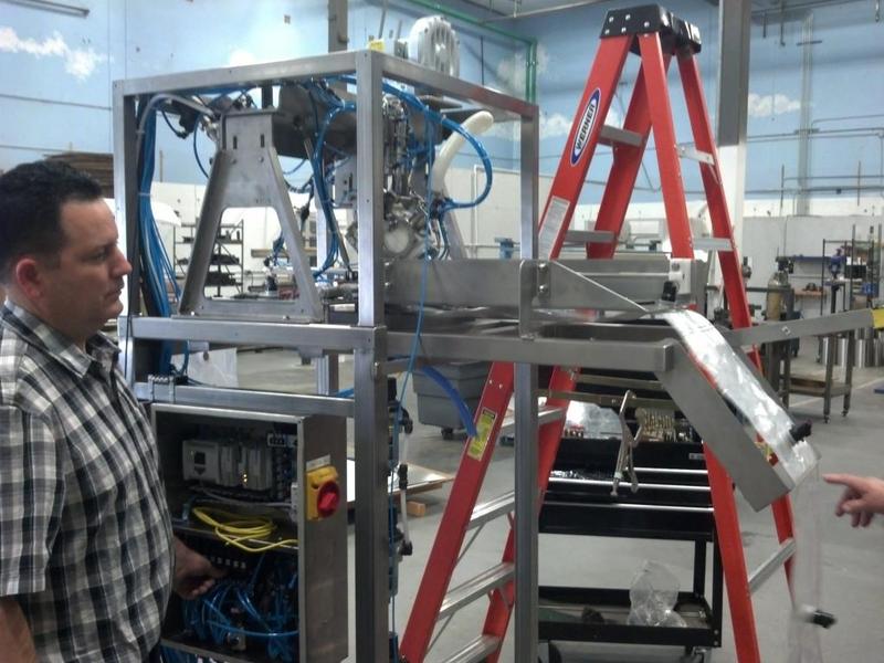

My fabricator Tim is in the wine industry and he makes the machines for bag n box wine here is a pic of what he designs from scratch. The machine you see here is about $95,000 project.
He also has contracts in the solar power industry for newer homes being setup with solar power they run 24 hrs a day producing parts for solar. What is really cool is he is excited about making stuff for us in the cc industry to. I came to meet him when my shop was across from him back when I first started with the filters, he came over and asked me how I was molding my parts as he was looking for a way to cast a piece for his wine keg. I gave him a couple gallons to try. His keg is now a patented product and he sells them all over the world.
Tim and his crew turn out some unbelievable pieces of equipment all out of SS

What did SS tube cost you, what psi does it hold?
Are you welding the coil together so it dosnt vibrate holes into itself?
The one jonh, butler uses a apparatus to keep that from happening
I thinks the tube in she'll is more efficient and compact however.

Nice job on the coil. I plan to do the same in copper tube, did you have to use a pipe bender, or just roll by hand.
We actually used a piece of pipe but we put pipe on a lathe, attached tube to the pipe and Tim slowly turned the lathe, after a few coils we were both pulling against the lathe Tim guided the coil and pulled while I pulled against it as hard as I could, you want to stretch it as much as possible because it does have some spring back if you don't we got about 1/2" when we took it off the pipe. This one came out very good because you can pull on each end and it will snap back into shape.
Copper will bend a little easier
The SS tubing we used is .20 wall it will hold 1600 + psi and that is plenty for me, If I were to make them to sell I would go with a bit heavier gauge 2000 + psi to be safe
Yes we are going to weld braces to the coil when we finish and space them so the heat can go all around each coil.

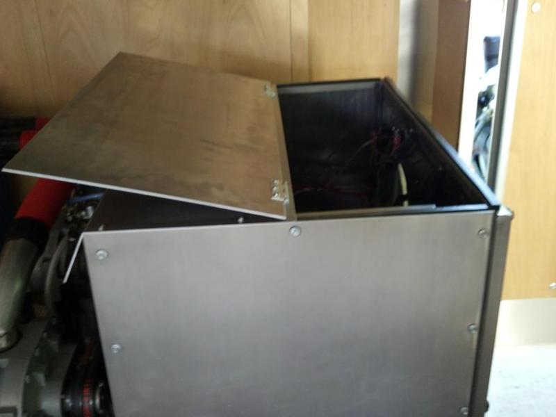

Did a little work today on the VWTM
I made my top cover and while I was at it I thought I would take advantage of the extra air my electric fan is producing. It feeds fresh air to the vw fan. So I shaped the top to angle down and amazingly the extra air now blows down over the belts to help keep them a little cooler.
Added top hatch access

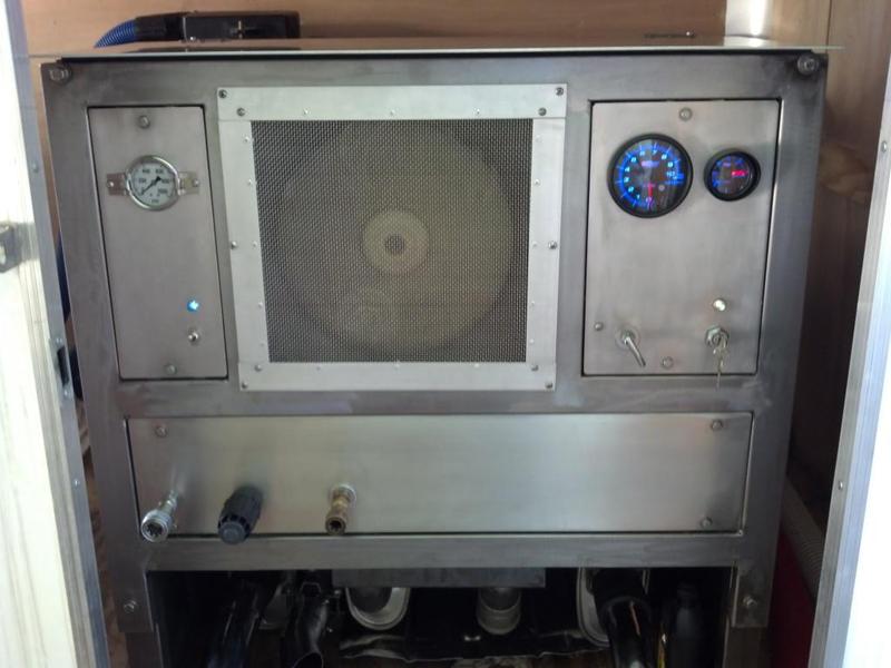

And fixed my fan so my wife would stop worrying about some kid sticking his winky in the fan. Oh and added a cool blue light for my pump on indicator

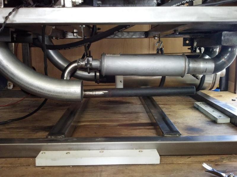

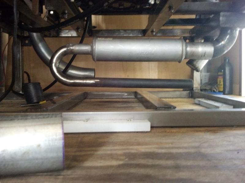

Well I have been working with my VWTM and it has been doing really well but it was way to loud using auto mufflers for the blowers, when you pull the throttle for the big cfm it would get crazy loud. So I was sitting here the other night and my old dirt bike days came back to me, we had silencers on our dirt bikes and when they would get gummed up from the 2 stroke oil we would repack them with new baffle material, got me thinking so we had @ 5 Dev's that we first made and dumped the design sitting up at the shop.
So here is what I did today
Got rid of the over sized car muffler and went with a tractor muffler for the vw, much smaller and flows plenty for the engine
Next I set up the right blower with a new metal 2.5 90* nice and smooth to the silencer
After bolting vw muffler on it is time to get the left blower plumed with a nice metal 2.5 90*
After I got them hung it is time to see if it made a difference... Holy crap I can't believe how quiet she is now, I can pull the gas and get my 5 2 door Y to whistle from the cfm and walk 25 feet away and you can just barely hear her running

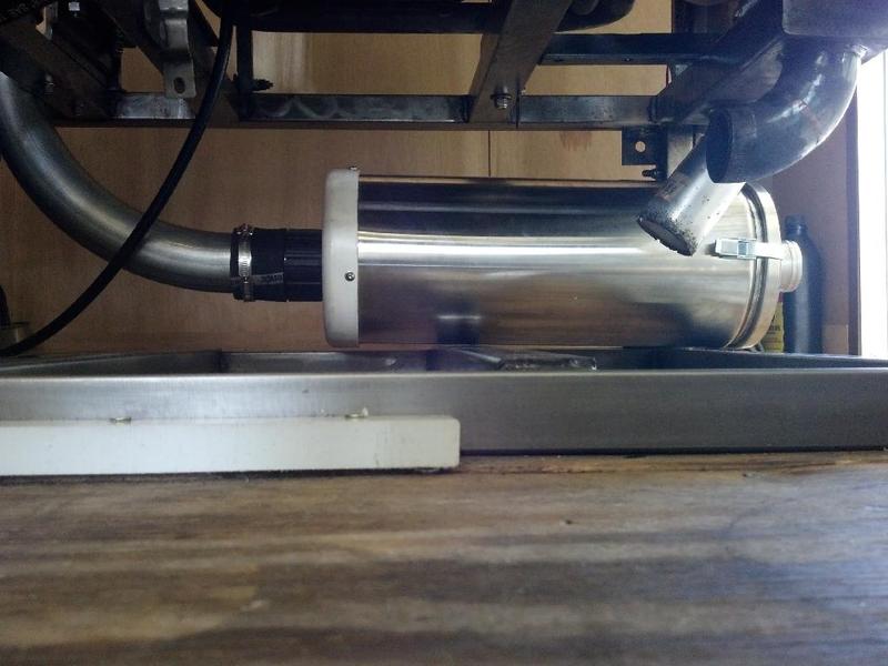

What did you use to pack the silencers?
These blowers are NOT hooked to any engine exhaust so no water vapor from engine warm up so I used fiberglass with ss mesh tube going from back port to front port 3" diam. so no restriction
