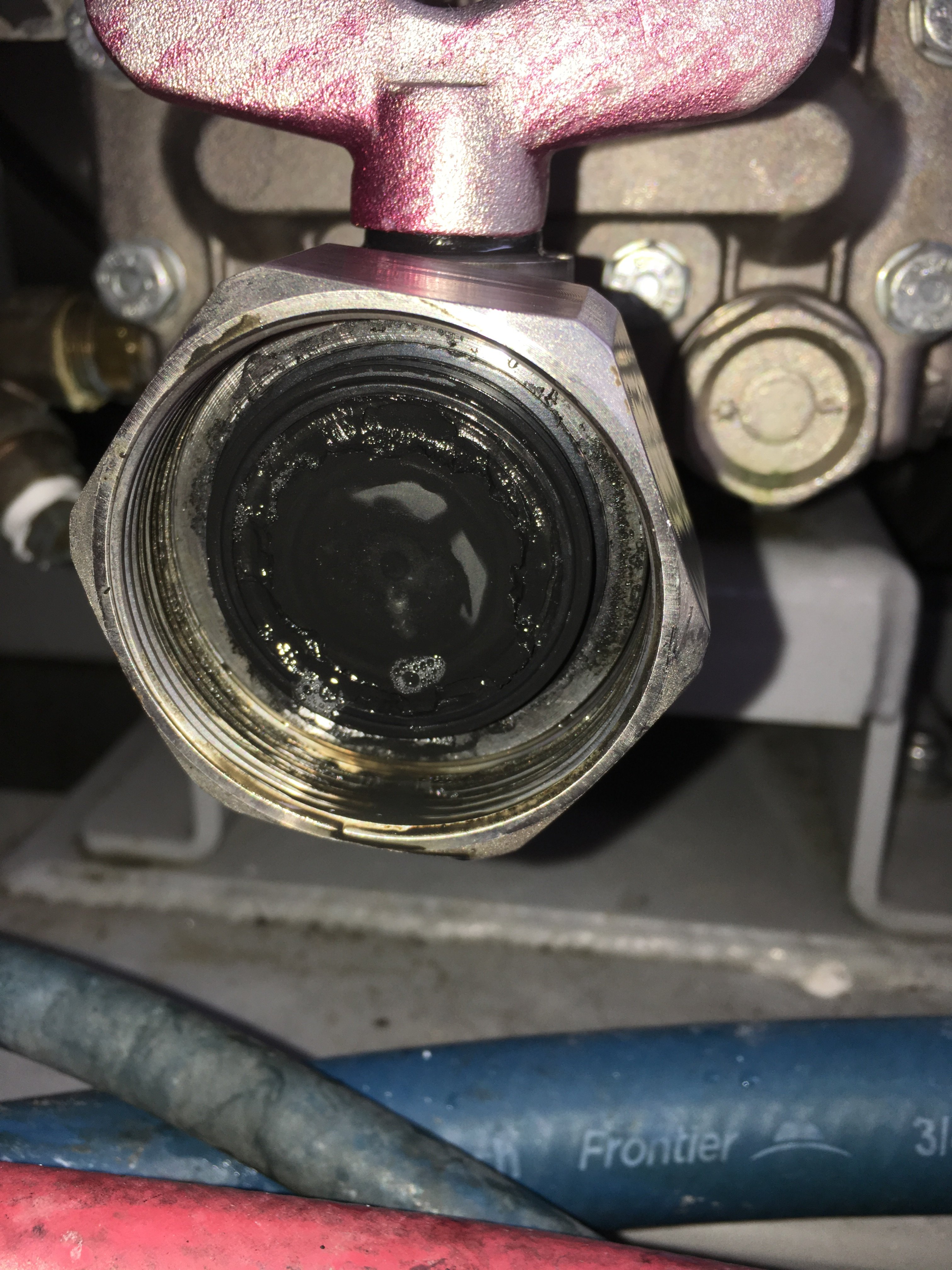

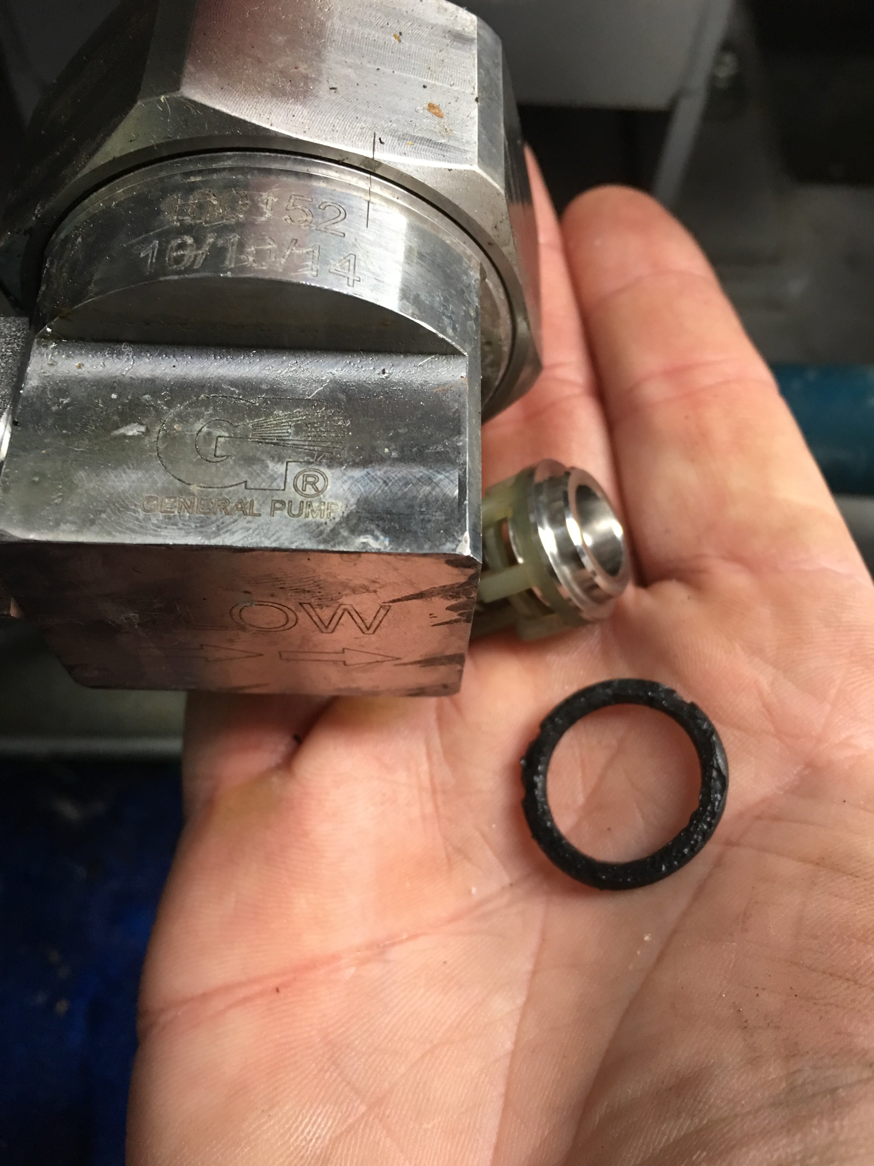

Looks like the O Ring on the high pressure side is chewed up. I’ll flip it around and get through this job.

I guess I got lucky being able to pull out one last job with that ORing. When I took it out to replace it, it fell apart into 5 pieces. It served me well.

@Jim Martin, after looking at the diagram you posted, I am missing one Oring completely. The low pressure side is totally dissolved. Glad I bought a few extras. This was my first time getting into one of these pumps. I appreciate the help.

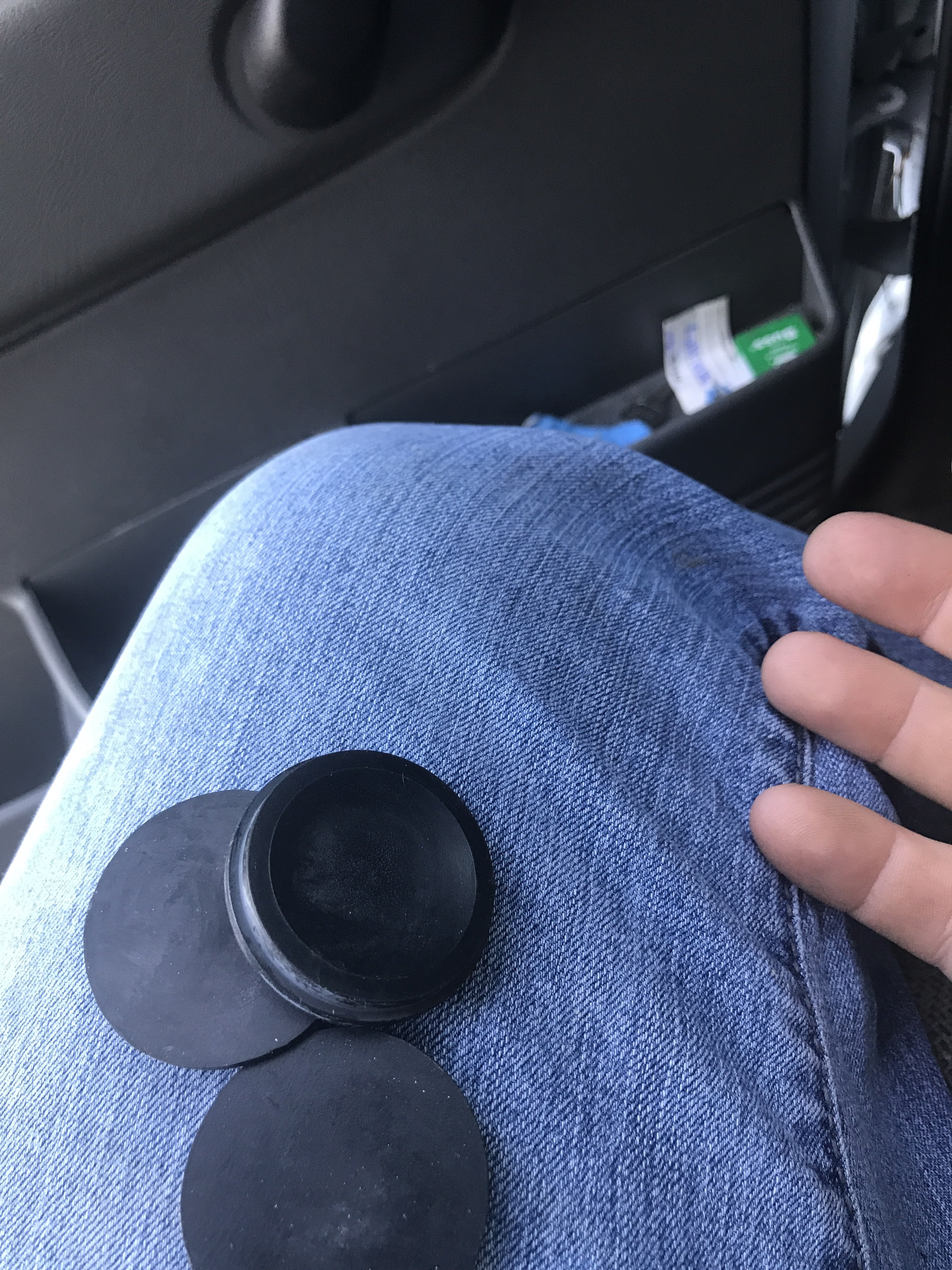

Damn guys. I decided to check my diaphragm tonsee how it looks. It looked a little roaches and about to go out. I got 1400 hours out of this thing so I can’t complain. Glad I ordered a new one last night. It’s still working but looks like it could give up any minute.
I put it back together and now its not working again! Ugh! I think I also crushed a check valve plastic housing when putting it back together. I think they are okay because they passed the suck test. Going to see if I can get new parts today.
I just ordered a check valve kit. $34 and $22 two-day shipping. My local guy only has the diaphragm without the lip. I'm going to try tha until my new one arrives. I should have never taken it apart to check it!
