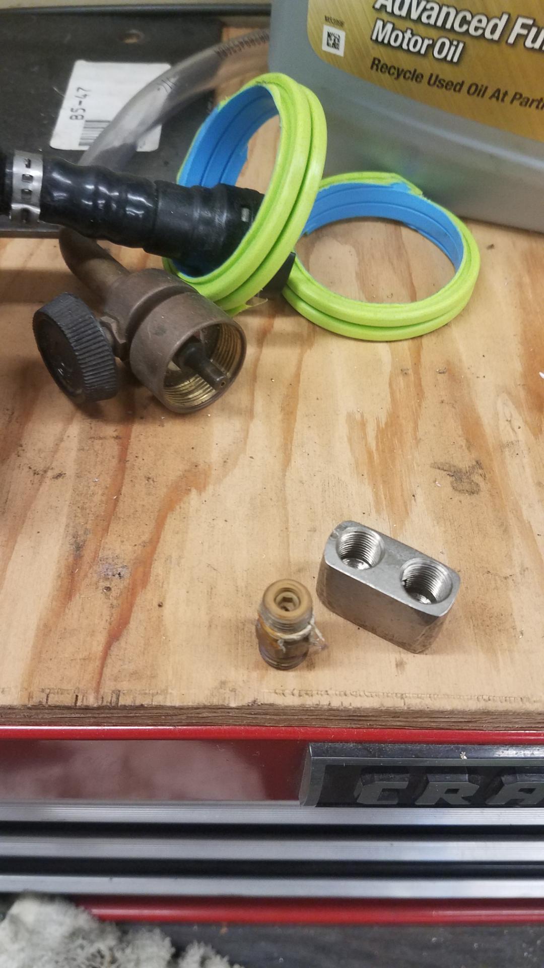

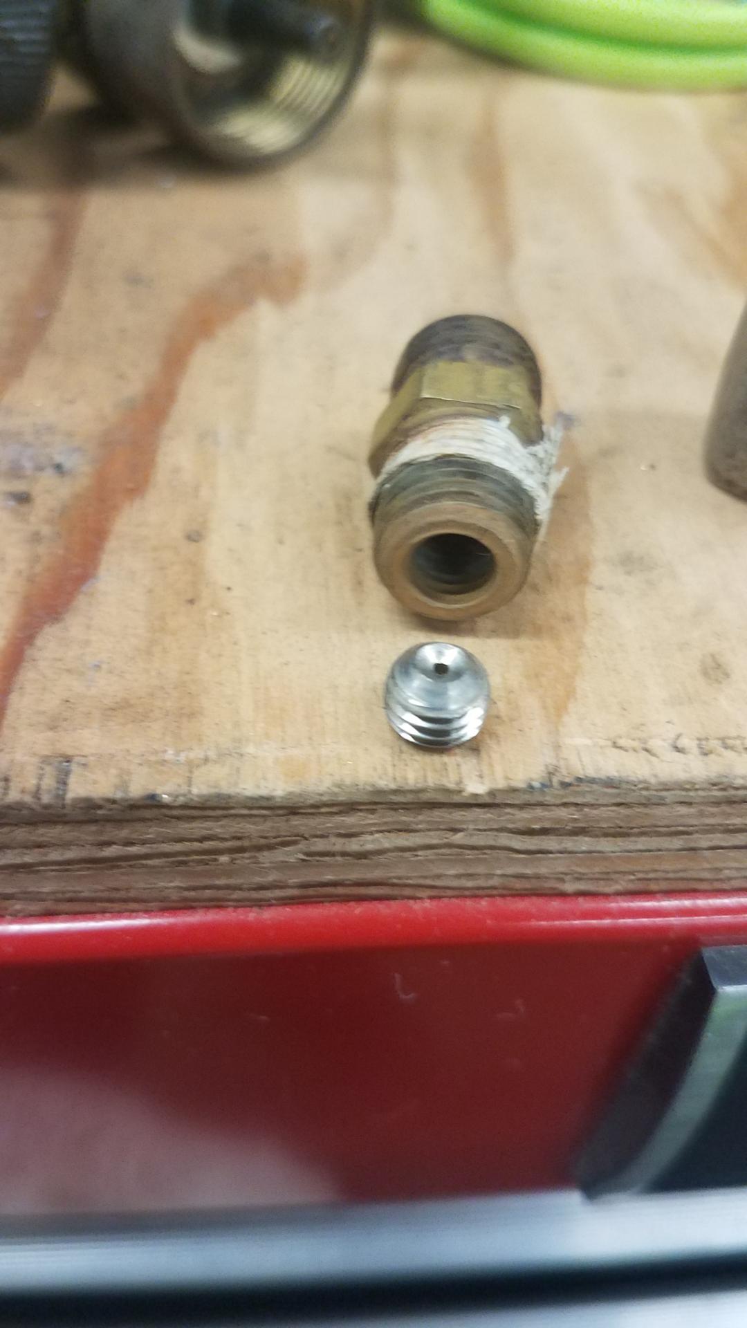

SmokinI like the prochem tool with 1 modification i installed a modified kleanrite bypass inside the vacuum hose to keep the solution hot. the standard bypass on the tool only bypasses while spraying, i use it to control flow and my bypass modification keeps solution temperature up when tool isn't spraying
View attachment 120130 View attachment 120131 View attachment 120132
