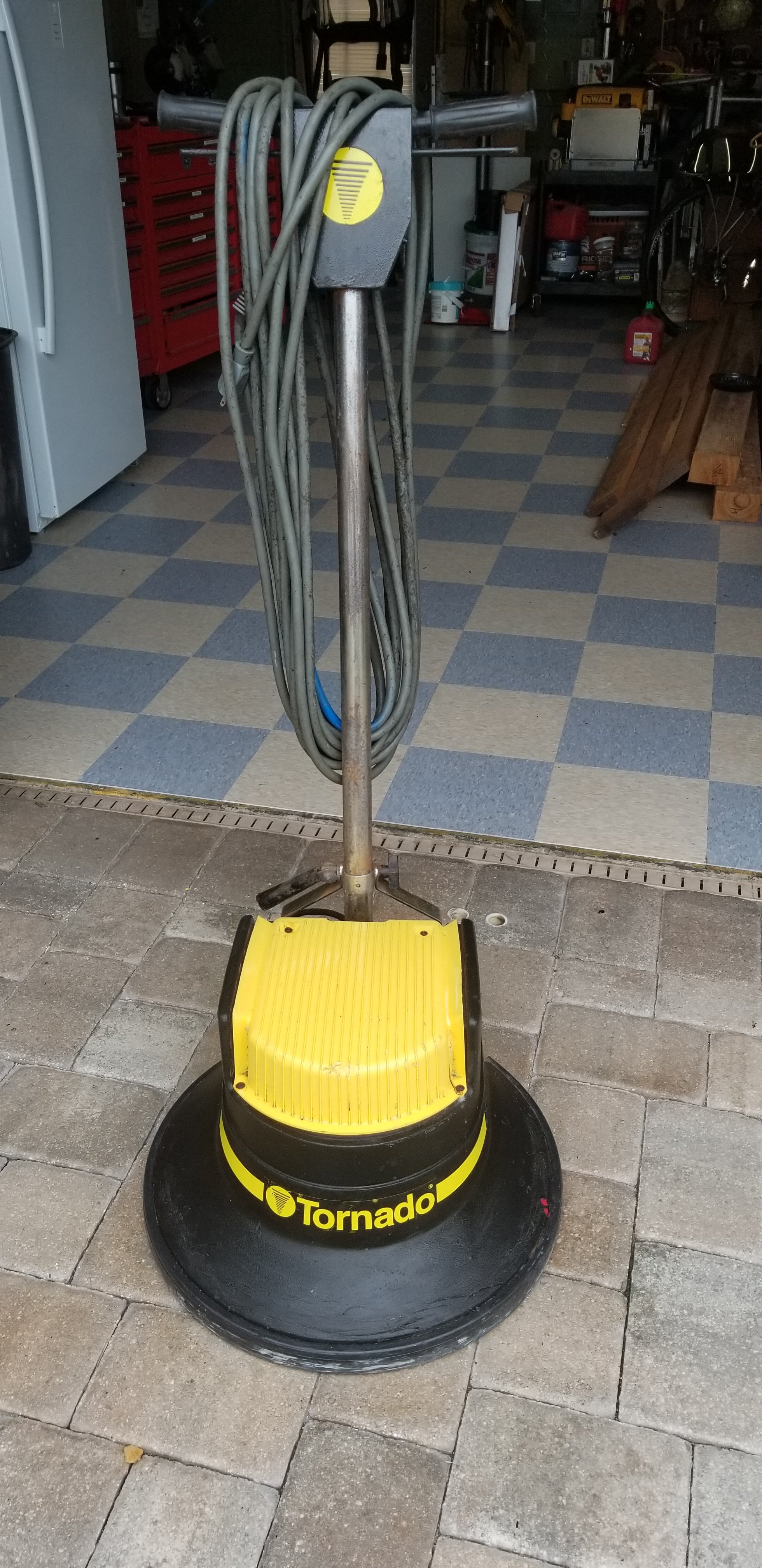

Hey All,
I was finally able to contact the guy with the Tornado and picked it up just now. I now have come across another person that has 5 5Gal containers of GEMSTAR Stratus. He said he's " looking to get" $80 for the lot of 5.

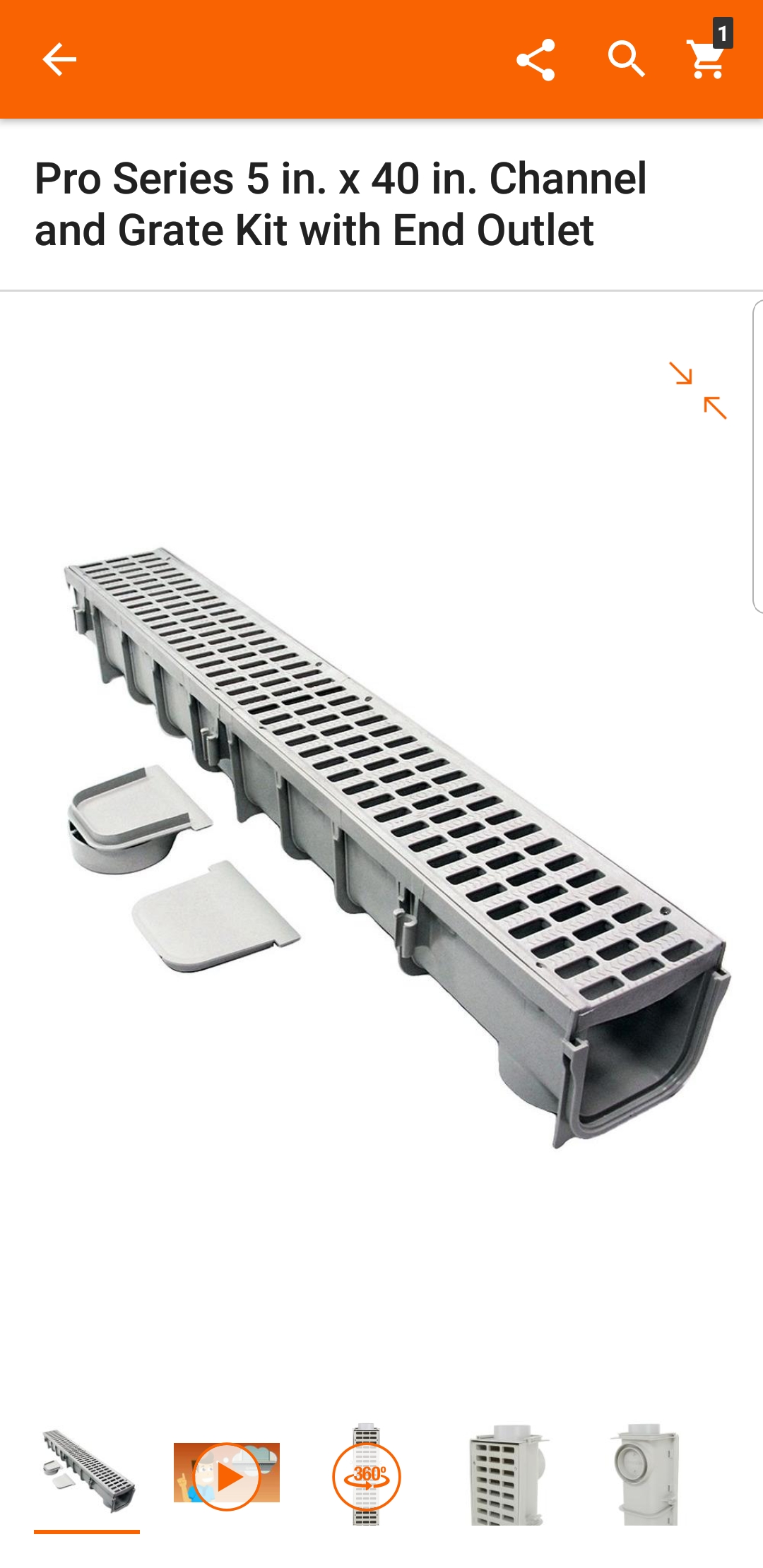

You'll notice that I haven't finished of the front edge of the VCT yet, Because my paver guys weren't paying attention to the pictures that I gave them as to the type of drainage system I wanted. I'm going to replace the cheap plastic one thats there and upgrade it to a larger one, so that it an be properly cleaned when need be

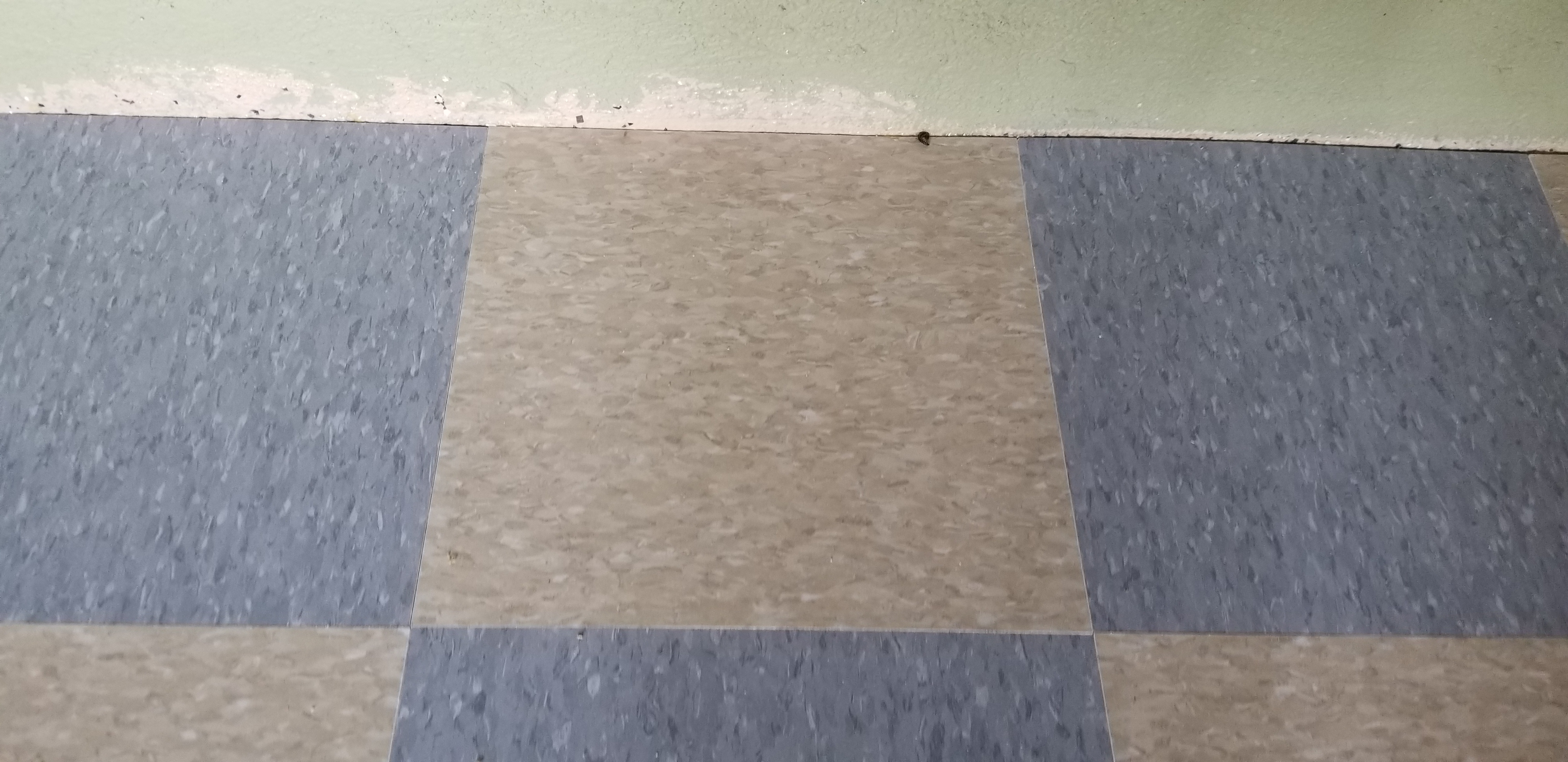

Being that I haven't yet decided yet if I'm going to use a rubber cove base, would it be a good idea to squeeze a bead of silicone around the perimeter?
I would cut at least a half inch of that sheet rock off all the way around. Before installing the cove base.

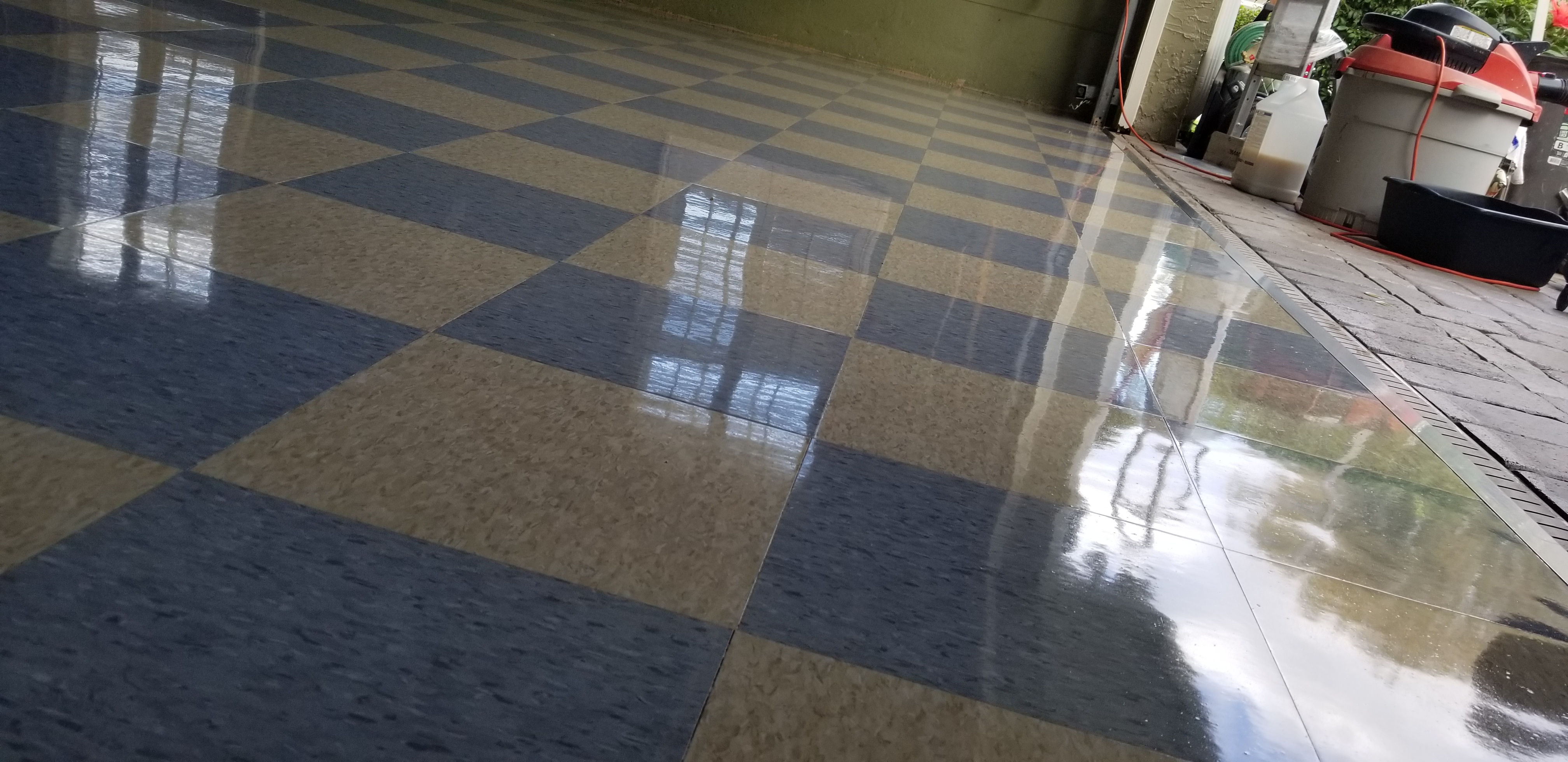

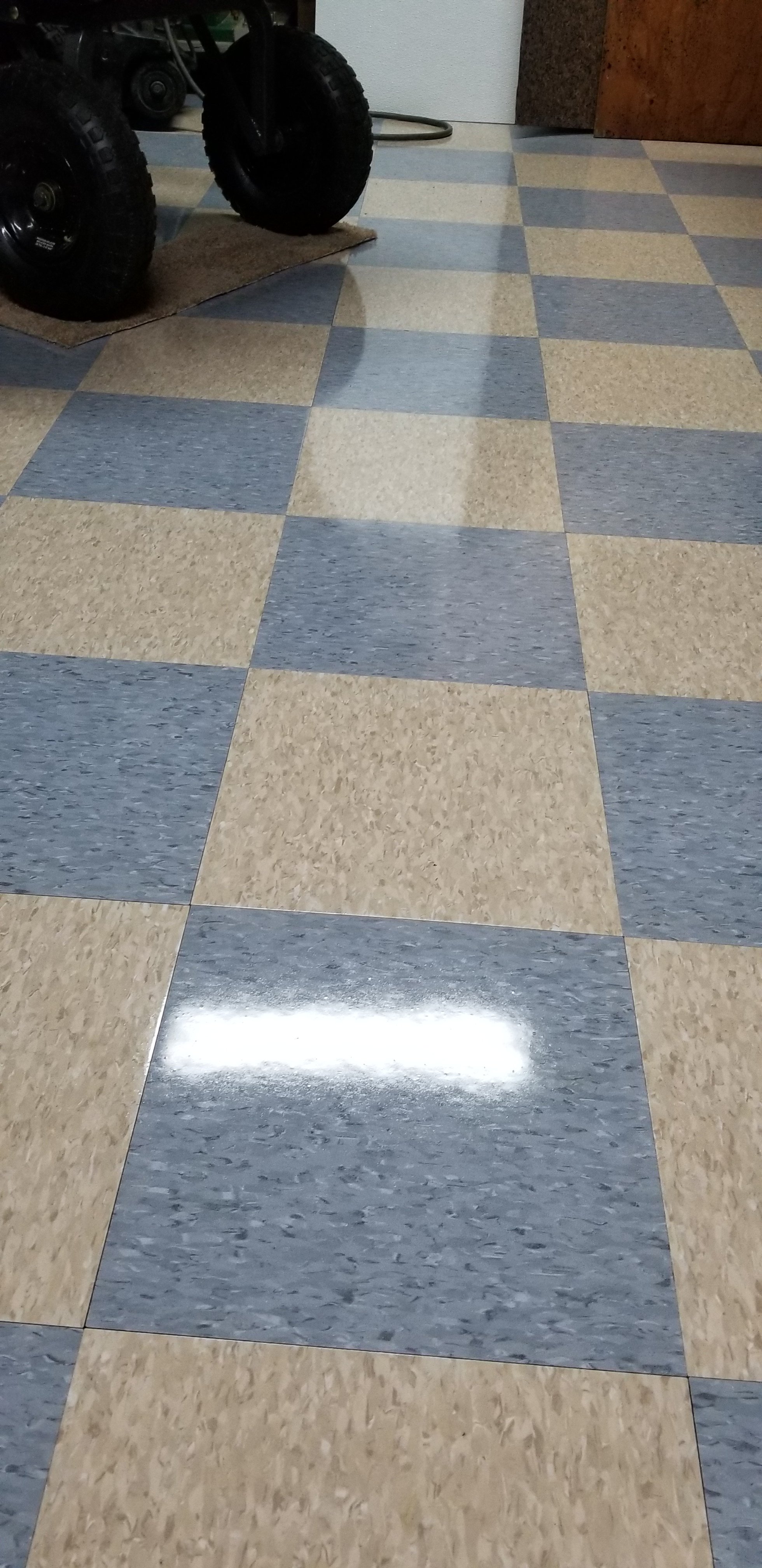

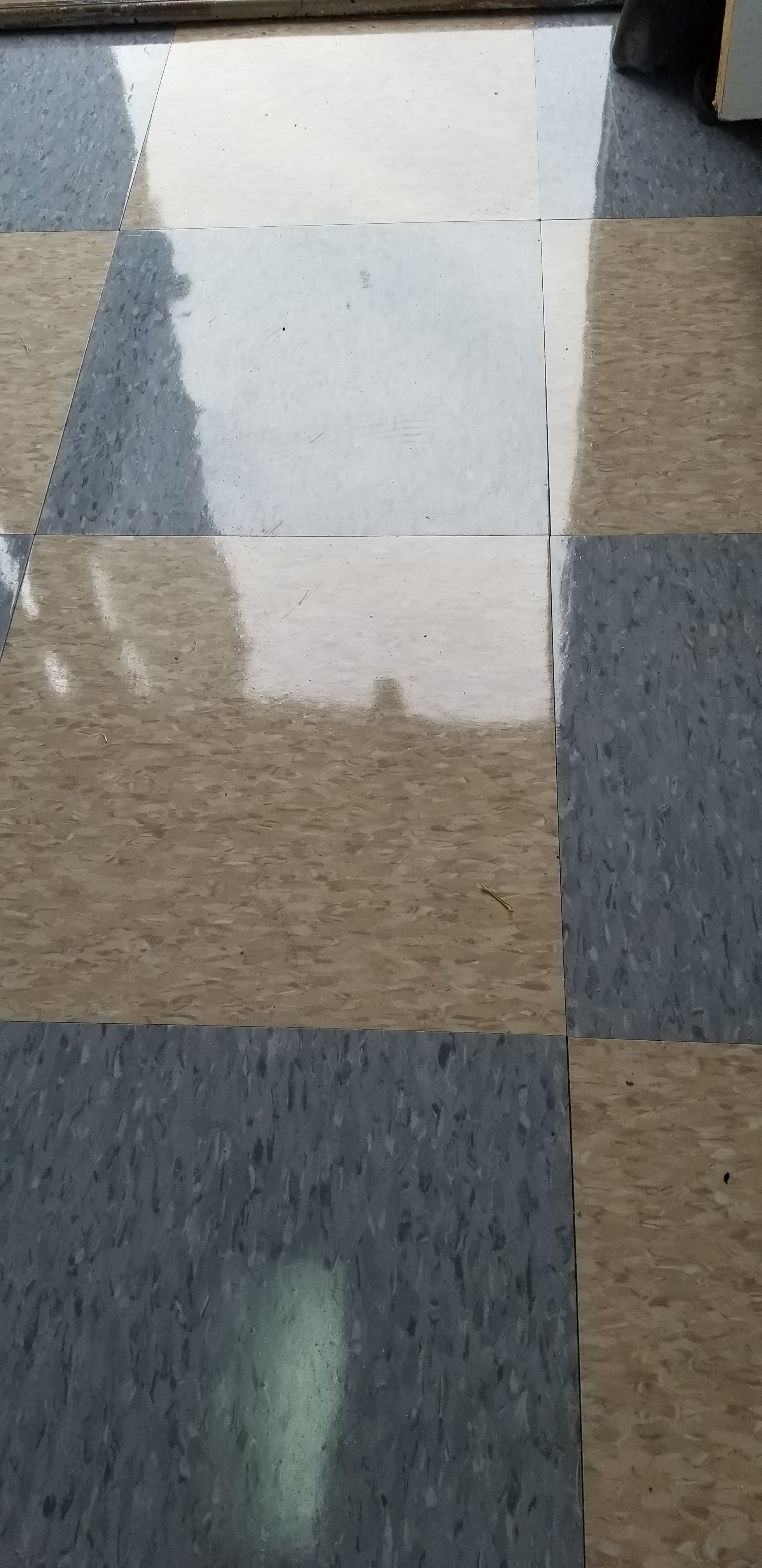

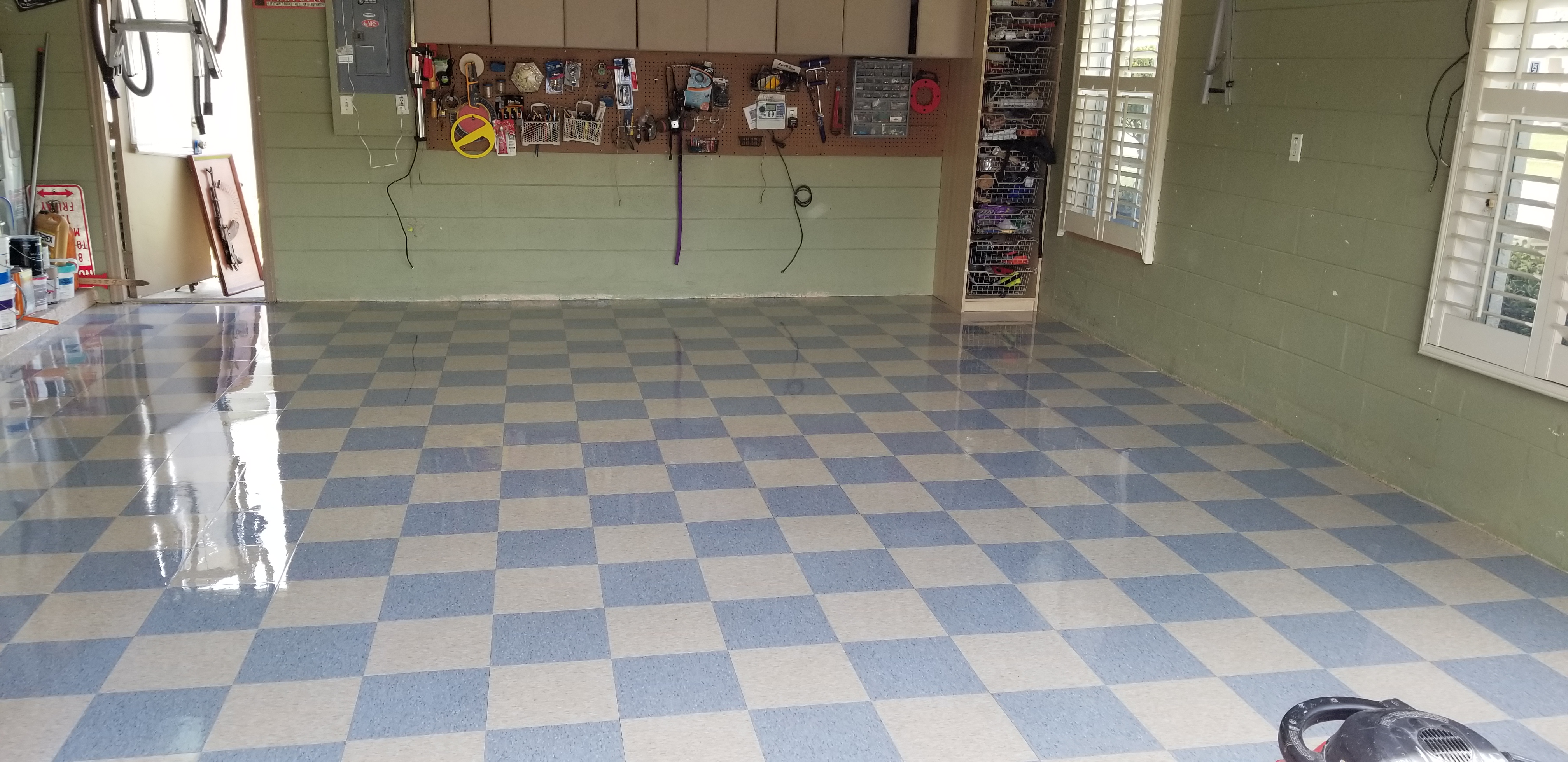

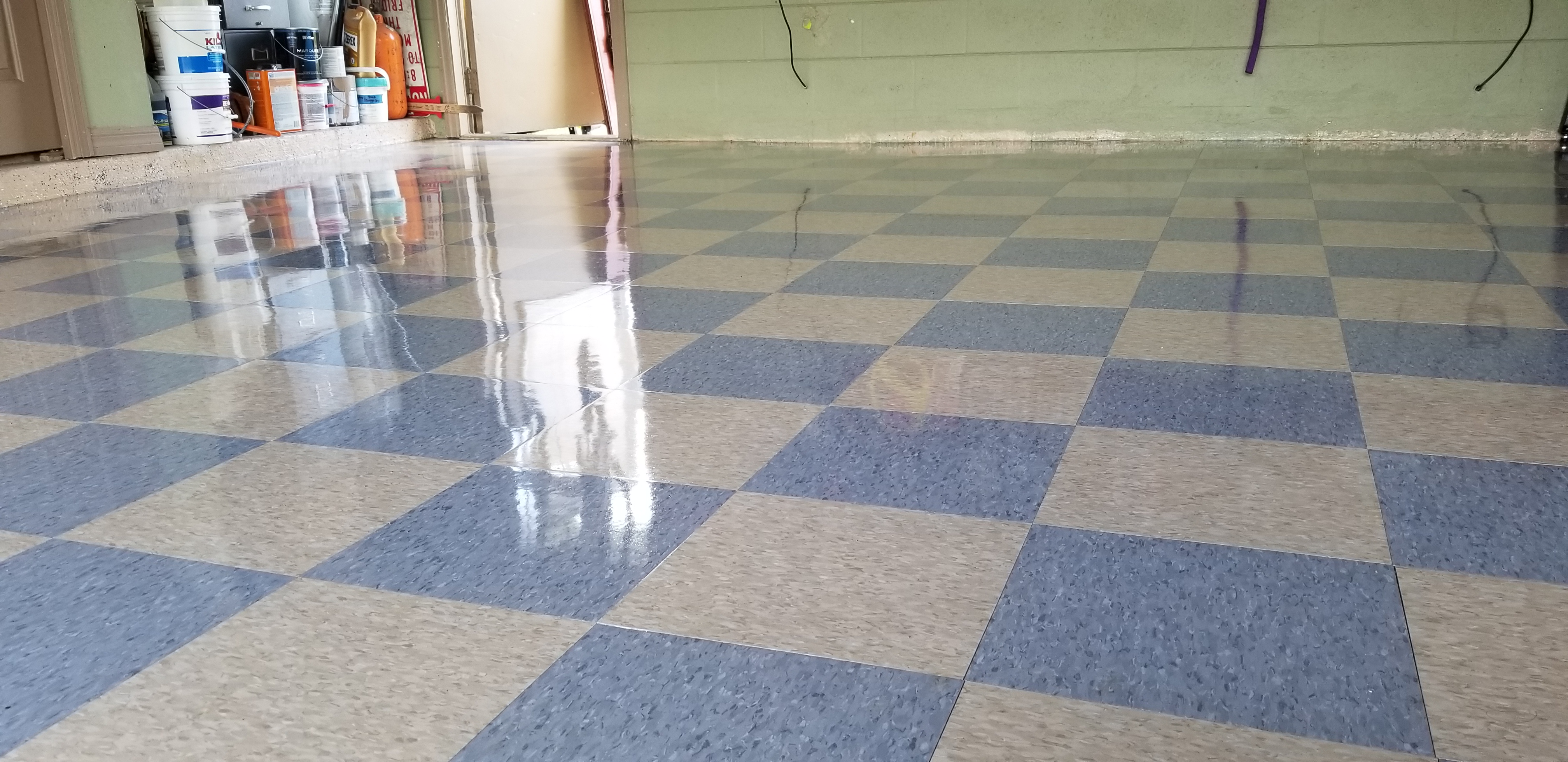

I was finally able to find the time to apply my floor finish.
What a big PIA moving everything around.. Anyways, Here's how she came out with 4 coats. Im thinking for a NFG it's "Good Enough" lol for my purposes!!
Thanks again for all your help and advice.

I do what I call "2 past awesome" which equals six coats of finish, here is why. The first 2 coats of finish you apply are to protect the tile, that is the main purpose of putting finish on VCT. Coats 3 and 4 will give you an awesome shine like your floor looks. Coats 5 and 6 are applied to protect your awesome shine, thus "2 past awesome"

Andy,
I really wanted to, however i was fighting potential rain and daylight, then having to bring everything back inside again.
Question:
Can i apply additional coats, by moving half shit to one side and then coating, then after it dries, do other side?

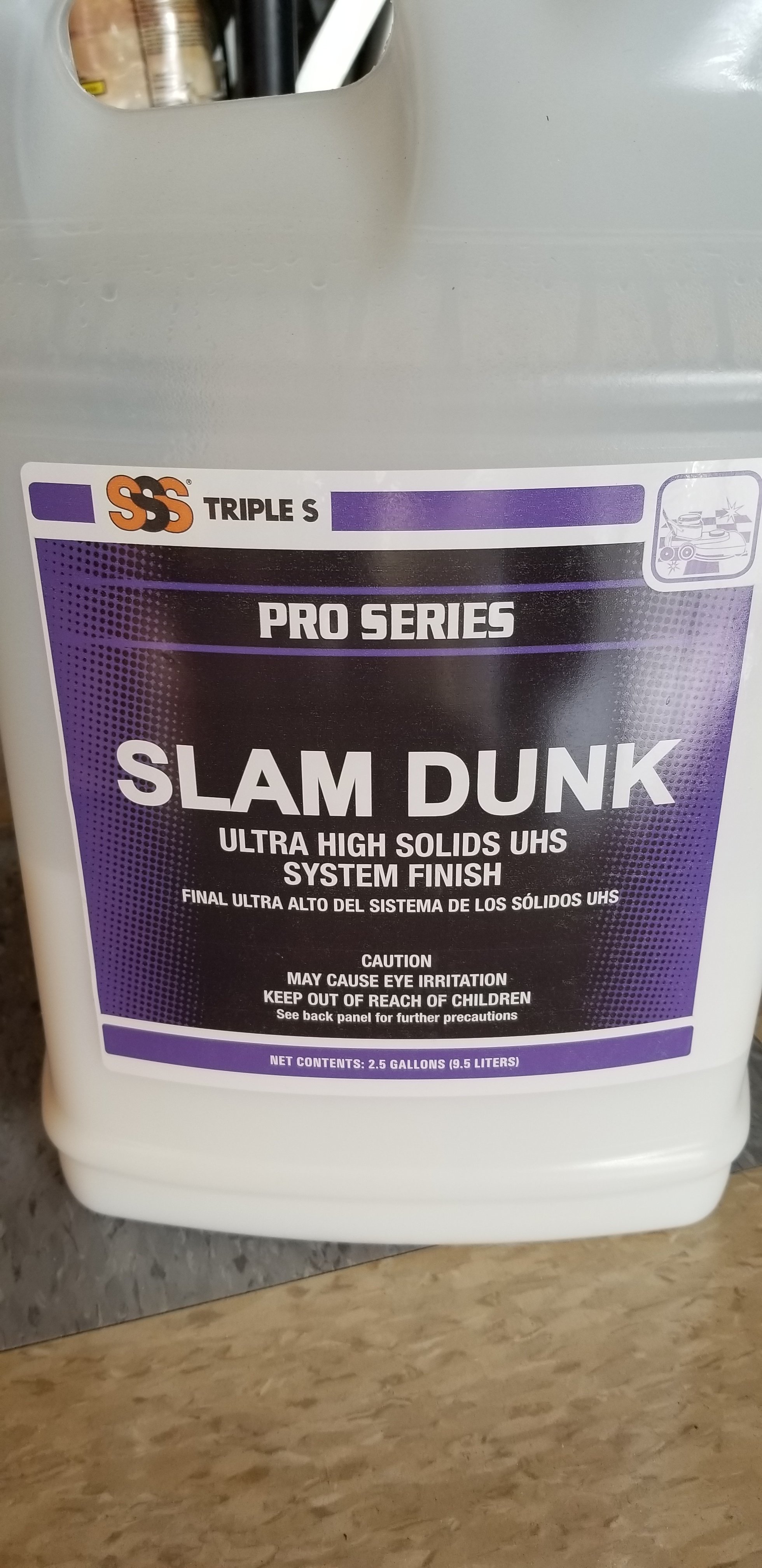

This is the finish i ended up picking up from my local supply house

You will have a line where the two halves meet. To to make the line fall between tiles rather than in the middle of one tile, and you will have a pretty good result. Maybe some painters tape to make the line straight.

I thought for sure i was gonna eat off of it myself, after all the time it took from start to final finish and putting everything back. Some people werent as happy on a Saturday..😂
It just never seems to amaze as to not having flying bugs until your applying finish to something..
I I I did have some tweezers handy for between every coat.

Andy,
You were right on the money with saying that the Pneumatic tires will leave Yellowish/ brown stains.. I had that happen with a 4 wheel cart, however only the cart and not anything thing else which is weird prior to finishing, but i replaced them... i talked to the saleshole and was told that i shouldn't experience that after the finish is applied.... i do have that cart resting on a cpl scrap pieces of carpet at moment, until my shed arrives
