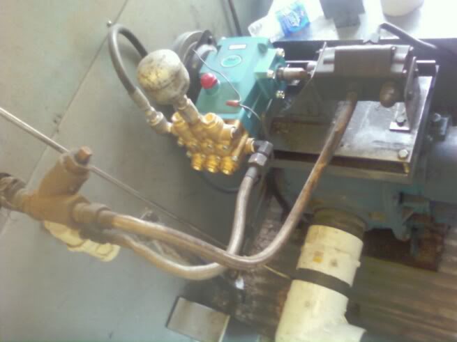

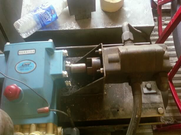

Okay. Got engine in truck. Here's some pics. I need to know what my steps are to get this Xentherm system operational?

at a glance..........you are missing the other end of the love joy coupling ...(and the spider insert ) off the cat pump to the Xentherm pump....and looks like you will need to replace or rebuild the pump.....that thing don't look like it has turned in quite awhile....have no clue what the bottom picture is

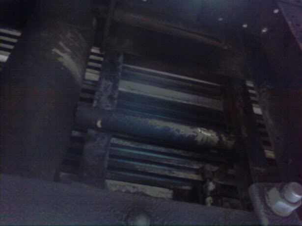

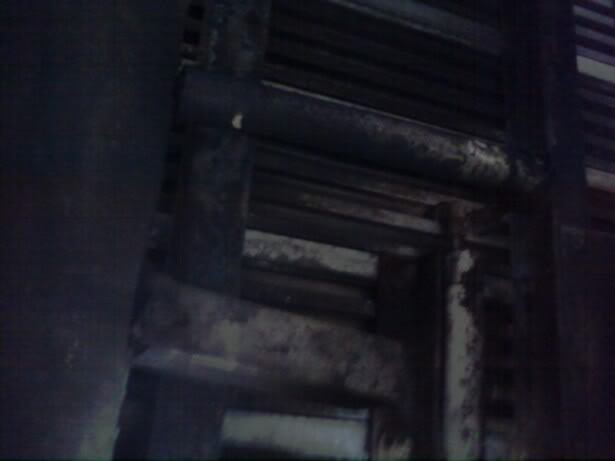

well the pump hasnt turned in a while but it turns pretty freely (i think) with my fingers. the other pics are from the bottom of the truck looking in.

then start by putting the coupling back together between the cat and the oil pump and fire it up....cant really tell nothing else till then..............make sure they are lined up real good..or it will chew the spider all to hell.......

Motion industry will have the love joy parts you need. Do you now if the E3 exchanger under the truck has been replaced before?
I would bang my fist on it an see if anything sounds loose in there, she may be rotted out like mine was.
Do a air pressure test on the E3 by removing both lines and see if she holds pressure. If air and rust dust blow out the exhaust side she is toast.
Your pump may be fine but don't run it long with out oil running threw it.
These older trucks were disabled of zen heat after the E3 went south, that is why all the couplers are removed. Mine did not have a coupler and the Exhaust Diverter was stuck. Which can be repaired
