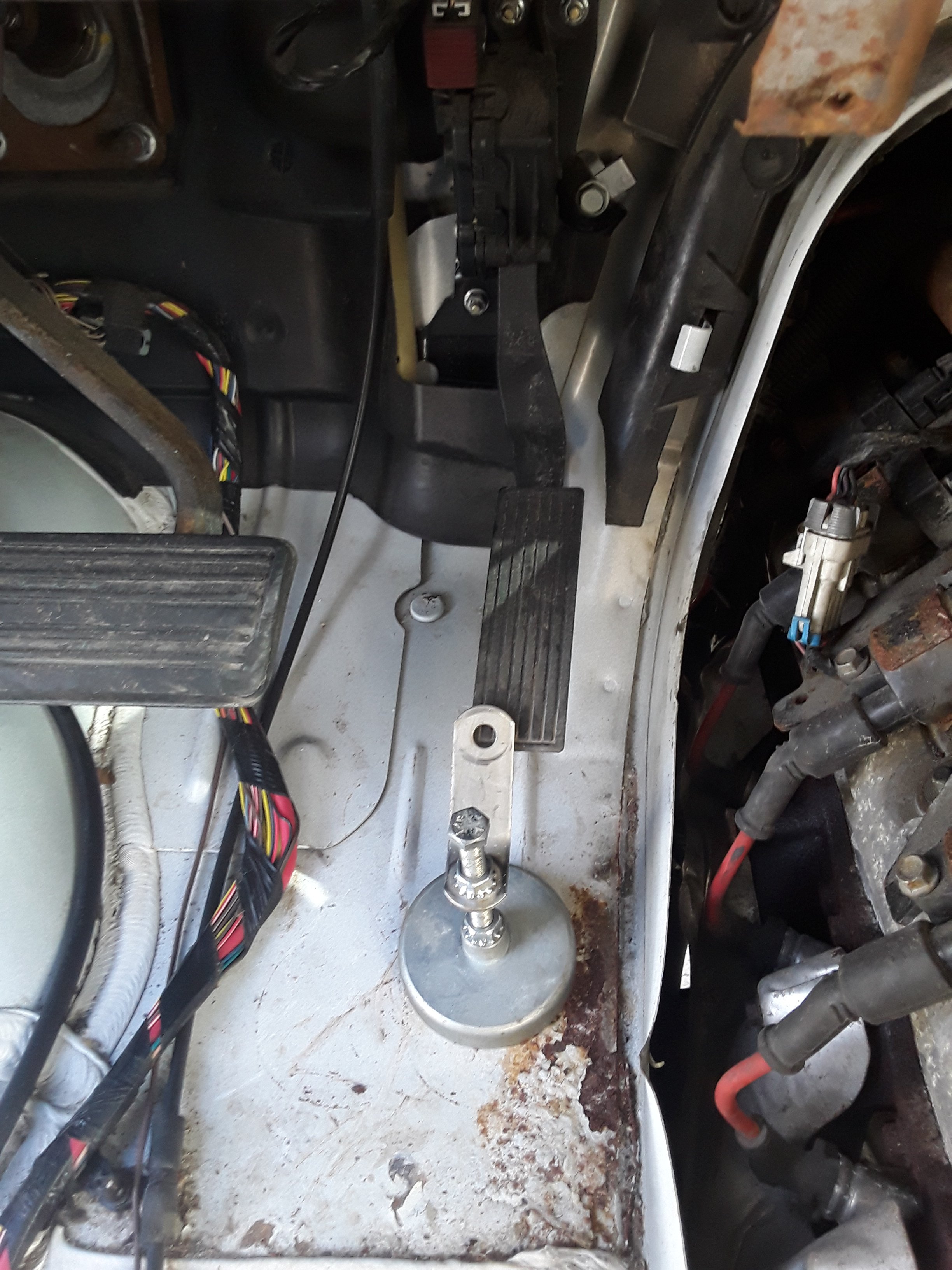

10 bucks says this fellow is from the south... Or he learned this trick from a southerner.
Brilliant, absolutely brilliant!
It's a magnet, right?

Southwestern Ontario actually, I put a tiny tach on a sparkplug wire and set the proper rims, Mark the spot that the magnet sits for precise startup.
This is on UncaErnie the Steam Genie. Works great

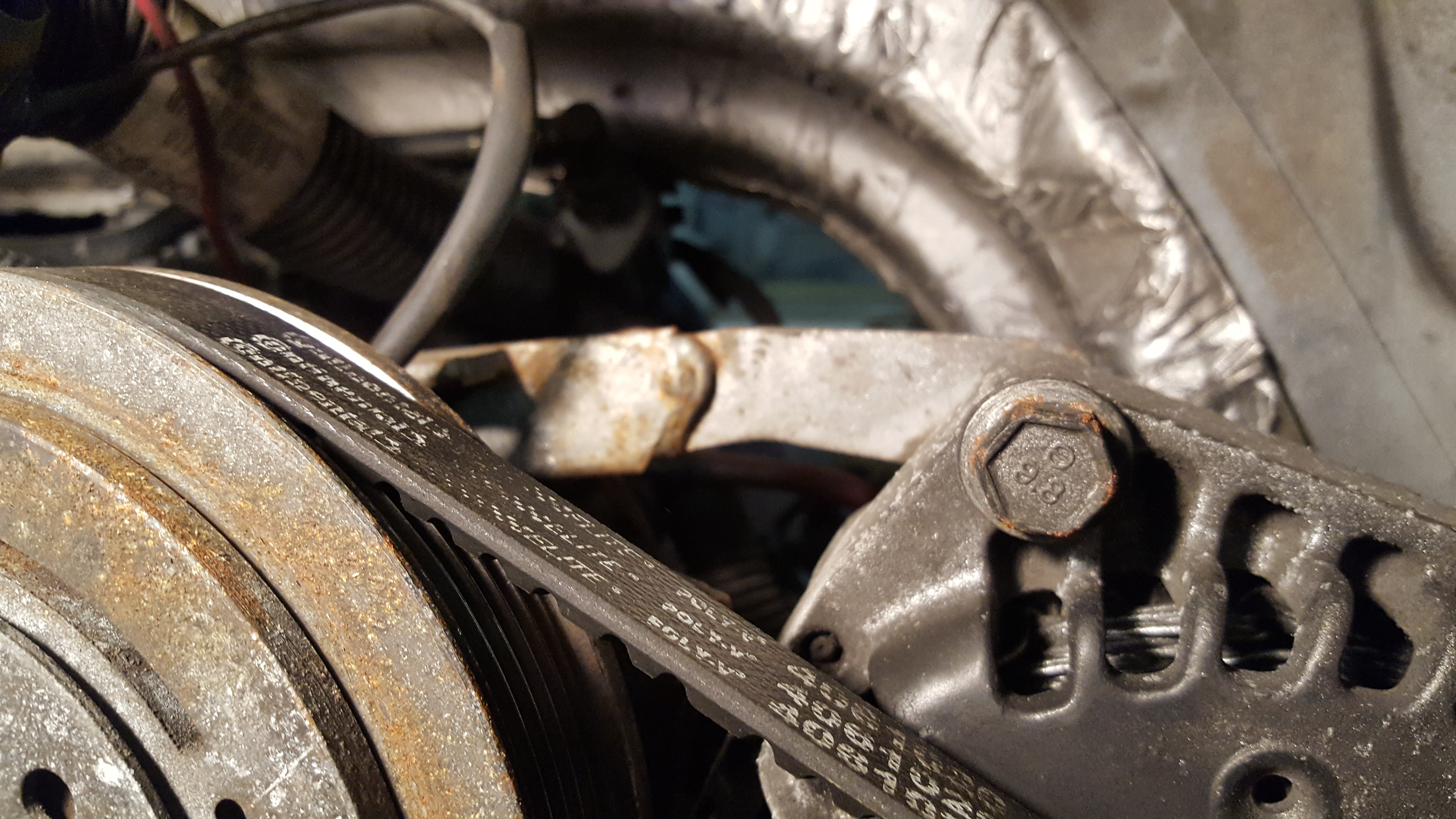

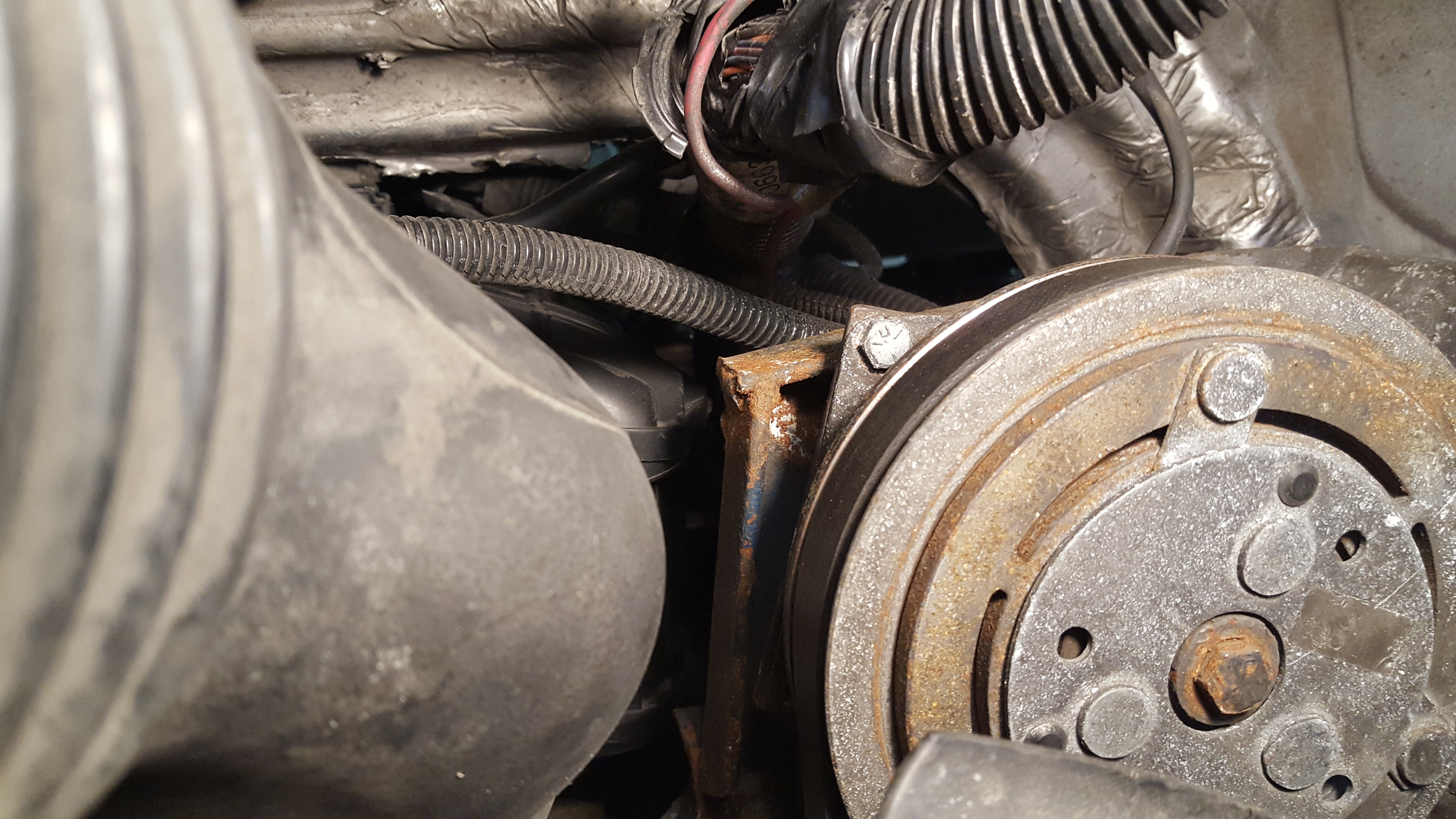

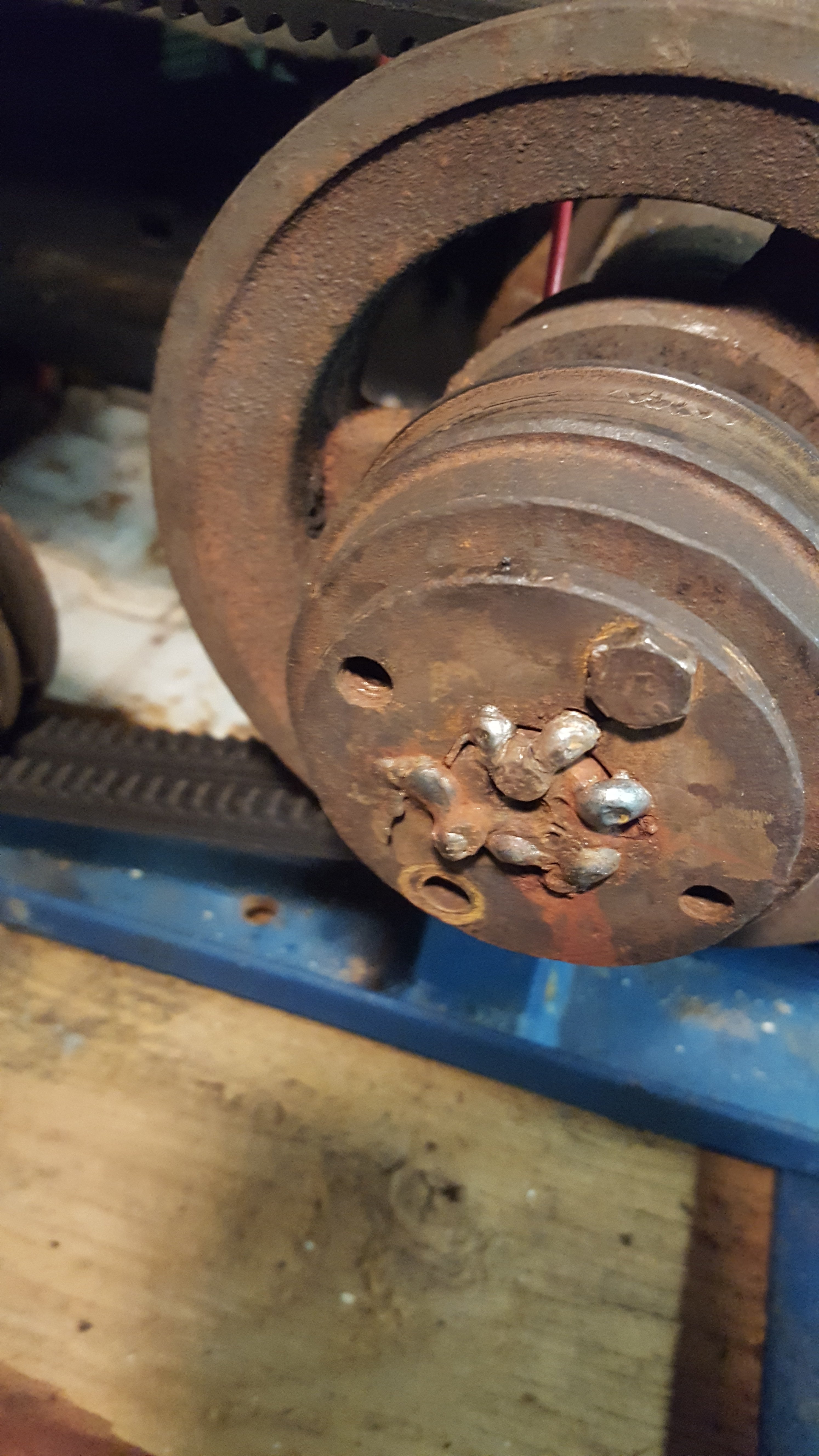

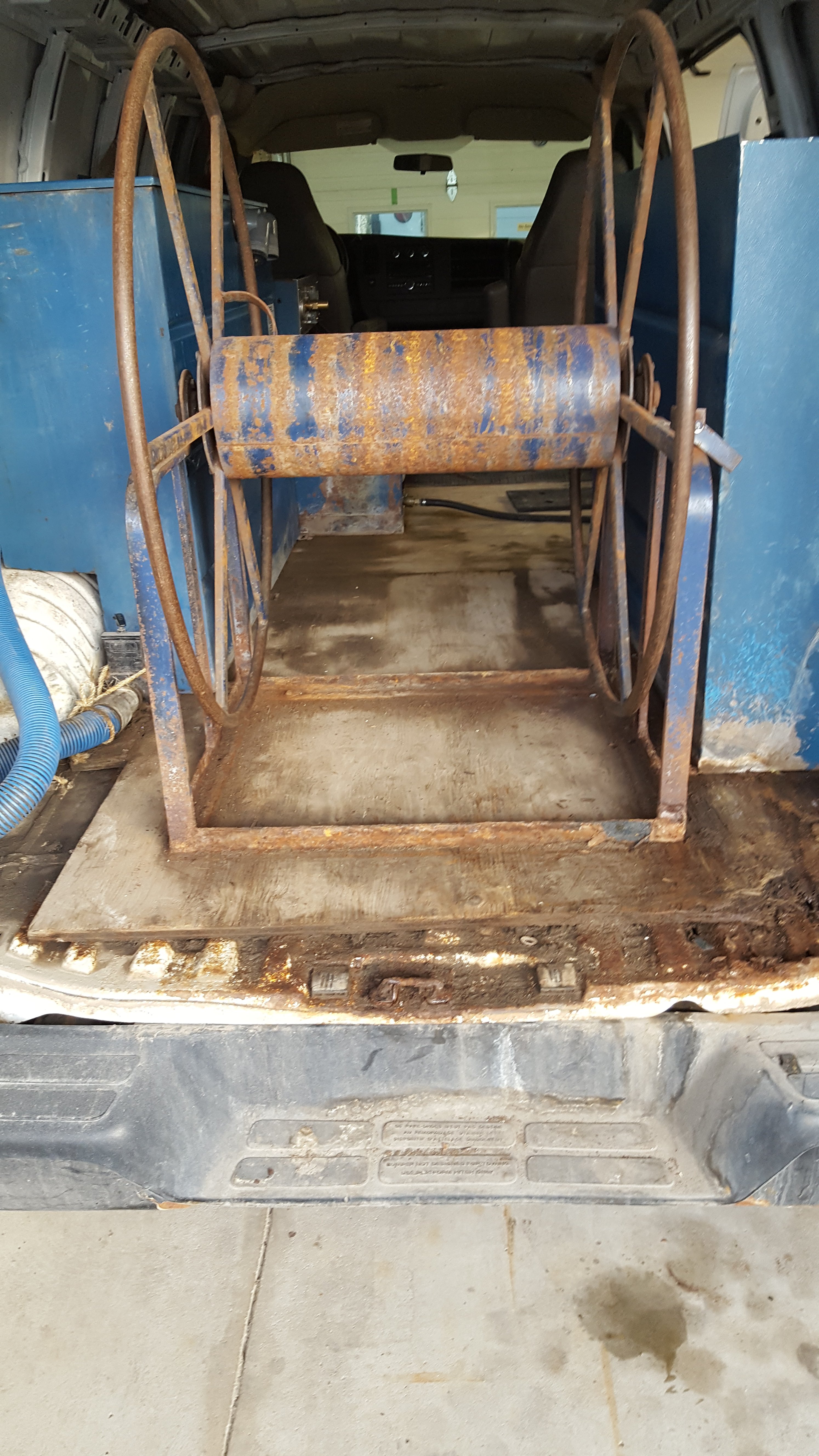

UncaErnie was 78 years old when I bought this van from him via his nephew. It would take quite a few years of no maintenance to achieve the results of this unit.
He had the install done in Ohio somewhere, I'm sure a local yokel could have done better.

You'd be surprised how many people would use a puller to remove that pulley

Did you notice the custom made bracket for the clutch/alternator? Hand made by cutting out metal from the unit cage.
The drive shaft seems to work fine, but I will pull it out anyways for bearing replacement prior to reassembly.
Bawb's input is more than welcome, being the resident Genie guru.

Rob...see those two holes wit the threads in em......get two grade 8 bolts of same thread...and run them down till they stop. .then a quarter turn on each till it jus pops off....
NO PULLERS
How many years was it on the bottom of the sea?
