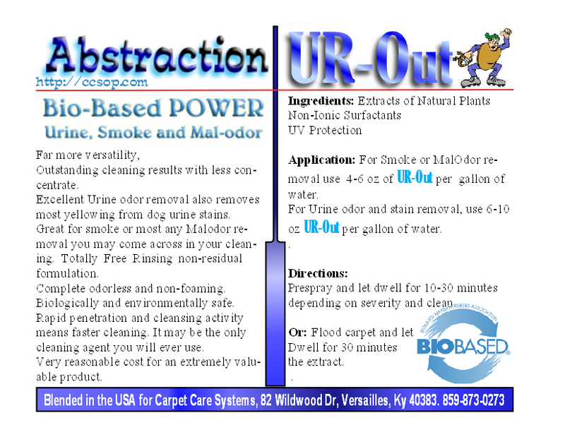

i don't claim to effectively remove feline urine contamination...so JB's method works for me.
but i will do canine urine contamination, and the only product i like is UR Out from CCS...http://store.ccsop.com/catalog/prod...id=49&osCsid=883e8fbaa41abbf3855250c6d959fa0c
granted i havent tried but only a few of the other products on the market for canine urine contamination. but UR Out is "Bio-Based" and works fantastic for me...and it is priced very reasonably & cleans carpet very well, as a side bonus. dwell time is the key.
