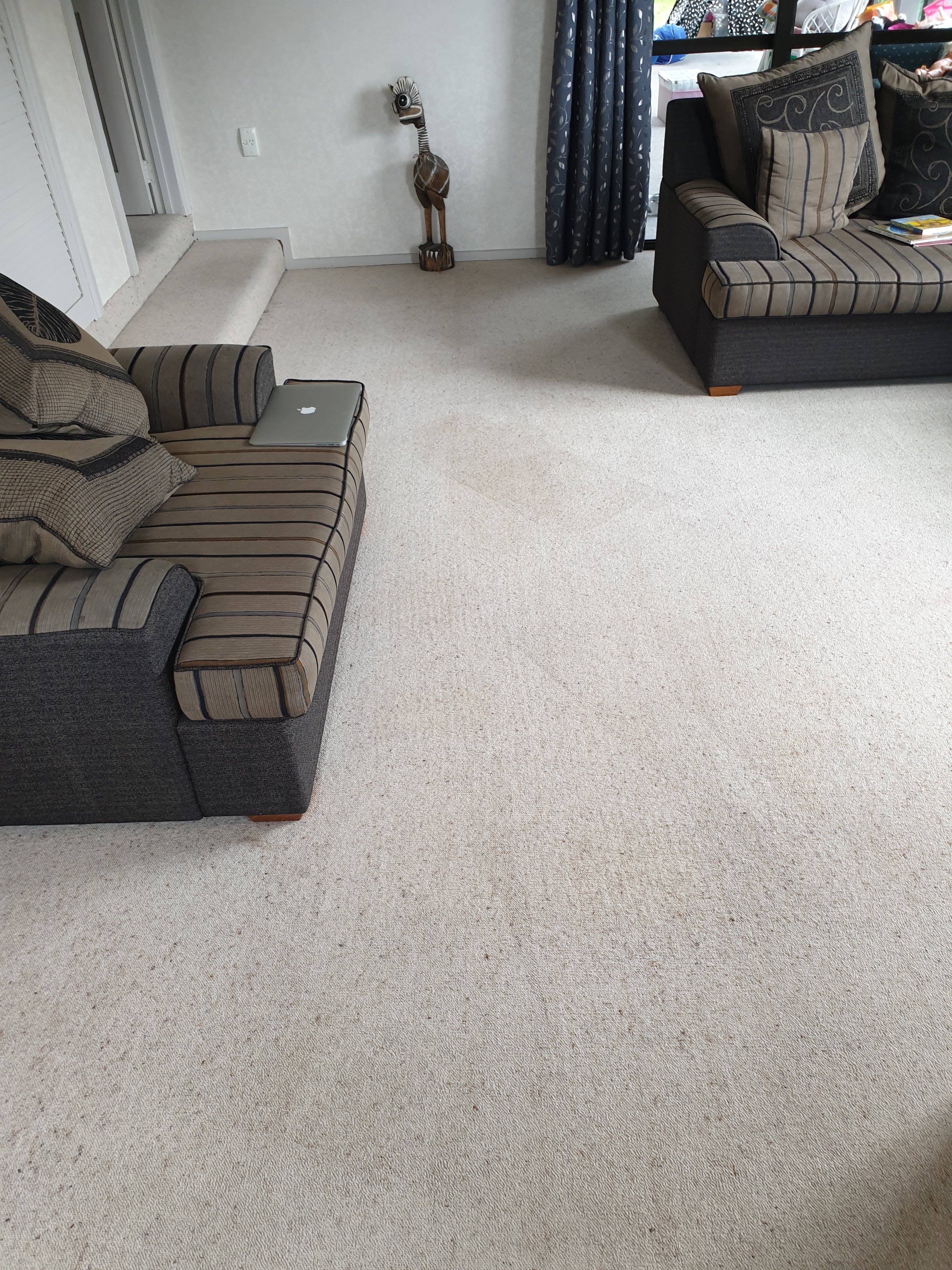

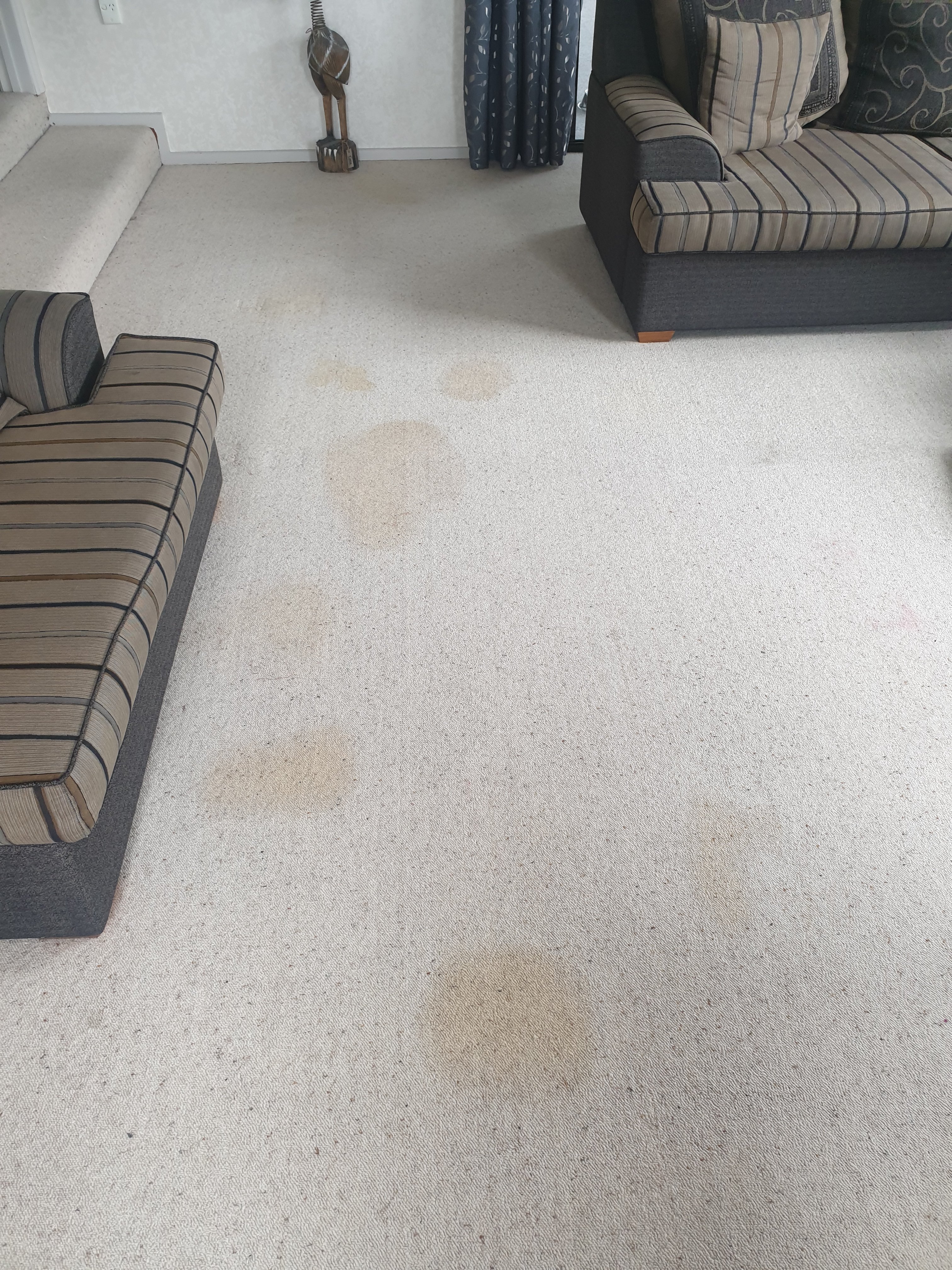

2 jobs today, both houselots of wool, both pretty much like this.. 20191118_104920.jpg
and I run out of peroxide arrgh! 😡
