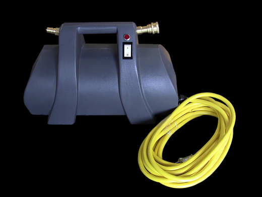

I have one of these but a dual corded unit at 220 degree thermostats 3250 watts 15 and 13 amps. The standard thermostat is 190 but I set mine up.

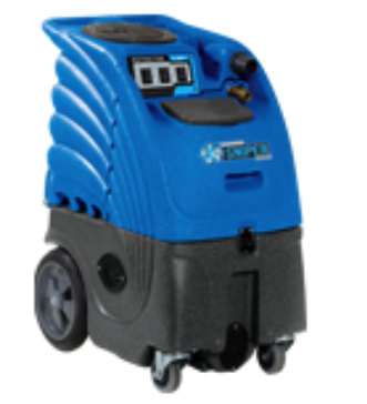

The Sandia 6-Gallon unit would be perfect for what you're describing. Heated, 100 PSI, Single 3-Stage Motor, 1 Cord. Sandia extractors are rock solid dependable. And they're easy to open up and work on if you ever need to service anything.
Let me know if you're interested. I'll be happy to order one in for you at a very good price.
