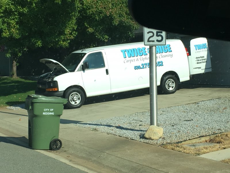

One of the local guys here in Redding has a Pro1200. I see him cleaning with his hood up. I'm hearing that this is the thing to do with these mounts. Beautiful machine.

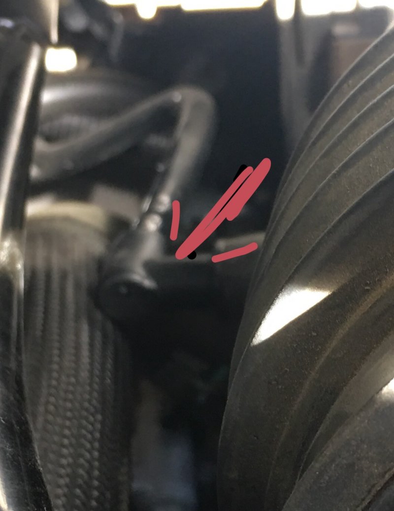

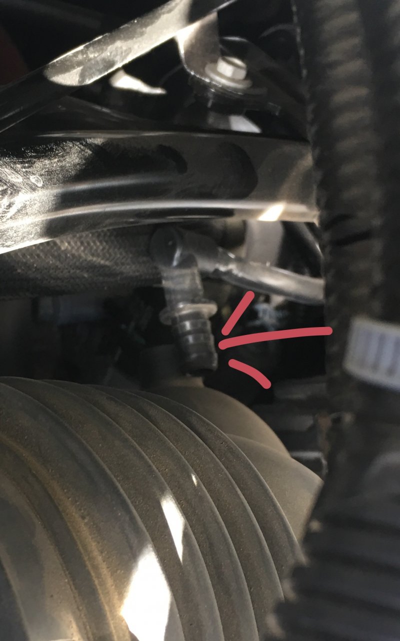

Not sure if this would cause it because like I said it clears when I drive for the most part and happens when the truckmount is running.
Pretty sure this isn't right though
looks like a vent tube or a vacuum line. If its a vacuum line, it can mess everything up while it's off. Very simple fix but annoying to figure out if you don't know it's the issue.

Ok so the light was on when I found the vacuum tube off,
Stayed on until the next morning as I went to a huge job, van ran for 5 hours and the light stayed off.
Gotta guess when the guy who put in a new serpinetine belt that was precautionary warranty work for free by sapphire he pulled all the air stuff off to get at the belt.
He probably just didn't reattach that one.
Here's praying that's all it is on my new van.
