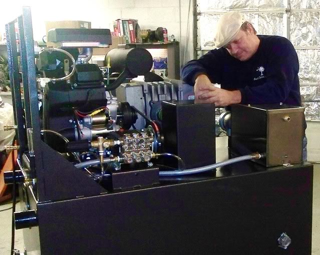

I remember Judson's being pretty common twenty five years ago. What happened that they "went away" for so long, other than the private label Sunbelt Steamex machines?
I have one, is it a collectors item? Can I get paid?
