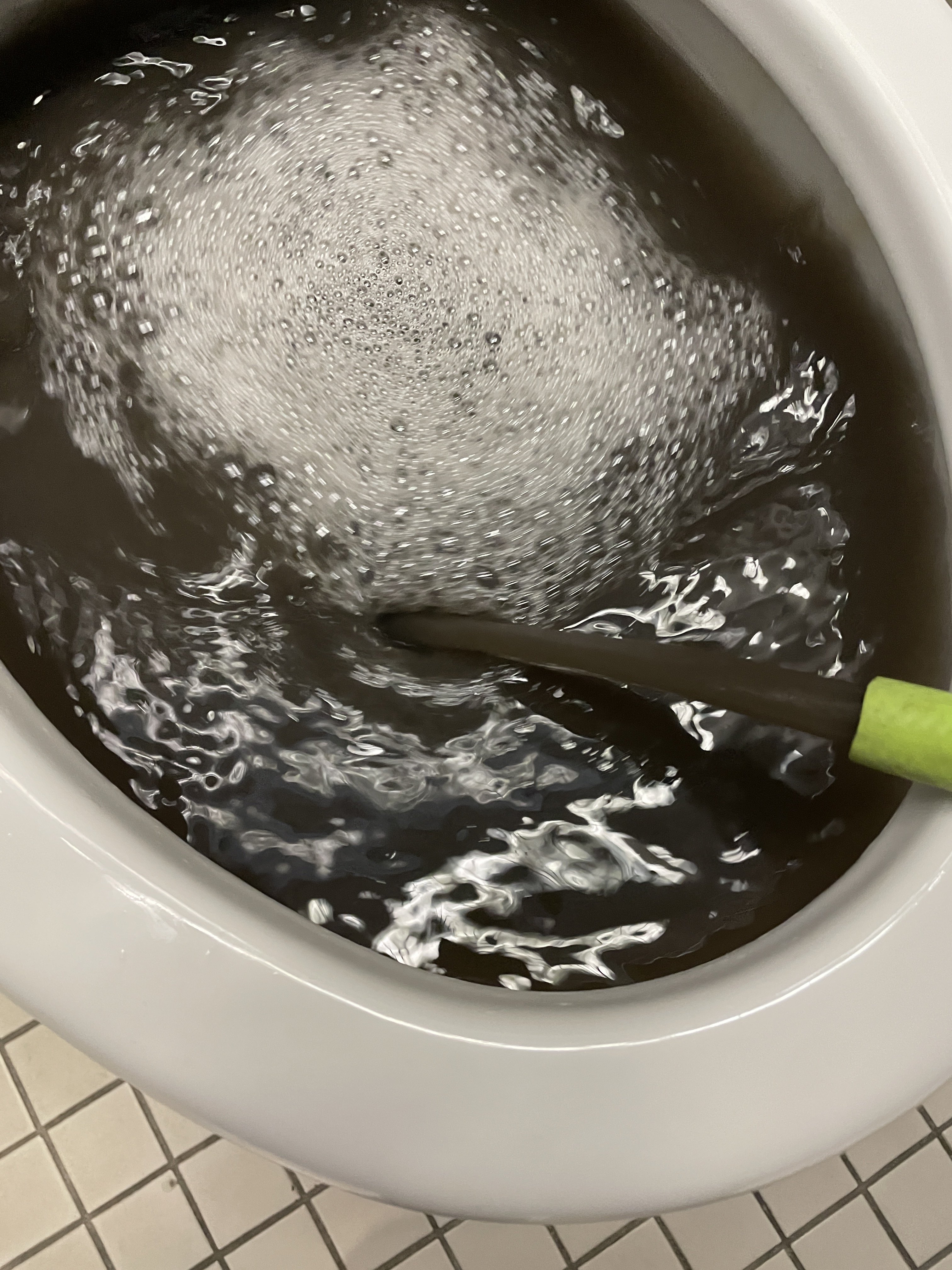

Got a call to immediatly clean up Goose crap that got tracked into a house on a Sunday. A self claimed very important person demanded I get there or he will call someone else. He told me it is an "easy" job, and "not that bad". So I jumped on it.
He lied.

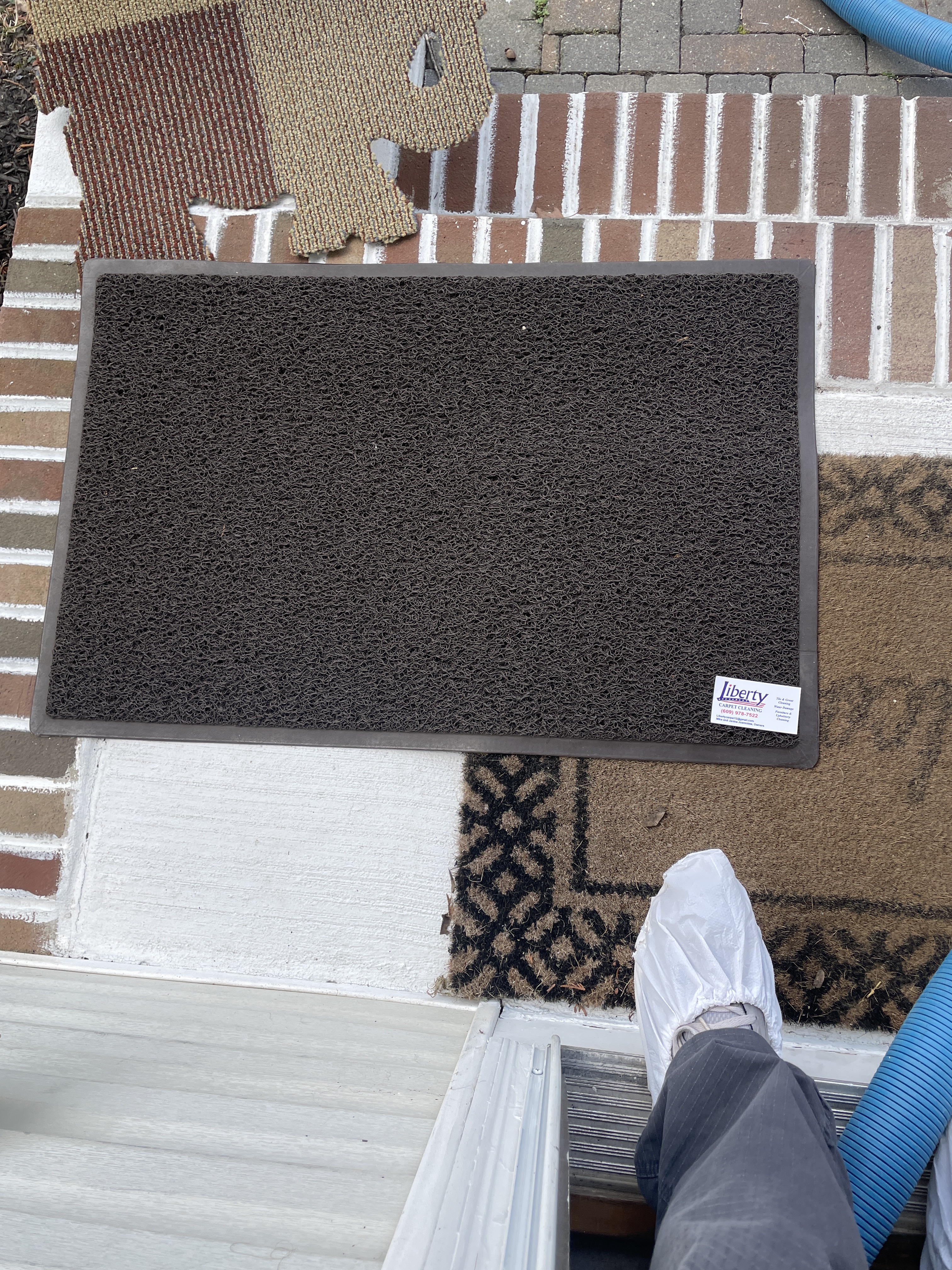

Now heres the kicker. Today at a job for a customer of 15 years at least. Awesome customer. Last busy season I was booked pretty far out and just couldnt fit anyone in. This year, i got the call, and she had a welcome mat that was upsold by a franchise. There was a issue with her sick dog that put the rush on, and I couldnt fill the order. So thankfully I didnt lose her. I gave her some $ back because it was too much of a tip. She works, single mom, 3 kids in college, tough funny lady. This is just confirming not to just say "sorry, cant get there for 2 months" Which is what I have said, not quoting anyone here or implying that. Im just sharing events here. I never paid attention to business trends, but thankfully some people have and shared it with me. Im trying to figure this out.
